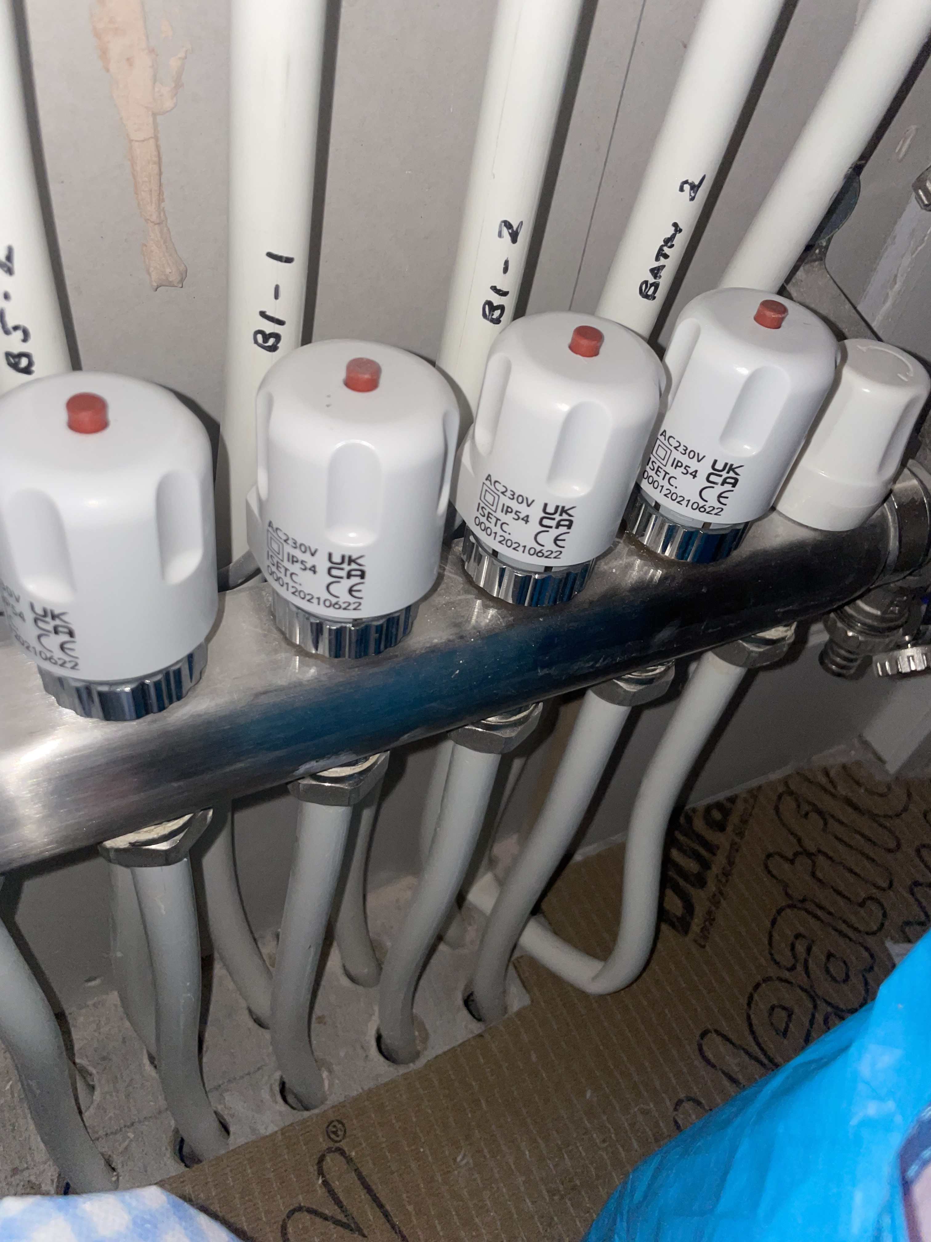

richo106 Posted November 19, 2024 Author Share Posted November 19, 2024 I have the Panasonic aquarea 12kW but not running it on weather compensation. However I’ve been looking into it tonight as our upstairs is not warming up properly and think there may be an issue with the upstairs manifold/actuators etc The downstairs manifold flow temp in is 30 deg and the temp out is around 23 deg and can feel the pipes slightly warm as expected However the upstairs manifold the in flow temp is 26 deg and the out flow temp is also 26 deg I have attached a pic of my actuators upstairs ( they are different to downstairs) the thermostats click in and out as they should but the actuators don’t seem to change any advice or anything to check would be very much appreciated. This is my first time with ASHP , UFH so any suggestions as simple as possible are welcome Link to comment Share on other sites More sharing options...

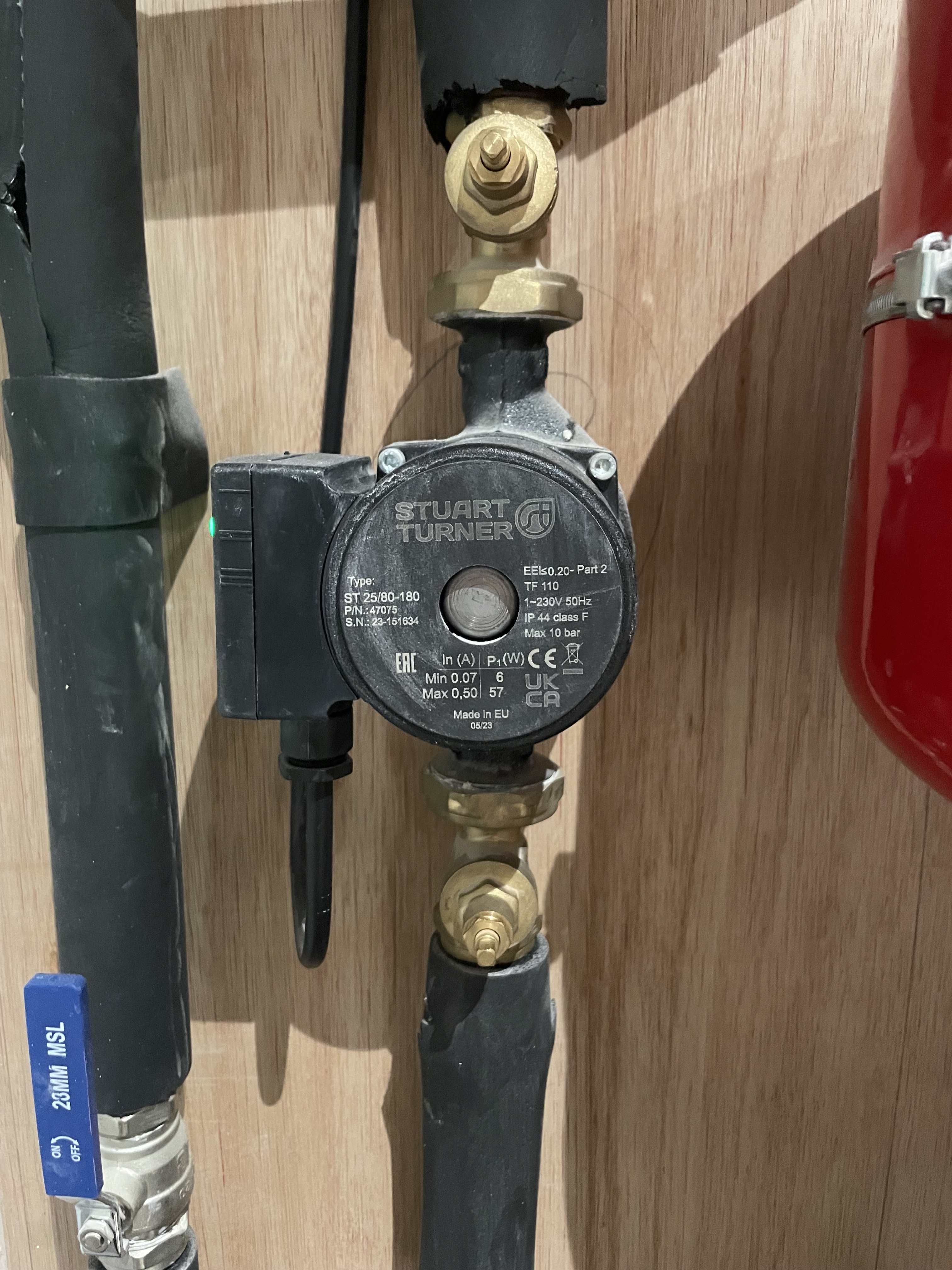

richo106 Posted November 19, 2024 Author Share Posted November 19, 2024 Just to add I have one pump that pumps water to both the Upstairs and Downstairs manifolds, when a zone calls for heat the pump kicks in. Link to comment Share on other sites More sharing options...

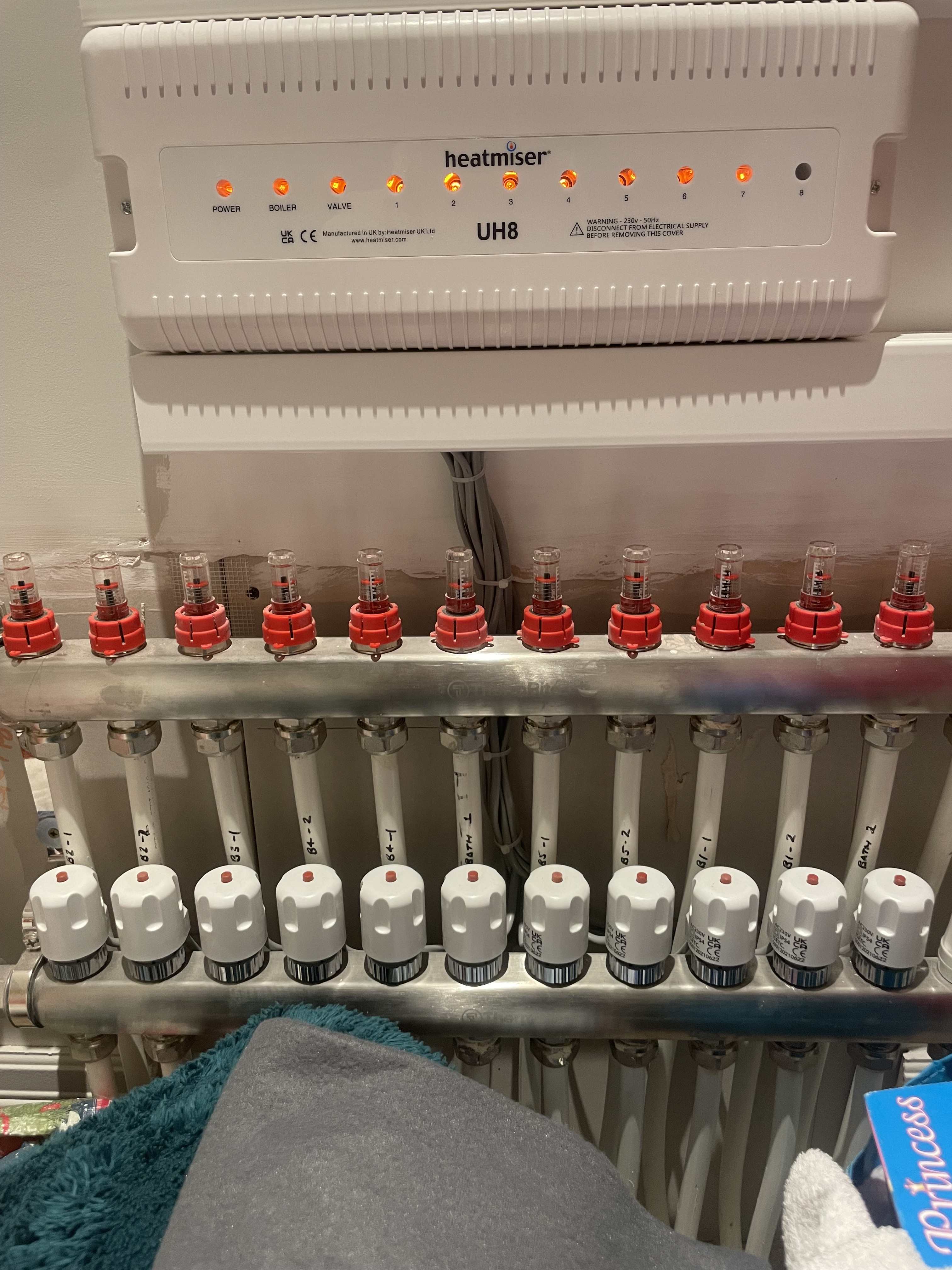

richo106 Posted November 19, 2024 Author Share Posted November 19, 2024 Sorry for the message spam but just thought I would add another picture showing that it does indicate flow on the valves I have just looked at it again before bed and now the flow and return is both 30 deg so still no difference between them Link to comment Share on other sites More sharing options...
Gary68 Posted November 22, 2024 Share Posted November 22, 2024 If you unscrew all of the actuators I believe that should open all the circuits as the actuators hold them closed so if the actuators aren't wired in correctly or they fail, then they will just stay closed. Link to comment Share on other sites More sharing options...
richo106 Posted November 22, 2024 Author Share Posted November 22, 2024 5 minutes ago, Gary68 said: If you unscrew all of the actuators I believe that should open all the circuits as the actuators hold them closed so if the actuators aren't wired in correctly or they fail, then they will just stay closed. Thank you @Gary68 I have confirmed all my actuators are working as they should. Link to comment Share on other sites More sharing options...
