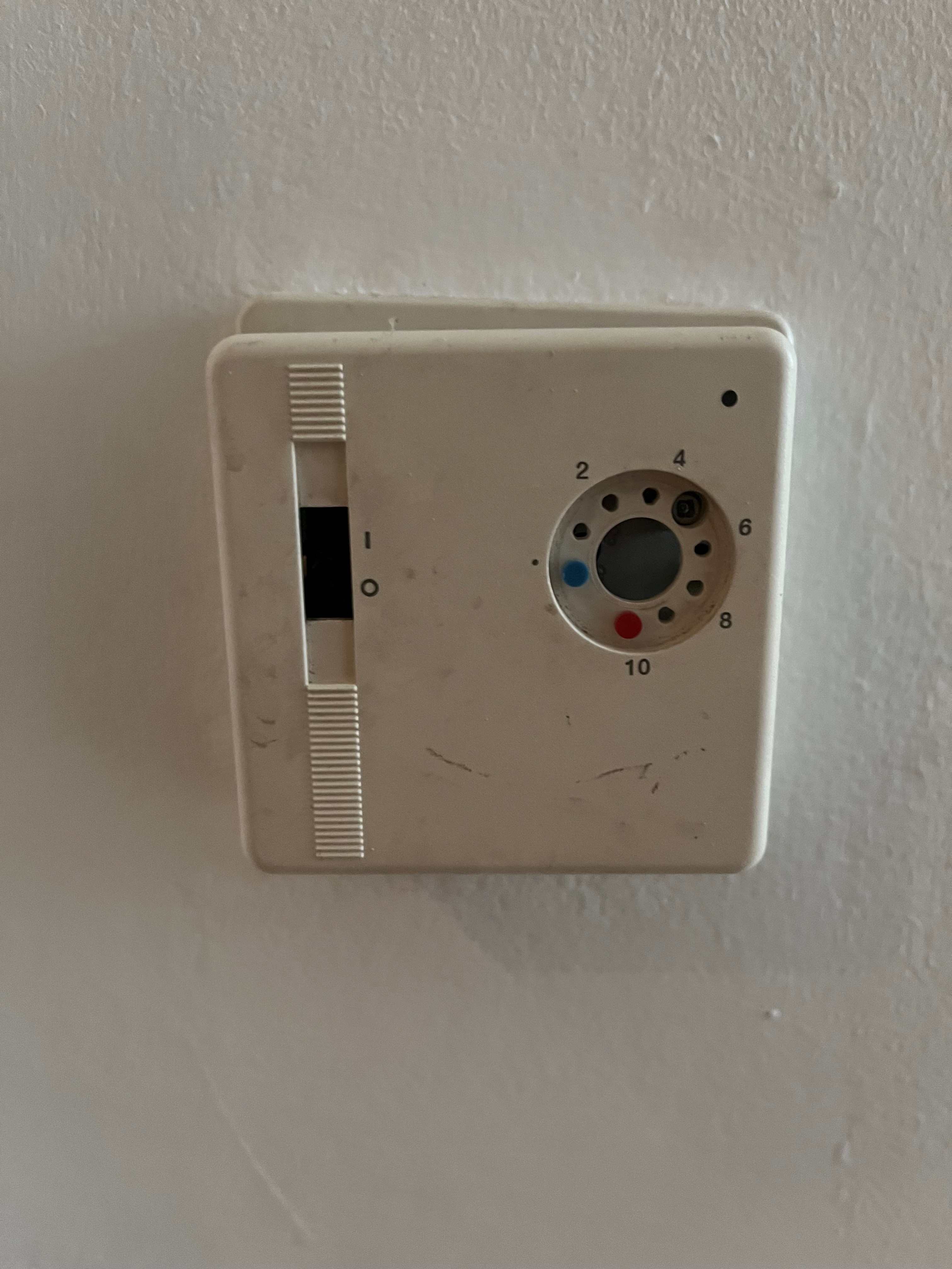

Anyone seen this old electric UFH controller before?
This needs replacing. Curiously is doesn't appear to use a thermistor for floor temperature sensing. Anyone seen that before - I haven't? The floor must be self-regulating temperature-wise?

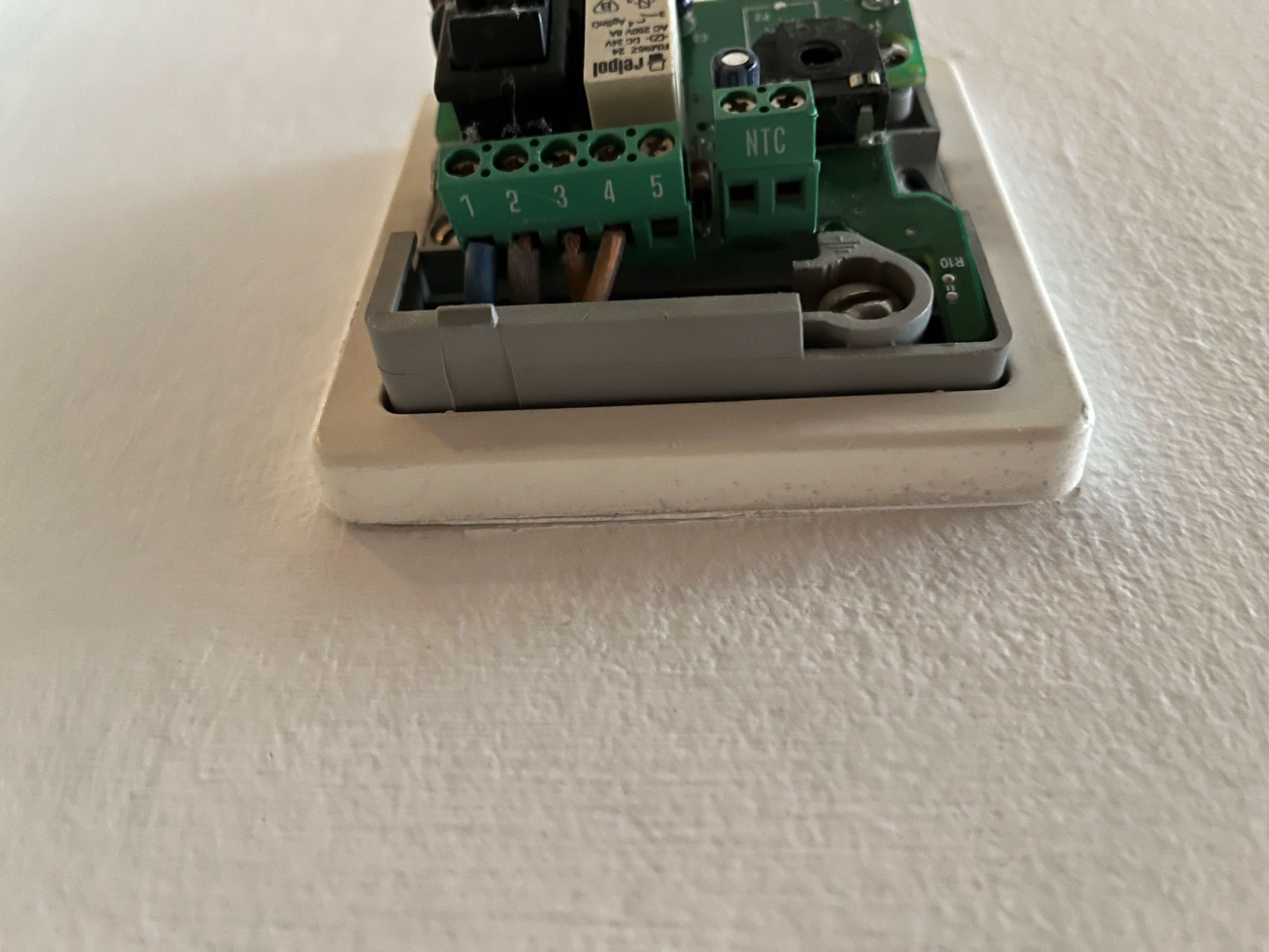

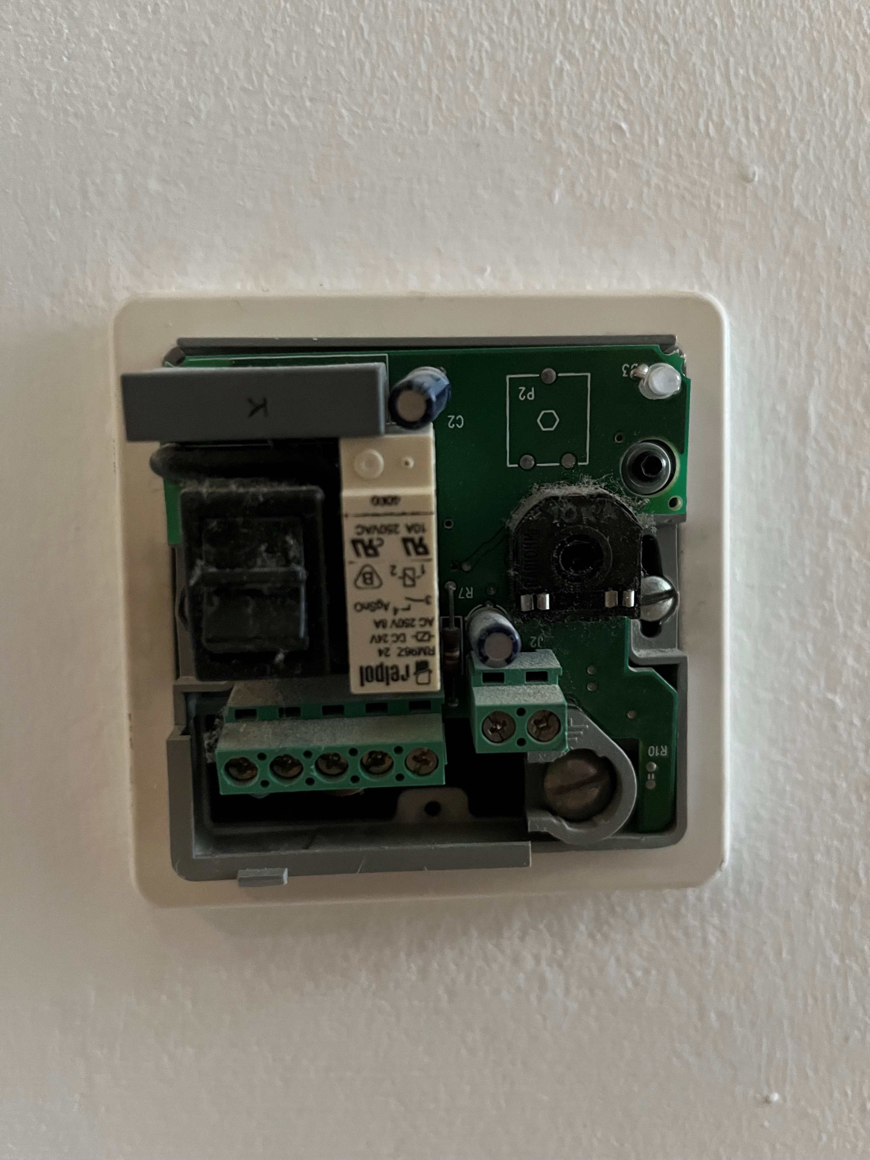

Can you remove the front and post any pictures of the inside in particular the connections?
If they don't use a floor probe they usually just work on a room thermostat, is that what the (remains of) the round dial was?

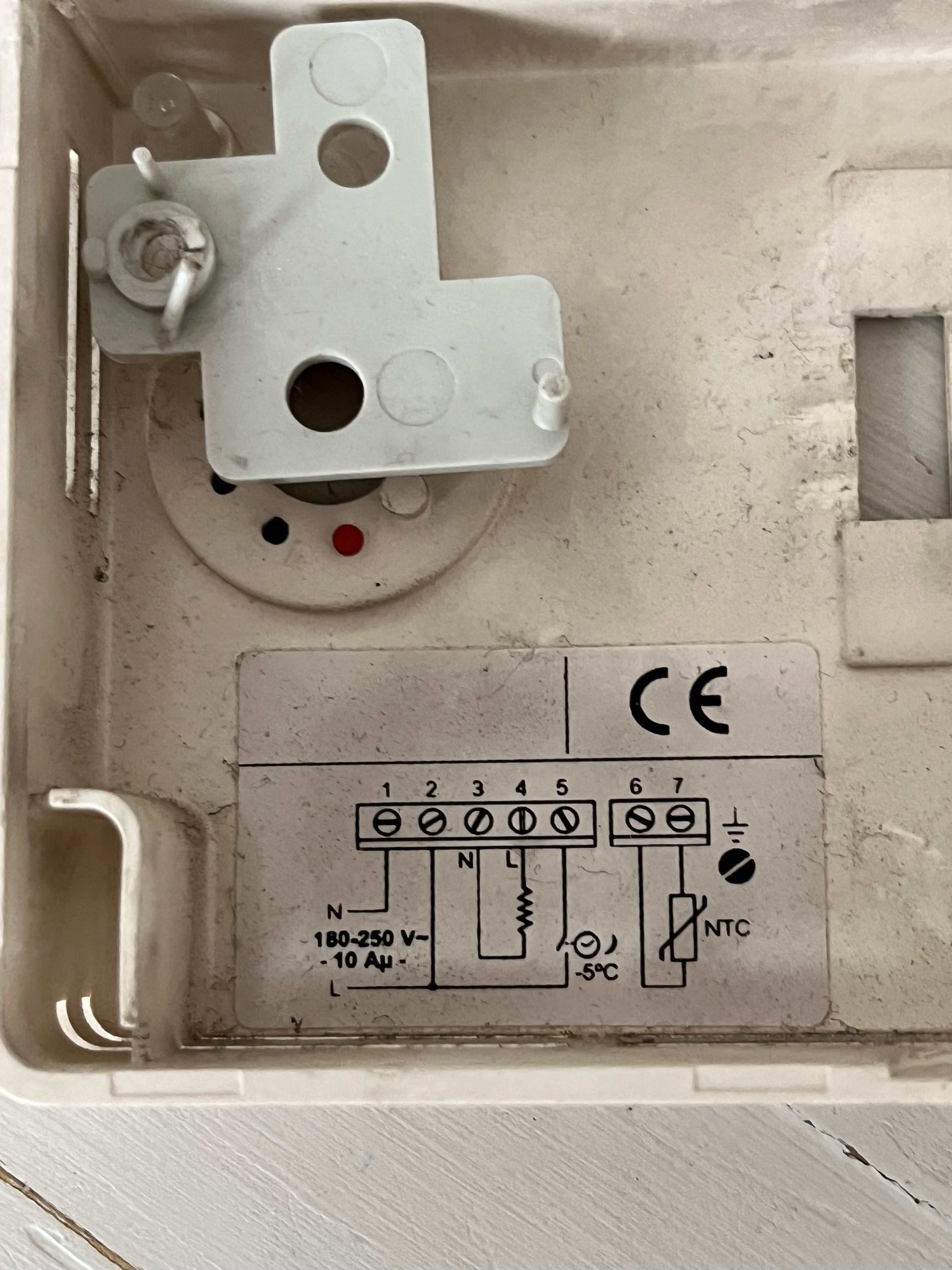

Yep, of course. BTW it does seem to work OK but the cover is a bit broken. Seems there an NTC connection available but not connected.

Oh yeah, thought it was a timer, but the blue and red pips suggest temperature and it must have rotated the little 10K pot underneath.
