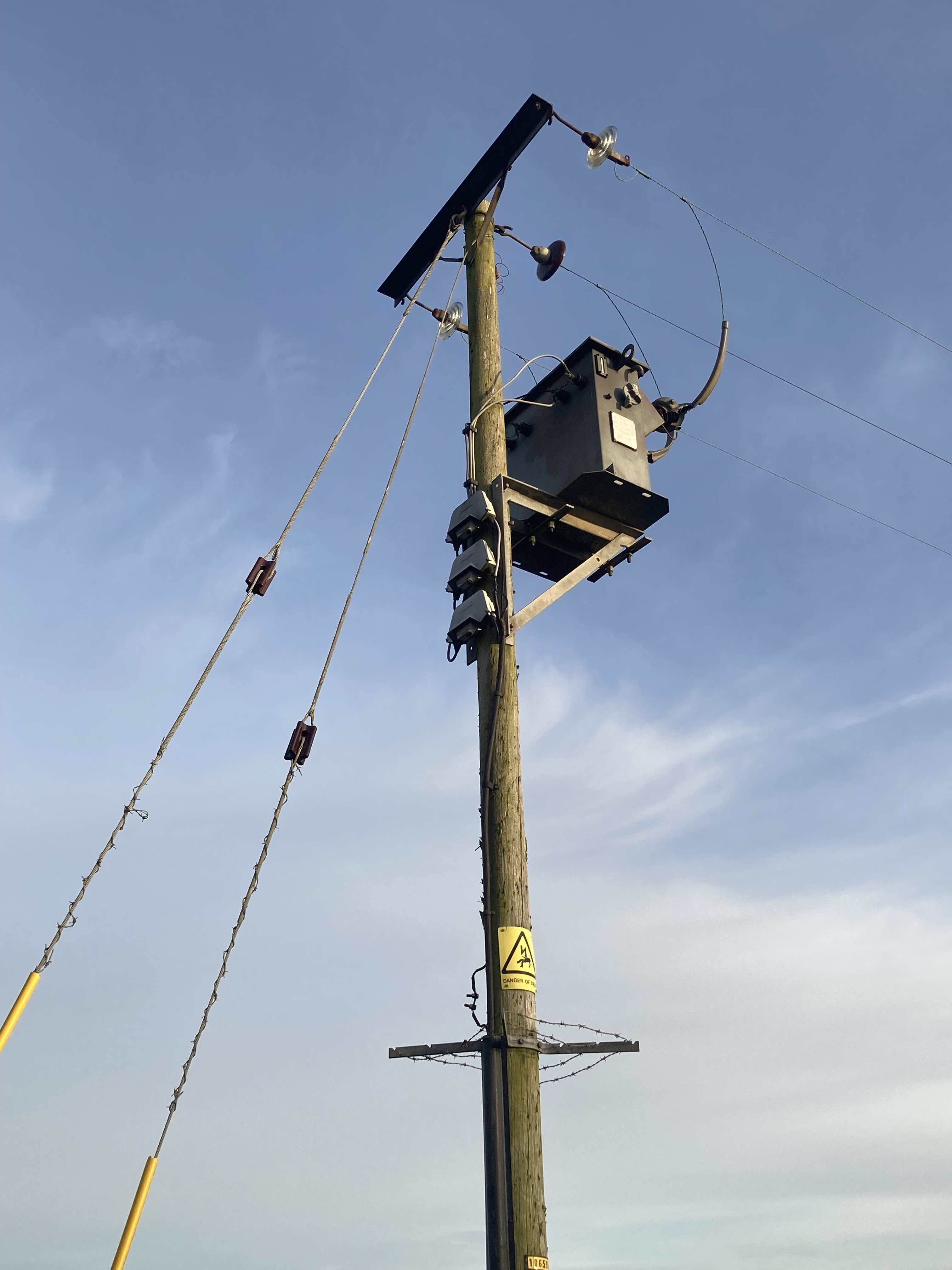

richard_scotland Posted November 12, 2024 Author Share Posted November 12, 2024 thanks all for the responses and @frankmcs65 for the interesting ideas. Wondering about an alternative approach. The electric pole which is 5 m away from the house has 3 phases to it and a transformer on it. Our single phase supply is limited to 60A (due to size of cable apparently) and the cable goes under the slab to the middle of the house (the house was renovated in the early 90s). The fact we have a 12 kW heat pump, a car charger, induction hob + oven and everything else all on this 60A supply already makes me a bit nervous. We will likely go from one to two EV cars within a year or so, so the charger will get used several nights per week. Is there any merit in seeing how much it might be to have 3 phase installed to a new external meter box? as the pole is so close you hope the cost might not be too terrible... This might mean any new meter works as a smart meter, as its no longer surrounded by thick solid walls, allowing us to access TOU tariffs. From there we could connect up to the existing consumer boards internally? It used to be two cottages, so there are already two consumer boards, they could have a phase each and then the EV charger could be on its own phase? And doing this I would automatically get all the the extra PV export capacity I could want or use. An additional factor is that its reasonably likely we would want to build an accommodation annex in our garden at some point in the next few years - one of our children is disabled and has complex needs so ideally we will like to have additional accommodation for carers or helpers on site. That would be an additional load on our electric supply (heating, hot water, some basic cooking facilities etc) - so this might be another aspect pushing me towards looking into 3PH Obviously how sensible this is depends on how much the 3PH upgrade might be and if any of the above plan actually makes sense! Link to comment Share on other sites More sharing options...
Dillsue Posted November 13, 2024 Share Posted November 13, 2024 (edited) There's no harm in asking for costs to upgrade either to 3 phase or 100A single phase, if that would work. Has your transformer got 3 phase coming to it? Ours only has 2 phases at 11kv so if we wanted 3 phase there'd be quite a bit of work adding the third phase Maybe worth checking that all the wiring from each consumer unit is separate from the other if you're going to put them on separate phases......you don't want any connections with 400volt in the house! Edited November 13, 2024 by Dillsue Link to comment Share on other sites More sharing options...
richard_scotland Posted November 13, 2024 Author Share Posted November 13, 2024 This is the pole nearest to the house - it serves 4 properties. Link to comment Share on other sites More sharing options...
Dillsue Posted November 13, 2024 Share Posted November 13, 2024 That's a 3 phase HV supply so you've got a 3 phase transformer....you can see the 3 isolation switches on the pole below the transformer. Shouldn't be crazy expensive to give you a 3 phase supply if you wanted, but.. With the electrification of the country there's going to be lots of distribution upgrades required and if the transformers been there a while it may not be up to supplying 4 houses with EVs, HPs etc. . If that's the case your DNO may upgrade it for free and give you a 100A supply. When we asked to double our PV export our DNO found our transformer wasn't adequate for a modern supply and replaced it free of charge together with refurbishment of all the poles and cabling around us. If you initiate an enquiry and request a supply upgrade/ PV export you may find the same principle applies, particularly if the transformer is old and rated for electric demand from decades ago. If any of your neighbours are planning increasing demand then share that with your DNO 1 Link to comment Share on other sites More sharing options...

richard_scotland Posted December 2, 2024 Author Share Posted December 2, 2024 The DNO go back to me with an estimate for 3-phase to the house. Its £4500+VAT. It includes a £1250 design fee (?) for upgrading the transformer to 3-phase, the actual upgrade cost would be covered under SCR. It doesn't include excavations on our land (a 10 m long trench). More than I was expecting, and makes it hard to justify as a route to add more PV or some more batteries. Our existing supply is 60A, so will explore if there is scope to up that to give us a bit more headroom (I seem to remember being told there wasn't, but I will ask again), and see if there are any other options. But even if they gave us 100A, I am not sure there would be much scope for adding batteries to shift some of our load onto cheaper rates, as I feel we are already pushing the limits (its not uncommon for there to be a 15kW load at 3am if the car is charging and the heat pump is doing hot water, or its a a cold night). This house was fairly recently (in the 90s) two cottages, and one cottage still has the old supply in situ, and it was working when we moved here. I don't know if there would be any way of utilising that, without having to pay two sets of standing charges? A very rough calculation would be that if we had a substantial battery (say 20kw) and did all the car charging and DHW heating overnight or at cheaper periods, we could shift maybe 10,000 kWh of our annual load to a cheaper rate, so the bill savings might be in the region of £1300-500 a year. But we might have to spend £10k to be able to do that. Link to comment Share on other sites More sharing options...

Dillsue Posted December 3, 2024 Share Posted December 3, 2024 16 hours ago, richard_scotland said: The DNO go back to me with an estimate for 3-phase to the house. Its £4500+VAT. It includes a £1250 design fee (?) for upgrading the transformer to 3-phase, the actual upgrade cost would be covered under SCR. It doesn't include excavations on our land (a 10 m long trench). Your transformer is already 3 phase???? Link to comment Share on other sites More sharing options...
richard_scotland Posted December 3, 2024 Author Share Posted December 3, 2024 5 hours ago, FarmerN said: Does your voltage drop below the required mimnimum when you have a high load on?I think the required min voltage is 216 Volts. I've had a quick look through last months data and the min voltage recorded (the data is averaged over an hour period) was 223 when I was drawing 12 Kw (car and heat pump at 1am), and the mean voltage over the month was 236 Volts. So no, it stays above the minimum, although there are definitely shorter periods where I am drawing a bigger load (e.g. 15 Kw) but I don't have the voltage data on that Link to comment Share on other sites More sharing options...
richard_scotland Posted December 3, 2024 Author Share Posted December 3, 2024 2 hours ago, Dillsue said: Your transformer is already 3 phase???? I just spoke to the designer and apparently it isn't - its a 50 kVa single phase transformer. They come in 3-phase and single-phase versions and this is a single phase version. They said I could upgrade our supply to 80A for a fairly minimal fee (they are just checking), and that would be good for 23 kVa. Link to comment Share on other sites More sharing options...
FarmerN Posted December 3, 2024 Share Posted December 3, 2024 1 hour ago, richard_scotland said: They come in 3-phase and single-phase versions and this is a single phase version. ?? Certainly looks like 3 phase supply to transformer, 3 wires in and 3 fuses out. But I'm no electrician. Our DNO insists our transformer is 25 KVa, even though I can read 15 Kva stamped on it! Interesting as our cooker can draw 17 KW. 1 Link to comment Share on other sites More sharing options...
