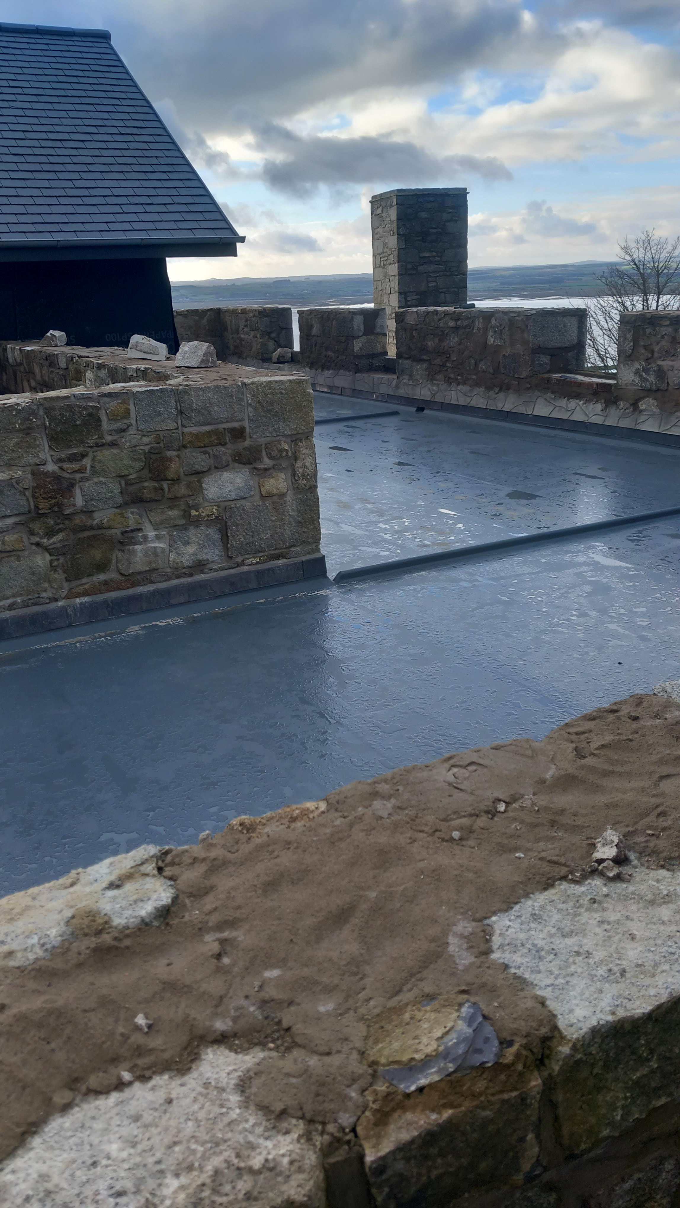

scottishjohn Posted October 16, 2024 Share Posted October 16, 2024 (edited) as you stated the problem with the GRP was installation --not the product itself with grp roofing it is essential that the boards under them are replaced at same time If these roofs were a repair of exsisting other roof my guess is they cut corners the prodcut is fine as for a rubber roof i have a friend who has a hotel with rubber roofing ,or had the crows would take things up on there and peck at them and made holes in the membrane it could also be they did not allow for expansion a good roofer will know how big it can be before it needs expansion flashings note the expansion joint on my balcony and lead flashings in the stone work that come down over the grp upstand flashings at the edges Edited October 16, 2024 by scottishjohn Link to comment Share on other sites More sharing options...
