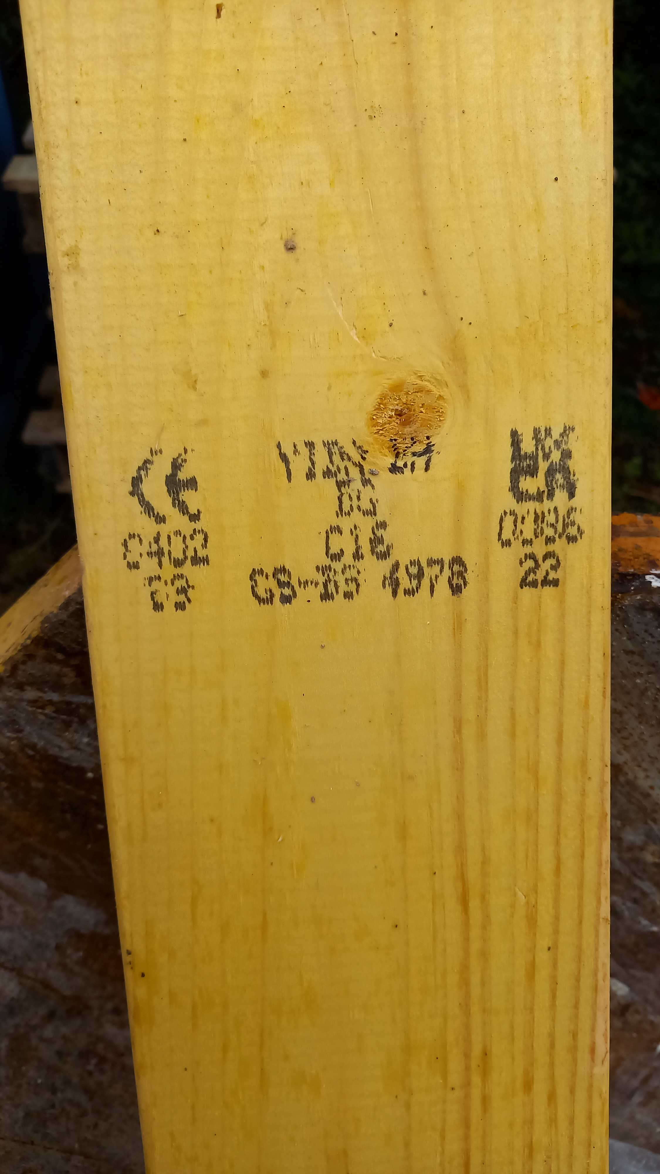

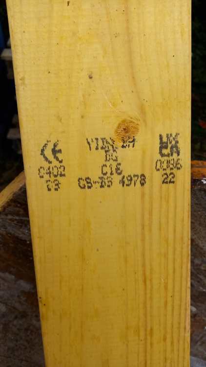

Post and beam Posted October 13, 2024 Posted October 13, 2024 Does anyone that knows have a view on whether this timber is 'treated' timber. And by definition therefore suitable for a soleplate Many thanks in advance keith
stu w Posted October 13, 2024 Posted October 13, 2024 (edited) Difficult to tell from that picture, could just be discoloured from age or the sun, but could also be vac vac treated. I would say it's not pressure treated personally . Trim a tiny bit off the end and see if there is impregnation marks Edited October 13, 2024 by stu w
Post and beam Posted October 13, 2024 Author Posted October 13, 2024 11 minutes ago, stu w said: Trim a tiny bit off the end and see if there is impregnation marks Thanks Stu. I will. I hoped the numbers designated it in some way as 'treated'. Personally i dont think it looks like anything other that white pine internal timber. The cut ends do not look like they have and impregnation of anything.
saveasteading Posted October 13, 2024 Posted October 13, 2024 (edited) I think that is treated. We had lots like that and I thought it was just sprayed but the website says it is thorough. May look it up later. Did it now. Ours was Protim treated. Looks yellow on the surface like yours. Apparently it is a pressure treatment that penetrates (tho it isn't visible to me in cuts.) Edited October 13, 2024 by saveasteading
stu w Posted October 13, 2024 Posted October 13, 2024 18 minutes ago, Post and beam said: Thanks Stu. I will. I hoped the numbers designated it in some way as 'treated'. Personally i dont think it looks like anything other that white pine internal timber. The cut ends do not look like they have and impregnation of anything. If in doubt especially for a sole plate, I would use pressure treated timber
Post and beam Posted October 13, 2024 Author Posted October 13, 2024 17 minutes ago, stu w said: especially for a sole plate Just checking up on a TF company. It is already in place with the walls mounted.
Post and beam Posted October 13, 2024 Author Posted October 13, 2024 38 minutes ago, saveasteading said: Apparently it is a pressure treatment that penetrates (tho it isn't visible to me in cuts.) Thanks, i hope so.
SteamyTea Posted October 13, 2024 Posted October 13, 2024 Loads of info here: https://www.thewpa.org.uk This one may have the info. https://www.thewpa.org.uk/_files/ugd/65ba63_e63cb92bfa184cb7b07b96bbbe32259f.pdf
Post and beam Posted October 15, 2024 Author Posted October 15, 2024 I am familiar with DOP certification in my working life. The displayed information showing compliance should be legible and enduring. I dont find the markings in the picture clear enough to read so i think i need to ask to see the paperwork that applies.
saveasteading Posted October 15, 2024 Posted October 15, 2024 There is an explanatory video on the James Jones website. Interesting. Google James Jones timber treatment. I didn't know there were so many classes of treatment according to use. Cuts need painting! 1
