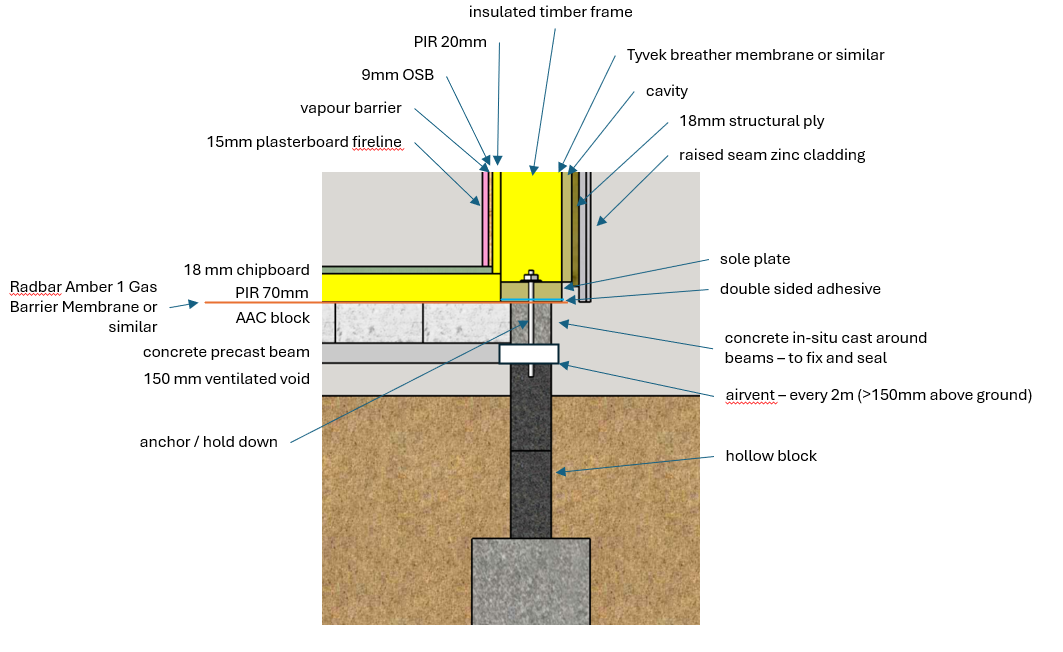

Lars P Posted October 9 Author Share Posted October 9 Great - thanks Redbeard - let me try pick your brain. First of all - the main house has no gas protection whatsoever - only a not very tight fitting DPM over the block and beam floor, - so seems somewhat pointless having to go through the effort of protecting the extension as it will be one big room. Anyway. Below is the design so far but I seem to have an issue with the anchor bolts penetrating the membrane. Also - I'm unclear how the membrane should be finished off where it meets the outside wall of the main house. Any ideas ? Link to comment Share on other sites More sharing options...

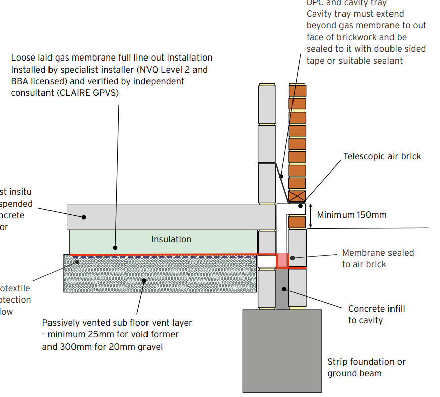

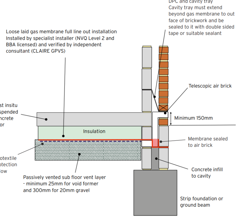

Lars P Posted October 9 Author Share Posted October 9 It's actually not Radon driving this palaver, but the fact that there is an old landfill 245.5 meters away from my front door - so my house is in the 250m 'buffer zone' - even though the extension in the back garden will be by 1m2 or so. Talking about measuring elastic band with a caliper So did you do something along these lines - just with the insulation and the slab swapped around - and then 100mm out though the foundation - and the membrane through the foundation as well ? Link to comment Share on other sites More sharing options...
saveasteading Posted October 10 Share Posted October 10 Radon barrier is just a slightly more expensive type of plastic dpm. The bolts through are of no consequence as the radon will flow out of the airbricks. The drawing saying radon barrier by specialists is far OTT. It is a roll of plastic. Link to comment Share on other sites More sharing options...
