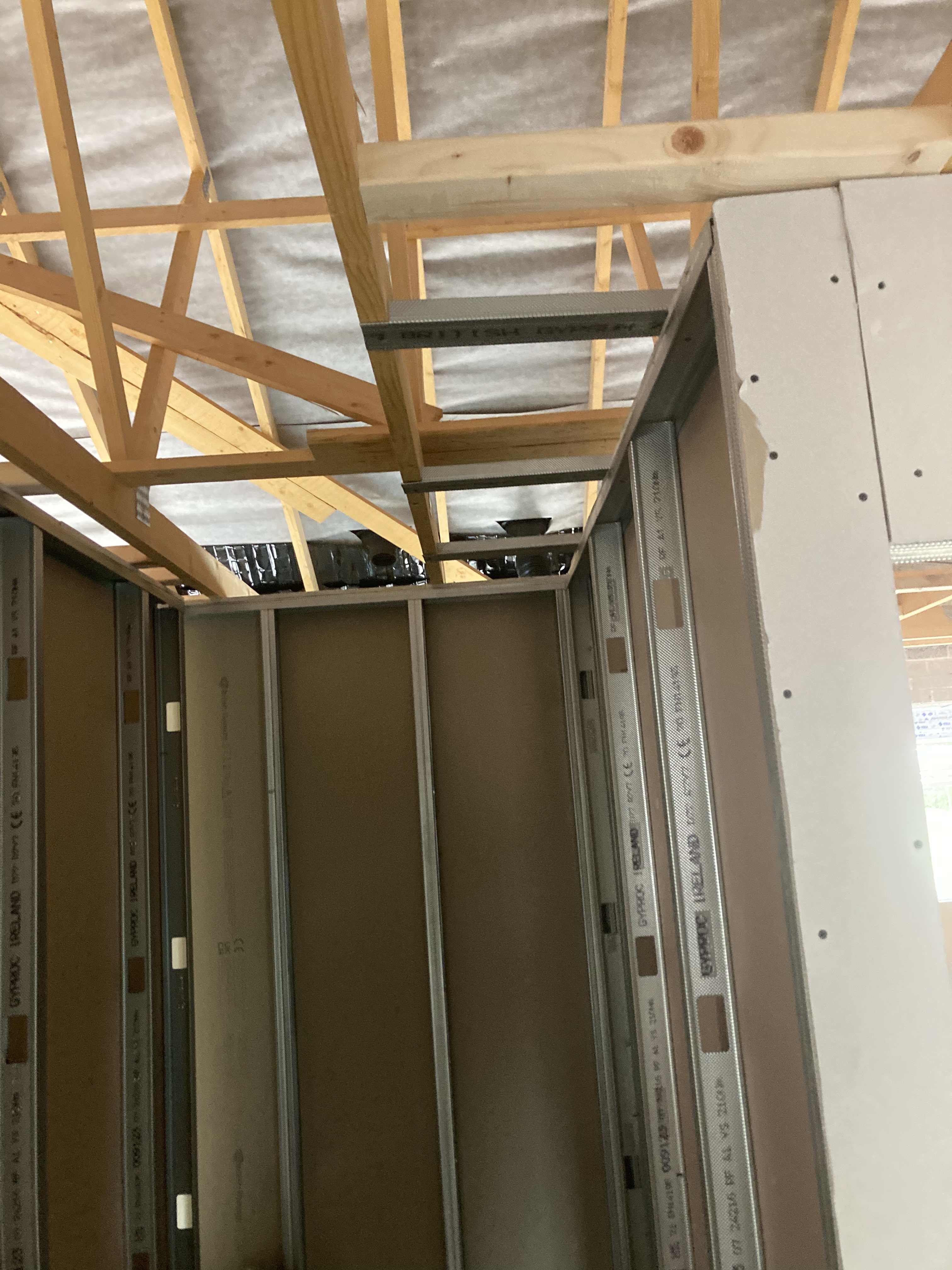

nod Posted October 8, 2024 Share Posted October 8, 2024 20 hours ago, nod said: Tell them Solid concrete blocks 7 n You cavity will dictate your insulation thickness T&G cavity batts Echotherm or similar You need to leave 100 mil cavity airflow So 150 cavity 100 mil insulated board Or you can full fill with a wool batt (Cheaper) This is one I’ve done this morning Trusses But same principle Link to comment Share on other sites More sharing options...

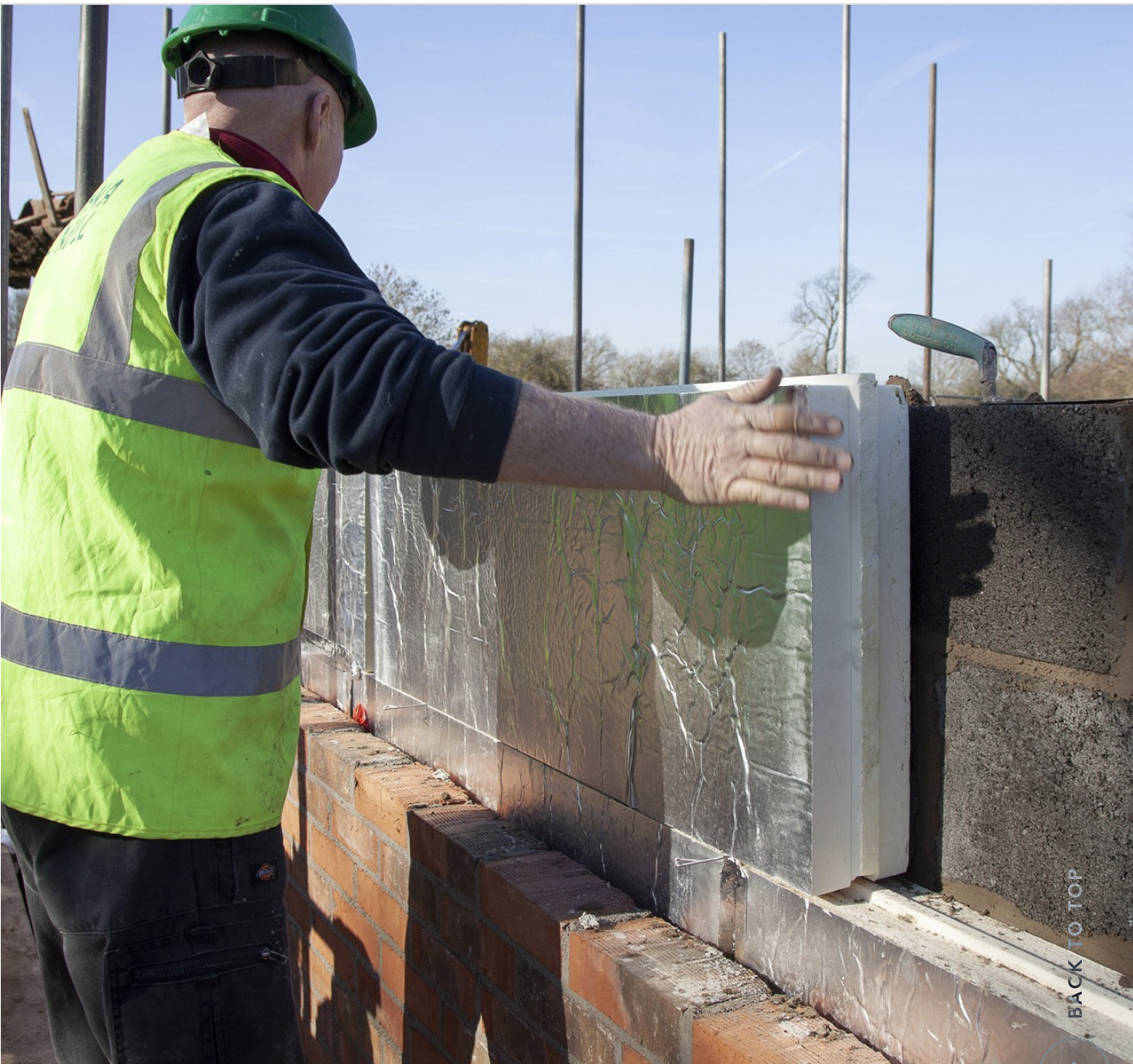

dan_cup Posted October 8, 2024 Author Share Posted October 8, 2024 On 07/10/2024 at 16:28, nod said: Tell them Solid concrete blocks 7 n You cavity will dictate your insulation thickness T&G cavity batts Echotherm or similar You need to leave 100 mil cavity airflow So 150 cavity 100 mil insulated board Or you can full fill with a wool batt (Cheaper) What do you mean here? On the Ecotherm site there a picture of builder using a board that fully fills the cavity? Am I right in thinking its 100mm block, 150mm cavity, 100mm brick. So if we use 100mm Eco therm then 50mm is free air space? Link to comment Share on other sites More sharing options...
MikeGrahamT21 Posted October 8, 2024 Share Posted October 8, 2024 The T&G PIR boards are designed as full fill with approx a 5mm gap, I used xtratherm ones on my latest build, now unilin but these ones are the same. have a look at their install guides, there will be buildup examples, but I know it’s full fill as it was one I’d considered using myself 1 Link to comment Share on other sites More sharing options...
