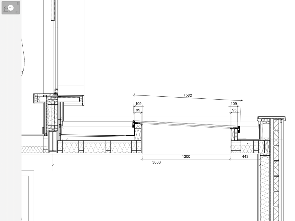

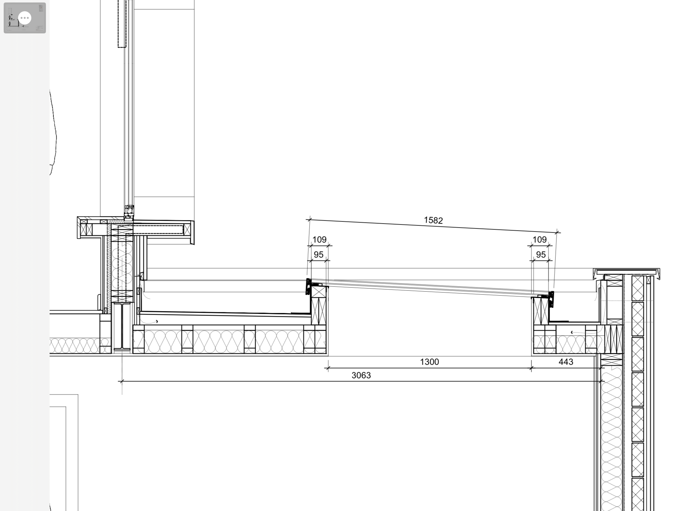

Here’s our flat roof.

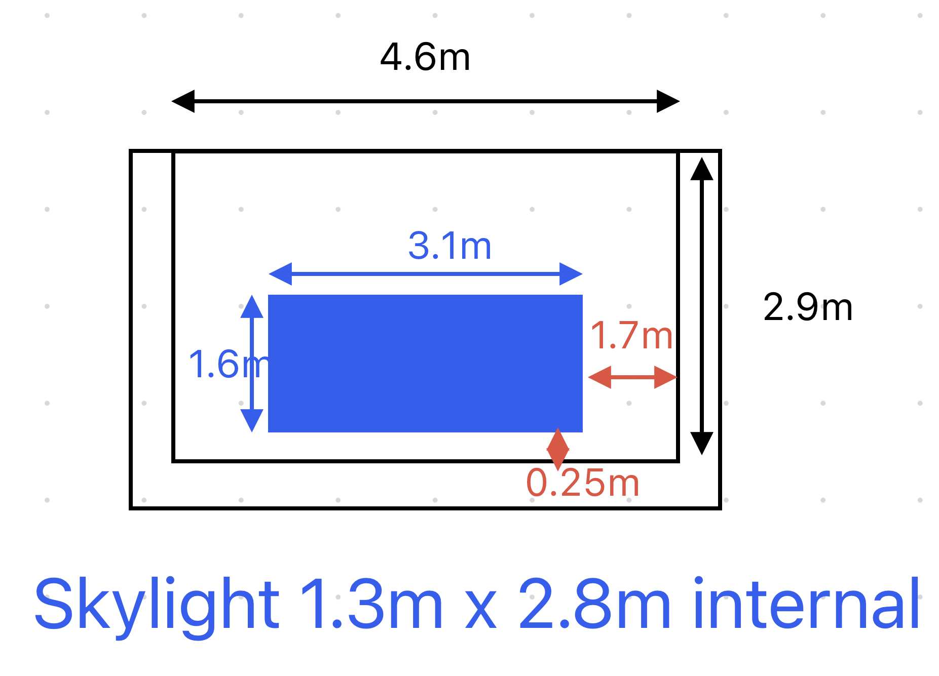

My first question is:  Is there enough room to get a cold roof sufficiently ventilated using those little upstand vents and the fact that the skylight mucks up cross flow?

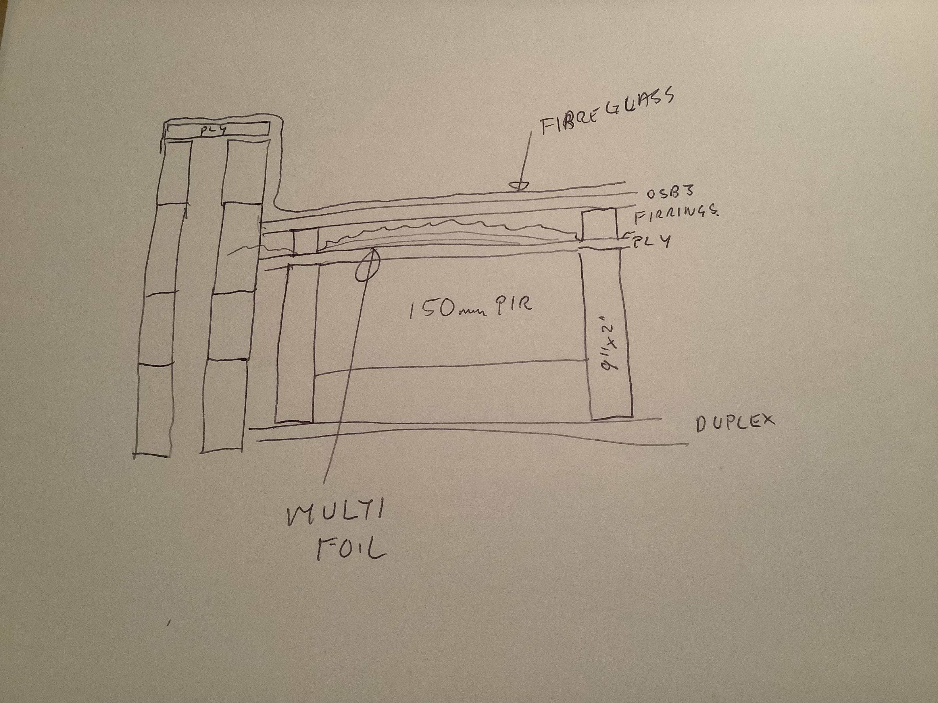

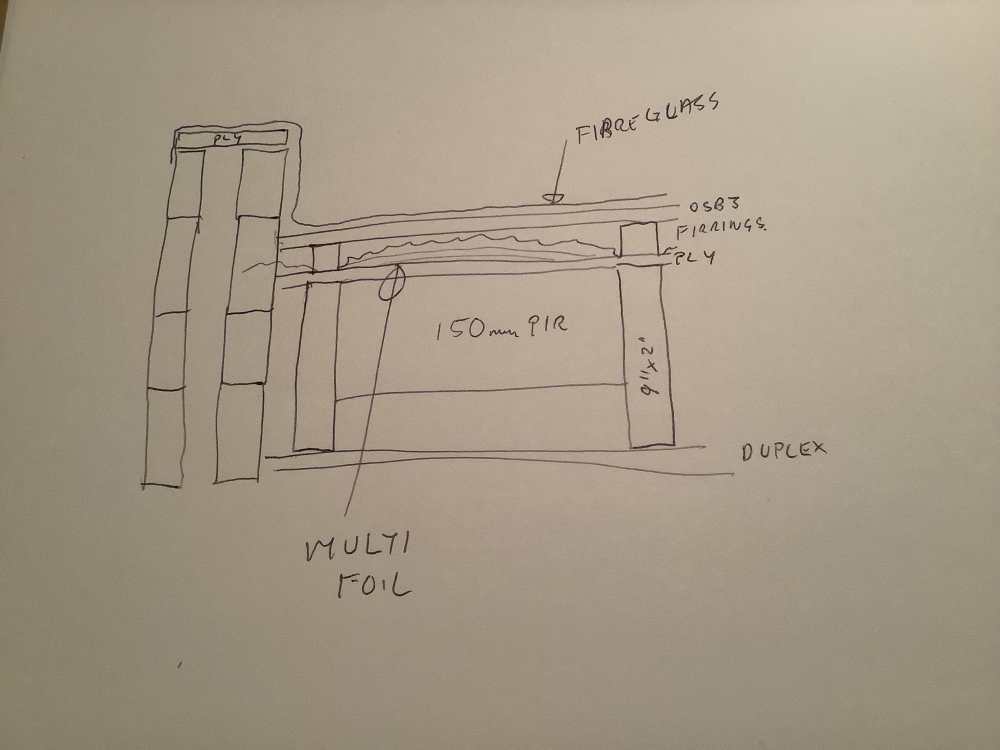

I used 9x2 joists boarded with ply Then a layer of multi foil Then fairings Toped with OSB 3
Plywood on the top of the blockwork
and returned the fibreglass over to make a watertight seal
First attempt at fibreglass
150 kingspan between the joists
Then boarded with 15 mil duplex and then skimmed it over with a couple of coats of multifinish
Ta.  Is this an accurate cross section?
So presumably the foil was your air tight layer.
That ply between the foil and the PIR will be cold and attract condensation and won't be able to dry out again unless you have superbly low internal humidity.
