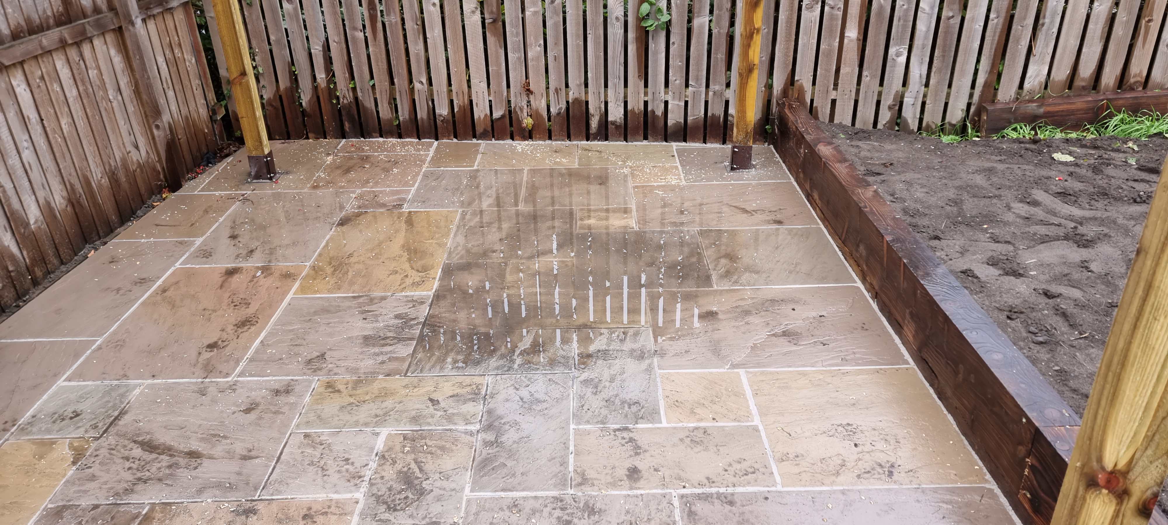

hemb Posted October 1, 2024 Share Posted October 1, 2024 Hi All, We recently had some builders over to lay some sandstone paving, but we noticed when it rained a puddle remains. We have paid them half of the bill. We are wondering what is the remedial work required to ensure a puddle does not remain there. Photos attached. Link to comment Share on other sites More sharing options...
markc Posted October 1, 2024 Share Posted October 1, 2024 (edited) Obviously no slope/fall to drain the surface, a level area will always puddle to some extent. Your only real option here (apart from taking up and starting again with a fall) is to drill one or more drainage holes in the area of the puddle. Edited October 1, 2024 by markc 1 Link to comment Share on other sites More sharing options...
Dave Jones Posted October 1, 2024 Share Posted October 1, 2024 put a long level on it and take photo. sandstone is cheap for a reason! As its riven it's never flat so water does collect on some slabs. Over very small distances you would need a large fall to clear it which looks crap and your table wont be level etc. its a balance. 1 Link to comment Share on other sites More sharing options...
