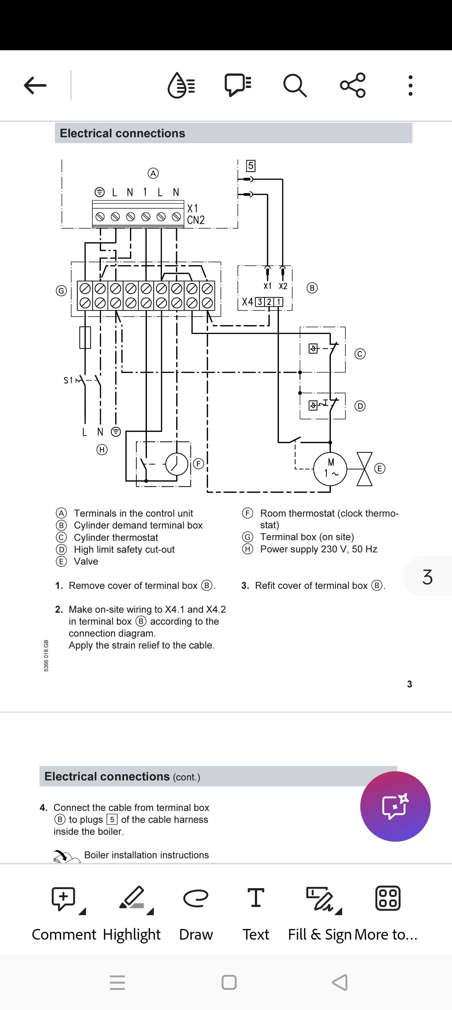

JohnMo Posted October 18, 2024 Posted October 18, 2024 2 hours ago, marshian said: Your drawing looks way more complicated than the cdt box drawing
MrPotts Posted October 18, 2024 Posted October 18, 2024 13 minutes ago, marshian said: But tying the two browns together does that too doesn't it?? Not being confrontational here - if I'm not doing the right thing then I'm happy to learn why I need to do it a different way but to my mind both ways achieve the same result I used the orange to power the HW demand box so I could have that in it's own section on the wiring centre because it's Viessmann thing to have an additional HW demand box. Sorry, I missed the bit where you said you had the browns together, yes that would also work. 1
marshian Posted October 18, 2024 Author Posted October 18, 2024 6 minutes ago, JohnMo said: Your drawing looks way more complicated than the cdt box drawing You do realise "my drawing" is of all the wiring centre (well when I finish it) and what you have posted is a diagram of how the HW demand box integrates with the boiler 😞 I must admit I've borrowed the base drawing from an S plan which is what the gas engineer set the system up to work as despite being asked to set it up as X plan!!! 51011_01-mBox-L32-S-Plan-connection-drawing-FRAMELESS.pdf
JohnMo Posted October 18, 2024 Posted October 18, 2024 (edited) 38 minutes ago, marshian said: You do realise "my drawing" is of all the wiring centre (well when I finish it) and what you have posted is a diagram of how the HW demand box integrates with the boiler 😞 I must admit I've borrowed the base drawing from an S plan which is what the gas engineer set the system up to work as despite being asked to set it up as X plan!!! 51011_01-mBox-L32-S-Plan-connection-drawing-FRAMELESS.pdf 23.56 kB · 0 downloads Yes I realise your drawing is for the whole wiring centre, so is the Viessmann one, letter G representing the wiring centre, it has all the central heating system control, hot water control and interface with the boiler. Your S plan just says boiler stop start, nothing else. The Viessmann drawing shows a switched live through your room thermostat for switch box L terminal to terminal 1. Your drawing doesn't show any such connections. In fact your room thermostat is really doing anything? Dump the S plan and use the Viessmann drawing. Drive your 2x 2 port valves as suggested above via switch in one 2 port. Edited October 18, 2024 by JohnMo
marshian Posted October 18, 2024 Author Posted October 18, 2024 1 hour ago, JohnMo said: Yes I realise your drawing is for the whole wiring centre, so is the Viessmann one, letter G representing the wiring centre, it has all the central heating system control, hot water control and interface with the boiler. Your S plan just says boiler stop start, nothing else. The Viessmann drawing shows a switched live through your room thermostat for switch box L terminal to terminal 1. Your drawing doesn't show any such connections. In fact your room thermostat is really doing anything? Dump the S plan and use the Viessmann drawing. Drive your 2x 2 port valves as suggested above via switch in one 2 port. you’re a very clever chap but either I am really rubbish at explaining stuff (and I can accept that criticism if I am) or your reading and comprehension skills are a bit poor and I’m going to assume it’s the former rather than the later for now As I said in earlier post CH side is not fnished in the drawing - I’ve just managed to get the HW side working as it should along with the transfer from CH to HW and back to CH having completed HW - not finished would account for some missing wires OK

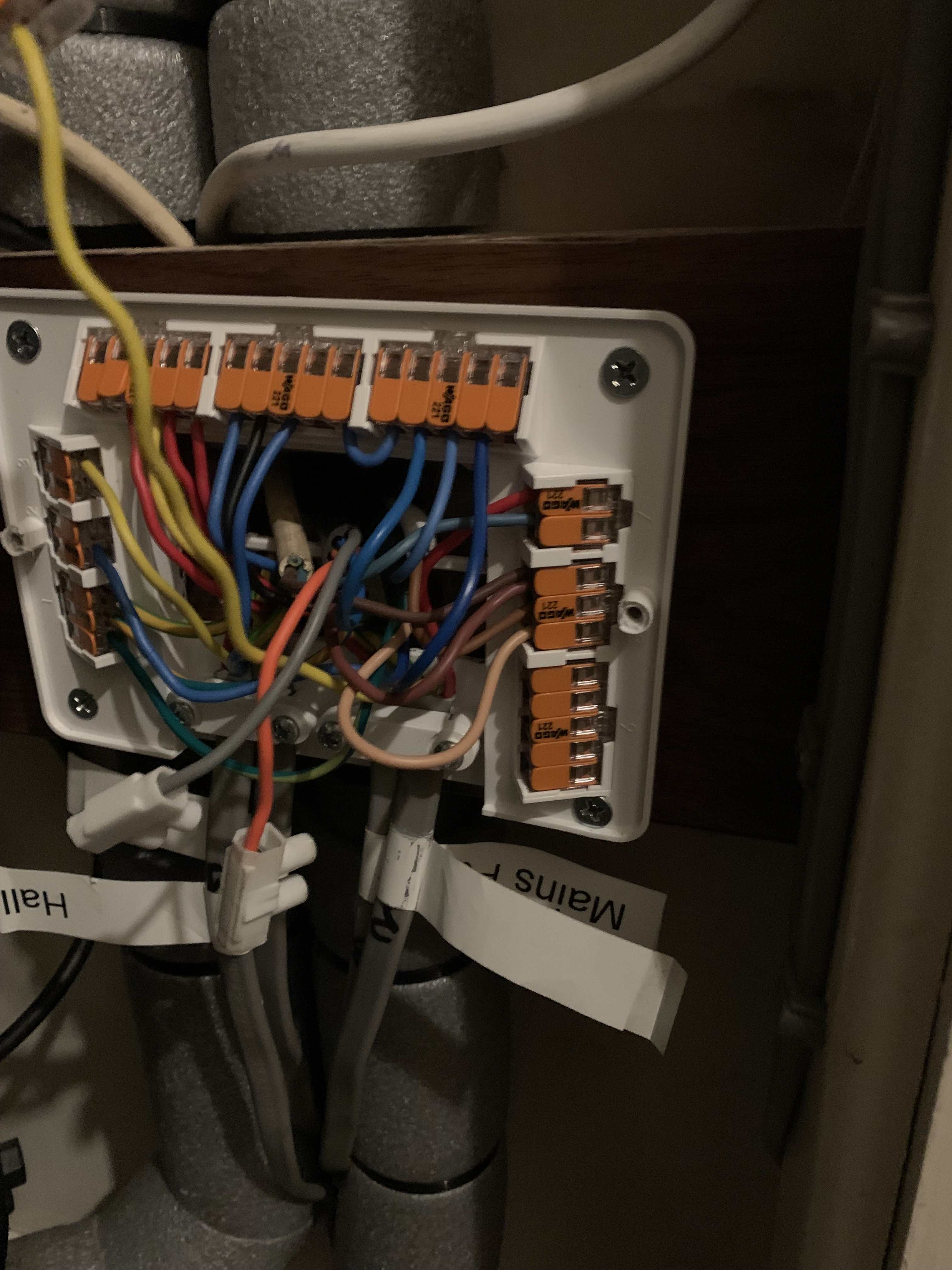

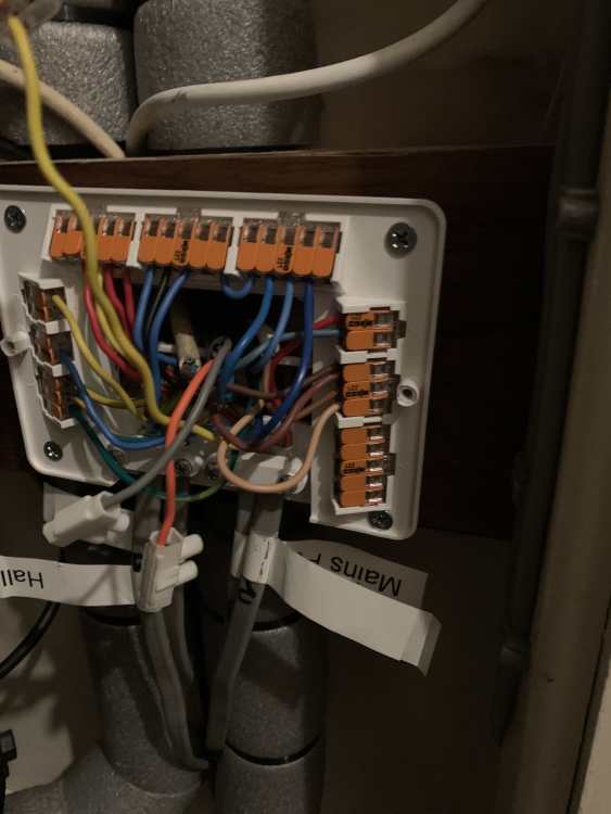

marshian Posted October 18, 2024 Author Posted October 18, 2024 Current state of wiring centre orange now located in bottom right and linked to HWD box grey is now in the live lot (top row left side) Reminds me - all the grey cables at the bottom were clamped before the install after none were clamped and the clamps were gone….. as a result I bought another L16 wiring centre to get new clamps and screws because I was less than happy about unclamped wires in a traffic area (SWMBO) keeps her ironing board and irons on the floor and shes a bit heavy handed Remember this is a Viessmann trained installer - only one in 50 mile radius I hate ending posts negatively - shat’s done is done I’ve clearly reached a point where I need to do this myself and any help or advice in this direction is appreciated and I can move forward positively

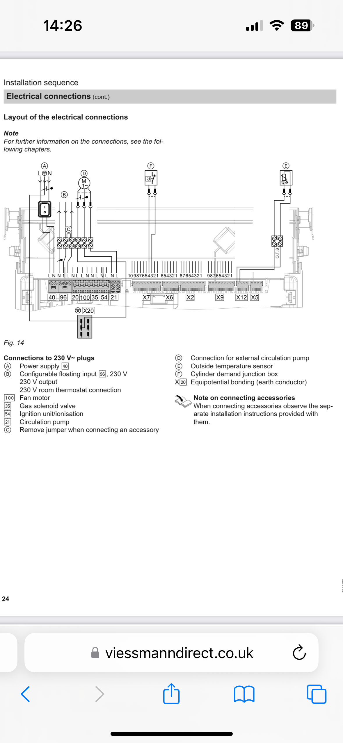

MrPotts Posted October 18, 2024 Posted October 18, 2024 (edited) So the connection has been made within the boiler to connector X1 position 1 and the link removed? This is going by what the boiler install manual says. Edited October 18, 2024 by MrPotts

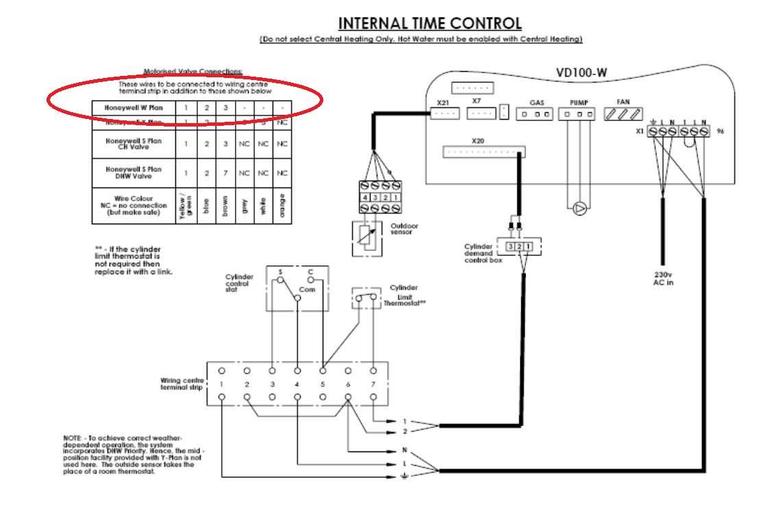

marshian Posted October 18, 2024 Author Posted October 18, 2024 2 minutes ago, JohnMo said: Just think your making a job very complex, just follow the manufacturer instructions. The supplement info for the outside sensor attached also. The simple wiring on the second section. With that I will get my coat. WB1B Compact Outdoor Sensor Instructions.pdf 124.52 kB · 0 downloads I’m trying very hard to do three things 1. understand how it works 2. Save the life of a fuse by not getting it wrong 3. Keep the smoke inside the wires thank you for your input but this is not my strong suit so I will be painfully slow in progress
MrPotts Posted October 18, 2024 Posted October 18, 2024 (edited) 12 minutes ago, marshian said: What connection?? boiler has Direct control of the pump HWD box wired in Weather Compensation sensor wired in The boiler has been “told” to run in weather compensated operation mode The link wire is still in place and I think it’s running on a permenant live and Neutral only with no switched live in sight But as I’ve said electrickery is not my strong point - if it’s got oil or water in it or it needs to fabricated in steel or wood or whatever I’m fine with it It looks like the link is providing a permanent live to terminal 1 on connector X1 which looks like it is the CH demand hence the boiler runs continually. Edited October 18, 2024 by MrPotts
marshian Posted October 18, 2024 Author Posted October 18, 2024 Whoa @JohnMo That link has this diagram - It's not in any of the documentation I got with the boiler or HWD box or weather sensor........... Is a W Plan similar to X plan with a 3 wire NO CH Valve??
marshian Posted October 18, 2024 Author Posted October 18, 2024 7 minutes ago, MrPotts said: It looks like the link is providing a permanent live to terminal 1 on connector X1 which looks like it is the CH demand hence the boiler runs continually if the room thermostat demands heat even with the programmer off. Highly likely - That will be down to the gas engineer to resolve - I'm absolutely fine with doing everything outside the boiler - not so fine with stuff inside it.................

MrPotts Posted October 19, 2024 Posted October 19, 2024 (edited) 3 hours ago, marshian said: as the link is external to the PCB I decided to remove it……. No pump at all What’s the GC number of your boiler? Edit found it on post 1 Edited October 19, 2024 by MrPotts
MrPotts Posted October 19, 2024 Posted October 19, 2024 3 hours ago, marshian said: as the link is external to the PCB I decided to remove it……. No pump at all Have you made all the connections to the boiler as per attached?

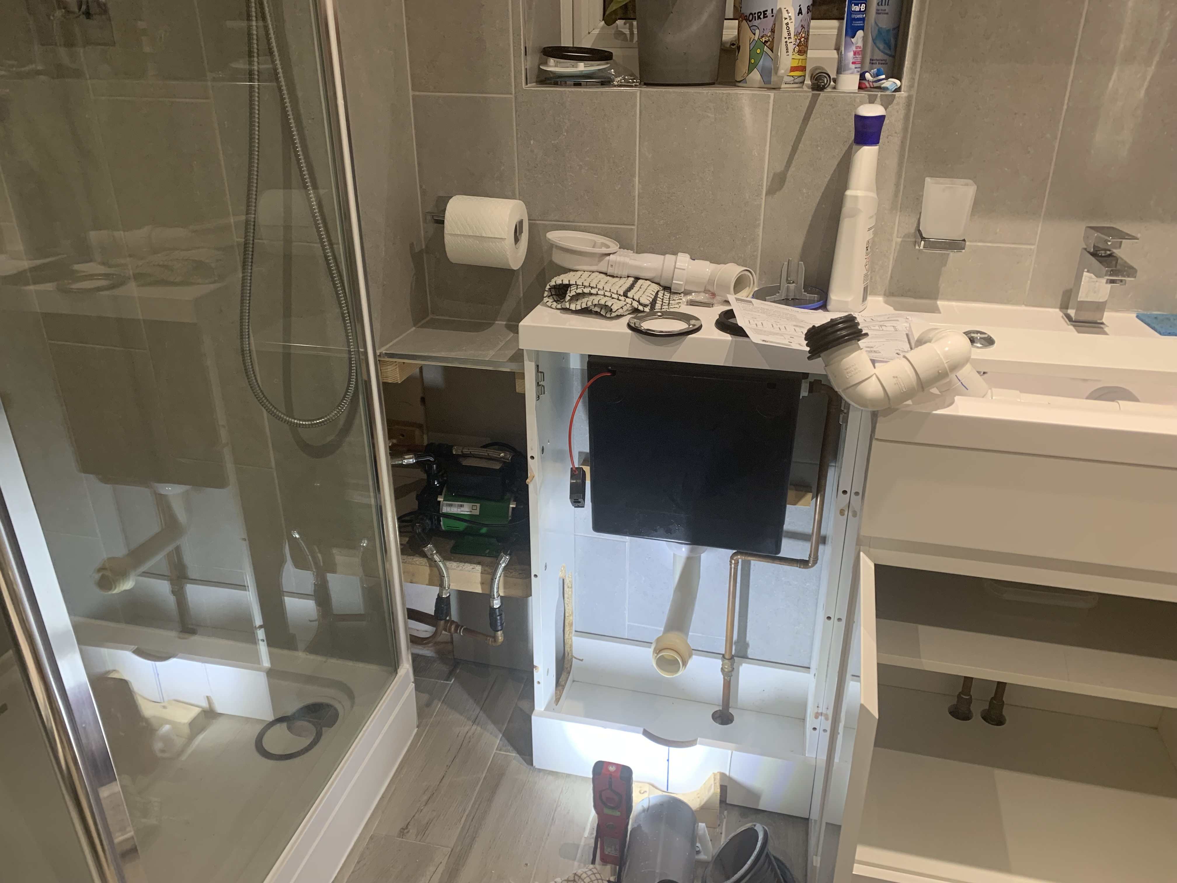

marshian Posted October 20, 2024 Author Posted October 20, 2024 (edited) Sorry for slow reply - my attention has been diverted to bathroom issues shower waste needed replacing and access was too tight with the soil pipe in the way - luckily I did the bathroom myself so knew how it all went together Later today I’ll check out the boiler connections Edited October 20, 2024 by marshian Formatting
marshian Posted October 20, 2024 Author Posted October 20, 2024 9 hours ago, MrPotts said: Have you made all the connections to the boiler as per attached? Sorry had to rip apart my bath room to replace a shower waste that was letting in smells So connected (Not me) but AFAIK Outside temp sensor yes HW Demand box Power to the Boiler (Live, Neutral and Earth) After that sorry but not a clue
