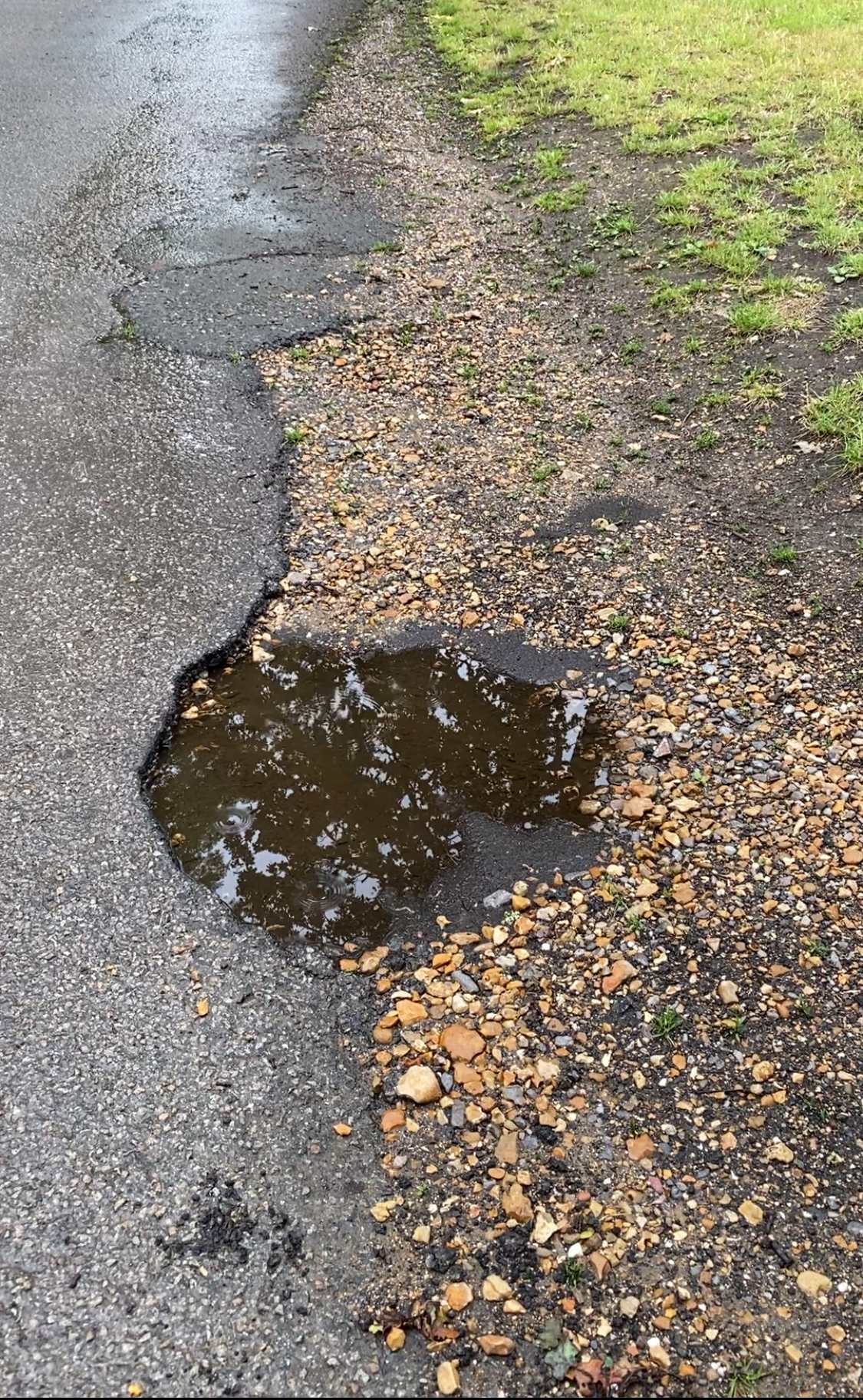

Great_scot_selfbuild Posted September 20, 2024 Posted September 20, 2024 (See attached photo) I’m looking to repair some potholes and general wear and tear along the unadapted lane leading to our site (‘driveways’ seemed to be the only suitable topic area - let me know if theees a better one to ask this in) This deep pothole is on the edge of the tarmac road surface, where it meets the gravel. can anyone advise on the best way to repair this? Many thanks
Alan Ambrose Posted September 20, 2024 Posted September 20, 2024 Some tarmac in bags from a cheap DIY store and a welly boot?
Great_scot_selfbuild Posted September 22, 2024 Author Posted September 22, 2024 On 20/09/2024 at 18:02, Alan Ambrose said: Some tarmac in bags from a cheap DIY store and a welly boot? Any advice on how you finish the edge to prevent it just crumbling away? (I've used tarmac for individual pothole repairs, but without a firm edge to compact it against, I think any vehicle weight on it would just cause the edge to collapse and push the tarmac out the side).
Mike Posted September 22, 2024 Posted September 22, 2024 12 hours ago, Great_scot_selfbuild said: Any advice on how you finish the edge to prevent it just crumbling away? To do it properly, add a kerb stone or brick edging along the full length, on a concrete bed and with haunching.
