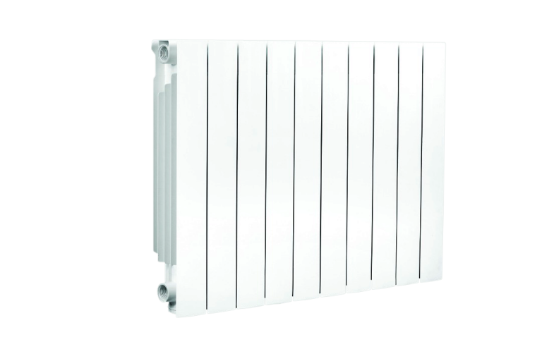

Crispy75 Posted September 16, 2024 Posted September 16, 2024 I'll be insulating my house, as well as the new extension (one storey up, on the whole footprint). All new windows too. Aiming for EnerPHit. The house is curently heated by a Vaillant Ecofit 825 gas boiler and mostly some rather fancy-looking cast-aluminium radiators; modular KAL models from Italy. The modern version is this: https://www.kazuki.co/en/product/radiators/aluminum-radiators/aluminum-radiator-kal-c which looks almost identical. The boiler has a 9kW capacity and I calculate all the radiators to have a total output of 6kW at dt50. After the works, the house will be 50% larger, but also much better insulated (U values: Walls 0.1, Roof 0.09 W/m²K). PHPP says my heating load will be 1.7kW at -10°C (or 2.2kW before taking solar gains and indirect heat in account, which is closer to the figure you'd get from a vanilla heat loss calc). This is a reduction of 75%, on a W/m² of floor area basis. I want to replace the gas boiler with an ASHP (and also get some fan coil cooling on very hot days, but that's for another thread, another time). I think I can get away with using the existing radiators at dt20 or 30, simply due to the much lower heating load. Now, the KAL radiators don't have data for dt20 or dt30, so I had to extrapolate from their 60/50/40 figures. There's also one Type 11 radiator which is easy to calculate. With the addition of small Type 11 radiators in the new bedrooms, I get a total output of 2.6kW at dt20, of which 2kW is the existing radiators. This roughly matches my load of 2.2kW, with a little headroom for error. Does that sound about right? Going down from 6kW@dt50 to 2kW@dt20 with the same rads? Is my roughly linear extrapolation correct? Will the flow rates be so wildly different that the pipe diameter will matter? I've attached the spreadsheet I used to do these sums and would greatly appreciate any advice. Thanks ^ KAL radiator. They're quite attractive so I'd like to keep them. Radiator Sizing.xlsxFetching info...

JohnMo Posted September 17, 2024 Posted September 17, 2024 Radiator heat output calculator, yellow cells is what to alter, use a dT between flow and return of 5. Radiator Heat Output Calculator (1).xlsxFetching info... 1
Crispy75 Posted September 17, 2024 Author Posted September 17, 2024 On 17/09/2024 at 08:10, JohnMo said: Radiator heat output calculator, yellow cells is what to alter, use a dT between flow and return of 5. Radiator Heat Output Calculator (1).xlsx 21.71 kB · 2 downloads Expand Cheers, very useful, and checks out pretty close when compared against manufacture data. Also comes out less than my extrapolation, so I'd be running at dt25 or so to keep some headroom. Still well within sensible limits. If I try and get the boiler upgrade grant for the ASHP, will the installers accept PHPP's heat load calculations, or will they be forced to use cruder methods? (and therefore come up with larger rad requirements)

John Carroll Posted September 19, 2024 Posted September 19, 2024 On 17/09/2024 at 09:59, Crispy75 said: Cheers, very useful, and checks out pretty close when compared against manufacture data. Also comes out less than my extrapolation, so I'd be running at dt25 or so to keep some headroom. Still well within sensible limits. If I try and get the boiler upgrade grant for the ASHP, will the installers accept PHPP's heat load calculations, or will they be forced to use cruder methods? (and therefore come up with larger rad requirements) Expand With a ASHP or weather compensation one should try and keep the dT as low as possible to achieve the lowest possible flow temperatures at any required output, I generally use a dT of 5C, but I just use my attached calcs to give any combination required. Radiator Output crispy.xlsxFetching info...
