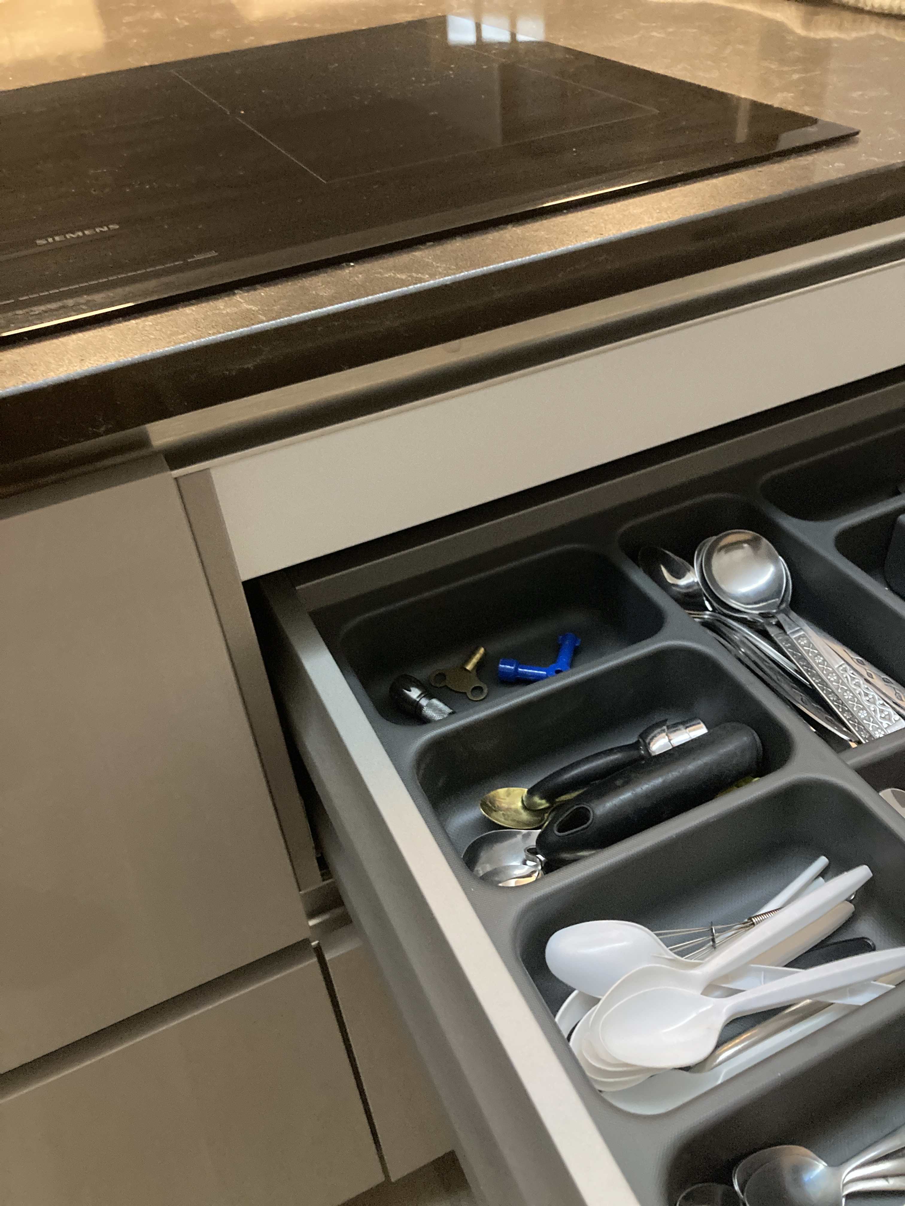

Del-inquent Posted September 12, 2024 Share Posted September 12, 2024 Can't get hold of the sparky and need an answer for the kitchen designer on this urgently! A slight deviation from the plan with the boiler install has meant I'm going to have to have a shallow depth cupboard (100mm deep) between countertop and underside of wall cabinets. It'll have a functional door on the front face of it. Can the grid switch for the FF / DW / Fan / Hob ignitor go INSIDE that little cupboard? It would also then make it a lot harder to accidentally switch off the fridge or freezer... Link to comment Share on other sites More sharing options...
Super_Paulie Posted September 12, 2024 Share Posted September 12, 2024 Can do what you like really, all my isolators are in a cupboard. Think there is an unofficial recommendation of having the oven isolator within 2m but it's not a reg. 1 Link to comment Share on other sites More sharing options...
nod Posted September 12, 2024 Share Posted September 12, 2024 1 hour ago, Del-inquent said: Can't get hold of the sparky and need an answer for the kitchen designer on this urgently! A slight deviation from the plan with the boiler install has meant I'm going to have to have a shallow depth cupboard (100mm deep) between countertop and underside of wall cabinets. It'll have a functional door on the front face of it. Can the grid switch for the FF / DW / Fan / Hob ignitor go INSIDE that little cupboard? It would also then make it a lot harder to accidentally switch off the fridge or freezer... ours is at the back of the drawer 1 Link to comment Share on other sites More sharing options...
