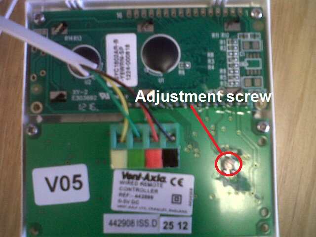

we have just installed and connected up a wired remote for the vent-axia sentinal BH MVHR.
Does anyone else here have one of these?
Should it have a backlight on the display?
Our remote is working but the display is really faint, there is no backlight and I have to use torch to read it!
Wonder if it is a fault?
Thans

For future reference if it helps others...
Having contacted tech support at vent axia, the wired remote does not have a backlight.
There is a contrast adjustment - a small variable resistor near the connector - see attached
Tweaking that with a small screwdriver adjusts the lcd contrast and it is now readable.

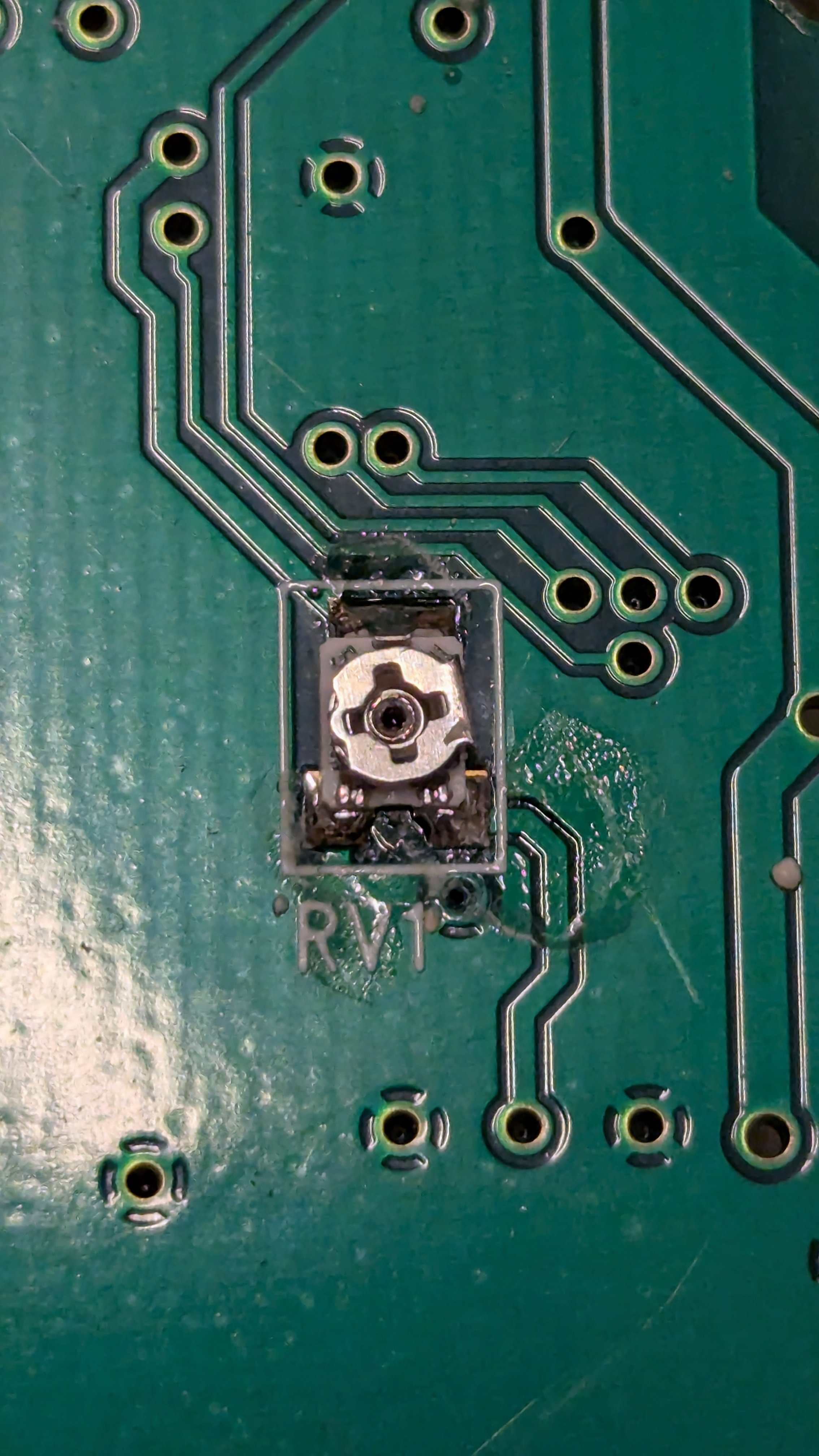

Sigh, I've got this exact issue.
I can control the main unit using the remote buttons but nothing visible on screen... At all.
I can see the adjustment screw but can't seem to turn it. Is there a knack?
Thanks,
Jim.
On some the part that turns is the silver disk, so you need a flat blade screwdriver that goes across the flats.
Turn this VERY slowly and carefully, as these are quite fragile PCB mounted components.
It may be the spindle in the dead centre also, but a bit hard to tell from the pic. If that is a oblong shape then it may be so.
