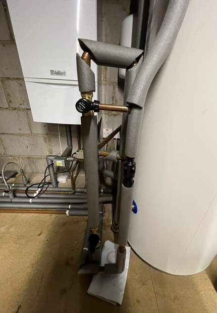

steveoelliott Posted October 16, 2024 Author Posted October 16, 2024 A week on, this hasn't so far got any worse but it doesn't happen every time the hot water in drawn. For the purposes of testing, I always use the bath hot tap, opened fully. As an example, I drew hot water right after the heating cycle for ~10 seconds, no noise. Repeated the process after 30 seconds, no noise. On the third go, it made the noise a few seconds after drawing hot water. This to me rules out expansion and or pressure. Since they would be much higher / worse after the initial heat cycle. Baxi and my own plumber are at a loss to what this might be.

Nickfromwales Posted October 18, 2024 Posted October 18, 2024 Is the non return on the UVC hot outlet a single check or double check? I’d look at that next as these tend to be quiet with lots of flow/pressure and noisy with lower values. May be the ‘groan’ off that tbh. The installer has done a good job here, so I think it’ll be down to component failure vs misadventure, so if there’s a secondary pressure reducing valve at the cold mains stopcock then try fitting a straight coupler in place of that NRV and see if that kills the issue. A simple additional ‘process of elimination’ there imo, and worth trying. Just remember to double check that the secondary PRedV is functional before committing to a day of testing. (FYI the primary PRedV will be the control group at the UVC). 1

steveoelliott Posted November 7, 2024 Author Posted November 7, 2024 (edited) Well, I can firstly confirm the cylinder has a single check valve and not a double. @Nickfromwales I have once again been able to reproduce this issue and I am confident the external EV plays no part in this. When this video was taken a significant amount of hot water had been used since the last heating cycle and testament to this fact is the EV was cold to the touch as was the pipe between that and the cylinder. I am leaning towards thinking either a dodgy NRV or something within the cylinder. Interestingly, this time the noise was much louder and echo's. Any feedback welcomed. I've decided the next course of action is the NRV. Interestingly, if you watch the video zoomed in you can see the tundish and pipe around it vibrate with the noise. I am even curious if this could be the PRV but I can't think of any reason why it would do this. No water residue in tundish. Img 4767-1.mp4 Edited November 7, 2024 by steveoelliott
steveoelliott Posted November 9, 2024 Author Posted November 9, 2024 I’ve decided that I’m going to remove the NRV on the top of the cylinder and replace the T&P valve whilst I have the plumber out. After that the only part not replaced will be the EV.
steveoelliott Posted November 15, 2024 Author Posted November 15, 2024 OK, so my plumber came today and for the first time I reproduced it with him in the loft next to the cylinder. I had him out to replace the NRV, T&P and EV. Figured I'd make sure everything had been done but after hearing the noise he told me it is definitely coming from inside the cylinder. On another group a plumber suggested that the breakup of the baffle can cause this noise as it catches / releases. Anyway, I've contacted Baxi to get a replacement. 1

Doug Tag Posted February 1, 2025 Posted February 1, 2025 Have you had this fixed yet? If not adjust your pressure vessel to 0.2bar below your dynamic pressure of your cold supply to the cylinder. Most of the time those pressure vessels come charged to as much as 3 bar. At a guess 1Bar would probably sort it but the proper way to adjust it is as per above. 99% if the time noise problems like this is a pressure vessel problem I’ve fixed countless systems like this. Anyway hope this helps 👍 step by step, 1) check dynamic pressure on cold supply to the cylinder 2)isolate the cold supply to the cylinder and run off the pressure by opening a hot tap 3)check the pressure on the pressure vessel through the Schrader valve 4)Reduce the pressure in the pressure vessel to 0.2 Bar below the dynamic pressure by depressing the pin in the Schrader valve 5)Open the cold supply back up and run the hot taps to remove air from the system 6) turn the hot water on for an hr or until the cylinder is suitably heated up 7) open hot tap with crossed finger and hopefully steps 1-6 have to been a waste of time 😂👍 good luck but I’m optimistic 1

John Carroll Posted February 9, 2025 Posted February 9, 2025 You could/may still have a air bubble in the Megaflo in which the water level will rise & fall a bit especially with fluctuating dynamic pressure which can cause movement/noise of (if) broken baffle bits. If you remove the HW outlet pipe it should be relatively easy to drill even a pin hole sized hole in the dip tube which will very quickly destroy the air bubble, you then have a full cylinder of water with virtually no movement as it will all happen in the EV and just might stop that noise. 1
