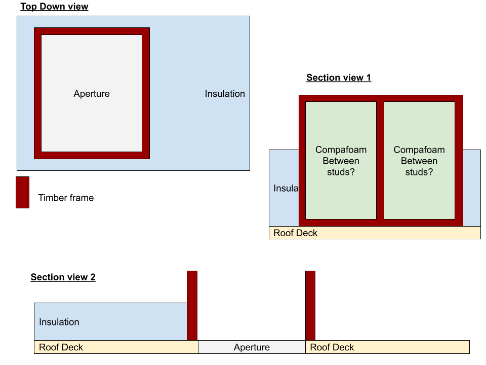

SBMS Posted September 1, 2024 Author Posted September 1, 2024 15 minutes ago, JohnMo said: Making the wooden frame and having it shorter in height than insulation gets rid of any possible bridges. So if you have 200mm of insulation above the roof make the timber upstand about 170mm, the Compafoam then is 150mm plus 30mm, plus any boards on to of the insulation and your roof finish, so about 200mm high Compafoam. Yes @JohnMo thanks for this - am still a bit confused with the makeup.. Is it like the below (tried to show it from a few angles). So build a tinber frame around the aperture, then fill between studs with compafoam with levels as you mentioned?
SBMS Posted September 1, 2024 Author Posted September 1, 2024 18 minutes ago, JohnMo said: Have done hopefully a clearer sketch Thanks - and in between the studs of the timber upstands goes compafoam (my section view 1) or could I infill with the PIR?
JohnMo Posted September 1, 2024 Posted September 1, 2024 41 minutes ago, SBMS said: Thanks - and in between the studs of the timber upstands goes compafoam (my section view 1) or could I infill with the PIR? No Compafoam goes above the wooden frame would have similar dimensions to the Compafoam upstand. The opening shown on my last sketch is the aperture for your skylight. So is showing the left and right of the aperture. You would line the aperture with 25mm PIR then plasterboard or what ever you want. So nothing like your drawings.
