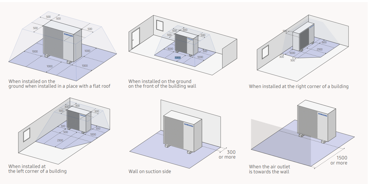

Dan G Posted August 28, 2024 Share Posted August 28, 2024 (edited) I've read this thread but am still a little confused; could a R290 ASHP be sited beneath my kitchen window, on the patio below it? The window sill is 1.5 m above the patio, and there are no other doors or windows for several metres in any direction. It would be a single fan unit (heat loss 3.5 kW!) Edited August 28, 2024 by Dan G Link to comment Share on other sites More sharing options...
JohnMo Posted August 28, 2024 Share Posted August 28, 2024 21 minutes ago, Dan G said: I've read this thread but am still a little confused; could a R290 ASHP be sited beneath my kitchen window, on the patio below it? The window sill is 1.5 m above the patio, and there are no other doors or windows for several metres in any direction. It would be a single fan unit (heat loss 3.5 kW!) Read the manufacturer instructions for the unit you are interested in. The instructions trump everything else. Link to comment Share on other sites More sharing options...
Dan G Posted August 28, 2024 Author Share Posted August 28, 2024 (edited) Pretty sure my interpretation of the manual isn't going to change the opinion of an installer. Edited August 28, 2024 by Dan G Link to comment Share on other sites More sharing options...
JohnMo Posted August 28, 2024 Share Posted August 28, 2024 41 minutes ago, Dan G said: could a R290 ASHP be sited beneath my kitchen window, on the patio below it? No, if it's a Vaillant, you are unlikely to be in a protective zone height wise, so the first clause doesn't get you. But in a different sector states the second clause. 1. Vaillant says for example A protective zone is defined around the product. There must be no windows, doors, light shafts, cellar entrances, escape hatches, flat-roof windows or ventilation openings in the protective zone. But even with a window move and outside the protective zone it also states the below. 2. Avoid choosing an installation position which is near to a window. Interesting my R32 does not mention windows at all. Link to comment Share on other sites More sharing options...
JamesPa Posted August 28, 2024 Share Posted August 28, 2024 (edited) 4 hours ago, Dan G said: I've read this thread but am still a little confused; could a R290 ASHP be sited beneath my kitchen window, on the patio below it? The window sill is 1.5 m above the patio, and there are no other doors or windows for several metres in any direction. It would be a single fan unit (heat loss 3.5 kW!) The protected zone as specify by vaillant (as I read their diagram) does not extend above the unit. That's logical too, propane is heavier than air. I'm not sure about @JohnMos second sentence, in my version of the manual this comment is only attached to the instructions for wall mounting not floor mounting - is it an instruction for safety reasons or just a recommendation eg for noise or structural integrity (since wall mounted is more likely to be close to a bedroom in the house they draw/the structural integrity of a wall reduces close to a window). Surely if it's outside the defined protective zone then it's outside it, end of? You could always call tech support if your chosen manufacturer will speak to mortals (some will, some wont, if its Vaillant they will). That should convince your installer (or not depending on what they say) Here is a samsung diagram, again the zone extends below but not above the unit, the dotted lines show that if there is any doubt. Of course what the installer will do (not what the manual says) trumps everything else! Edited August 28, 2024 by JamesPa 1 Link to comment Share on other sites More sharing options...
JamesPa Posted August 28, 2024 Share Posted August 28, 2024 (edited) Further to the above I tried to find the source regulations (which seems to me to be the best approach in cases of doubt). I had expected to find UK or EU regulations which govern this and are definitive. Unfortunately I failed. Worse still this link https://internationalfireandsafetyjournal.com/besa-highlights-safety-risks-of-flammable-refrigerant-gases-in-hvac-systems/ suggests there may be no source regulations, at least in the uk It seems nevertheless that somehow the heat pump manufacturers have converged on a set of rules, but their origin remains obscure. Hopefully someone will know what the origin is and will post it, otherwise it really is down to individual heat pump manufacturers (and in practice installers). It is beginning to look like it may be a bit of a mess. Edited August 28, 2024 by JamesPa Link to comment Share on other sites More sharing options...
mk1_man Posted August 29, 2024 Share Posted August 29, 2024 I have just fitted a Vaillant ashp, a window above the unit and outside of the protected zone is permitted. You can also have a window that extends to the ground as long as it is non opening or at least the element that is located within the protected zone is non opening i.e. split unit. 1 Link to comment Share on other sites More sharing options...

sharpener Posted August 30, 2024 Share Posted August 30, 2024 10 hours ago, ReedRichards said: My heat pump is right next to a drain which carries rainwater off the roof to a soakaway. I am assuming if it goes to a soakaway it doesn't also take grey water from e.g. the kitchen sink as you often see with pre-WWII houses. Depending on the age of the building it will probably be a trapped gully, in which case the propane which is denser than air but not denser than water cannot get into the underground pipework so you are OK. If not you could either replace it with a trapped gully (if it also takes surface water) or use a rainwater downpipe to underground drain connection which is not open to the air/propane. I would think the simple rubber cap type is adequate. In the extreme you could build a gas-tight housing round it higher than the top of the HP. This might be as simple as extending the 110 mm underground pipework upwards and doing the transition from downpipe above the level of the HP. But I don't think they care about drains much, even if they used to. Have just checked the MIs for my new Vaillant R290, they expressly state (section 4.2) "Open gullies or downpipes within the protective zone do not pose any safety risk." Link to comment Share on other sites More sharing options...
