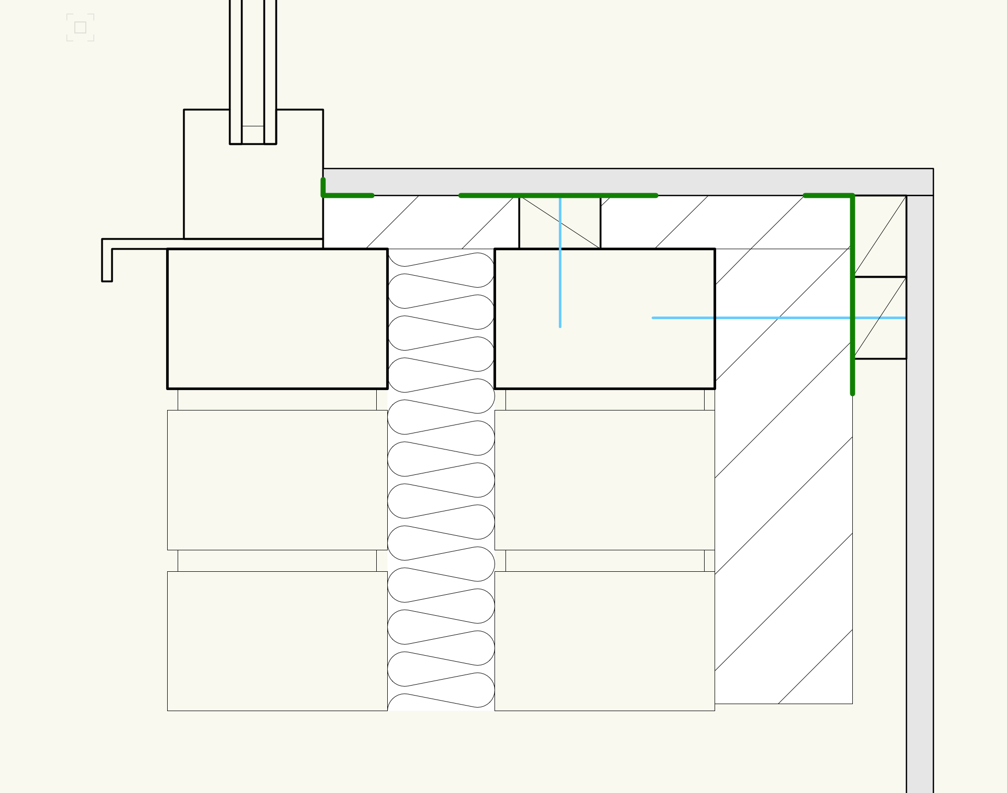

SLABdan Posted August 20, 2024 Share Posted August 20, 2024 Hi all, Long time lurker here! We're approaching the end of our retrofit of a 1960s house. Full IWI, membraned, battened, taped, MVHR, the whole lot. However, we didnt have enough funds for new windows at this phase so an exec decision was taken to progress and a few years down the line swap them out. Now I have a dilema (a nice one), our financial position has changed so we're in a position to replace, the only problem is that the old windows are taped in, insulated reveals and now skimmed 😅 Besides slicing the airtight tape tight to the old window and splodging in a tonne of airtight sealant during installation (masking my nicely skimmed reveals) does anyone have any other ideas. I'd prefer not to reskim every reveal (my plasterer - family friend will kill me). Other option I was thinking about was a timber lining to each? Any pearls of wisdom amongst you clever folk? Link to comment Share on other sites More sharing options...
SLABdan Posted August 20, 2024 Author Share Posted August 20, 2024 This is the window section. Hatched areas are PIR. Green lines are airtight tape. Blue are concrete fixings. Cavity wall insulation also in there currently. Link to comment Share on other sites More sharing options...
TommoUK Posted August 20, 2024 Share Posted August 20, 2024 ..get a cross section of your new windows and work out where it needs to sit. bear in mind the the best placement for thermal bridging (look at an accredited construction detail). you may need to cut out some plasterboard and move the window back. personally I think it look better with a reveal rather than flush fit Link to comment Share on other sites More sharing options...
Dave Jones Posted August 22, 2024 Share Posted August 22, 2024 the issue with not fitting the windows in line with the cavity insulation means you need to insulate the reveals all the way round. Better to buy a pre insulated cavity closer, fit it then use airtighness tape to seal it to the inside blockwork. Fit and seal window as normal. Link to comment Share on other sites More sharing options...
SLABdan Posted August 22, 2024 Author Share Posted August 22, 2024 8 hours ago, Dave Jones said: the issue with not fitting the windows in line with the cavity insulation means you need to insulate the reveals all the way round. Better to buy a pre insulated cavity closer, fit it then use airtighness tape to seal it to the inside blockwork. Fit and seal window as normal. Reveals already insulated all the way around, everything is finished besides the old windows! Link to comment Share on other sites More sharing options...
Mike Posted August 22, 2024 Share Posted August 22, 2024 For airtightness I'd either use Iibruck FM330 foam or a bead or two of Orcon F adhesive in the joint, with a mastic or timber bead to hide the joint. Link to comment Share on other sites More sharing options...
SLABdan Posted August 23, 2024 Author Share Posted August 23, 2024 13 hours ago, Mike said: For airtightness I'd either use Iibruck FM330 foam or a bead or two of Orcon F adhesive in the joint, with a mastic or timber bead to hide the joint. Thank you Mike, will check those all out Link to comment Share on other sites More sharing options...
