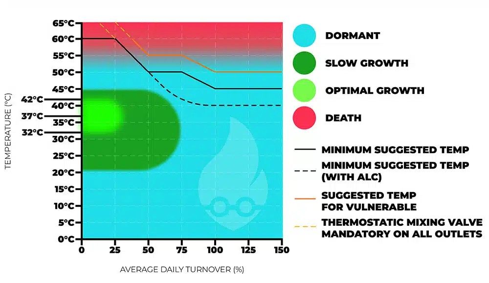

Keep well away from UFH as you will have a breeding ground for bugs in the warm space. Also who wants warm 'cold' water.
Legionella growth chart - UFH temps are the correct temperature for slow and optimal growth dependent on flow temperature.
So are you on the "cold side" of your insulation? As you say, would be good to keep well away from UFH even though our flow temps would be relatively low.
