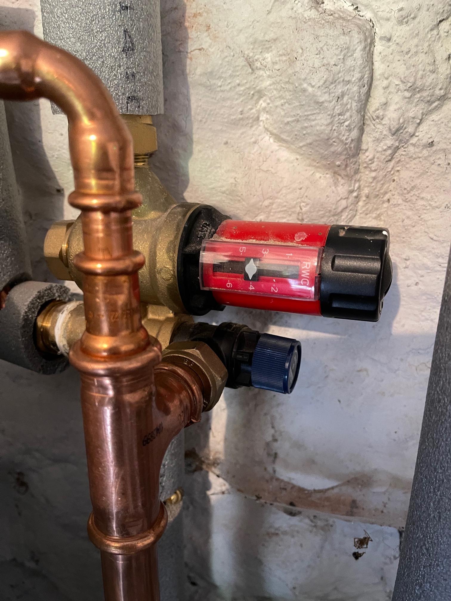

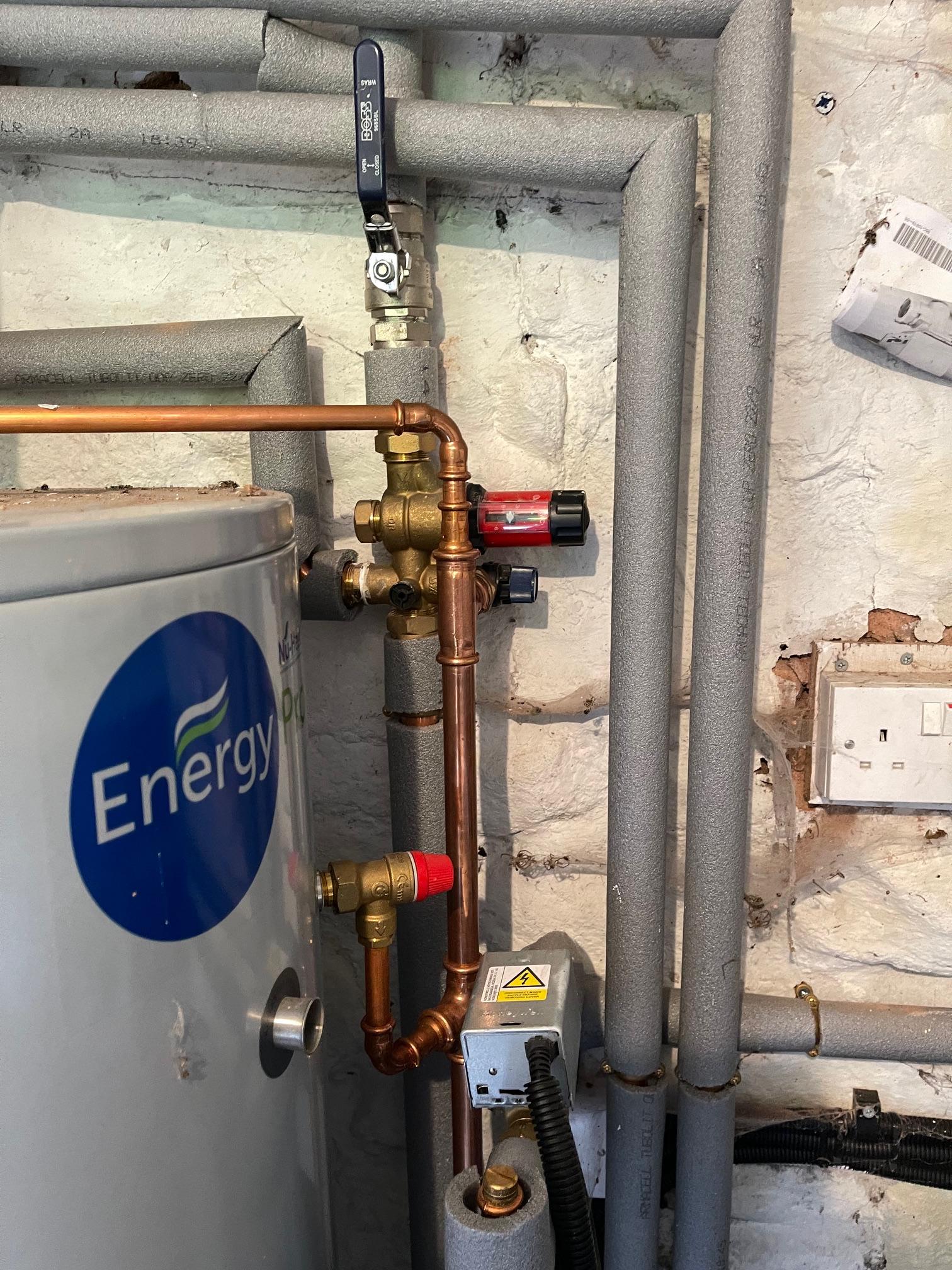

mousetarget Posted August 3, 2024 Author Posted August 3, 2024 It does sound like air in the system, the noise is just constant now it used to come on just 4-8 hours at a time. Don't know about air valves in the system as its totally new to us. It was only serviced 4 weeks ago, don't know about the buffer. We are real novices when it comes to this system, here are few photos of the system. The air/humming sounds seems to be coming from the red valve control area - any ideas so we can sleep tonight?
