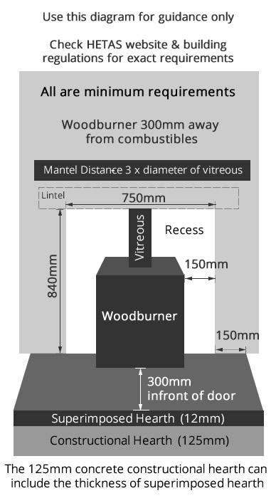

Rich2123 Posted July 31 Share Posted July 31 (edited) Hi guys. Has anyone got the up to date information for fitting a log burner. Just need to sizes to get cracking on mine. I’ve found this one if it’s correct. Also I’ve looked in the hetas website but couldn’t see anything Edited July 31 by Rich2123 Link to comment Share on other sites More sharing options...
ProDave Posted July 31 Share Posted July 31 Some things are particular to a particular stove and will be detailed in the instalatlion instructions, such as distance from the side or rear of the stove to combustible materials. Link to comment Share on other sites More sharing options...
Rich2123 Posted July 31 Author Share Posted July 31 Awesome so look for the fireplace and all will be on there? Link to comment Share on other sites More sharing options...
