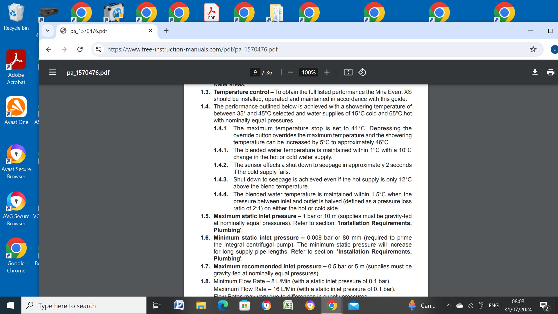

JohnMo Posted July 31, 2024 Share Posted July 31, 2024 8 hours ago, Sols said: Thermostatic power shower That's the bit that may may need sorting. Do you still have the pump fitted? Is your cylinder an unvented cylinder? A quick look on the Screwfix blurb for that shower, the first thing it says is "Suitable for Low Pressure Water Systems Only", the Q&A section states "The Event XS is a power shower so it requires a cold and hot feed from a gravity supply" if you now have an unvented cylinder you do not have a low pressure system any more. That will be your issue. Link to comment Share on other sites More sharing options...

PhilT Posted July 31, 2024 Share Posted July 31, 2024 check that all the gate valves (usually circular red wheel handles) are fully open, both around the domestic hot water tank and and loft tank, and if you don't have a loft tank then the Event XS will not work. Link to comment Share on other sites More sharing options...
