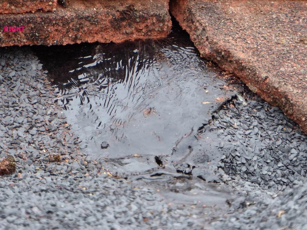

Recently had flat dormer roof covering replaced (new insulation, decking and felt layers).

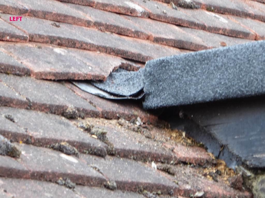

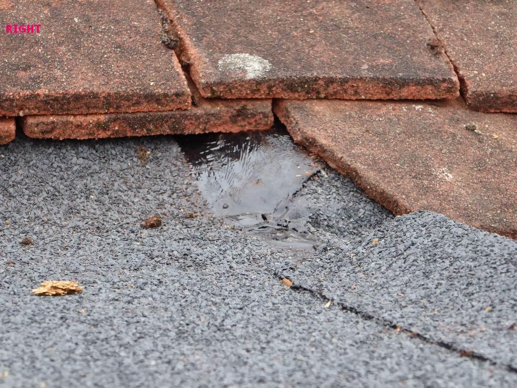

Having got up there and had a look I see two areas of possible concern with the works. Best illustrated by the attached photos.
In both cases the issue relates to the corners where the flat roof joins the main roof.

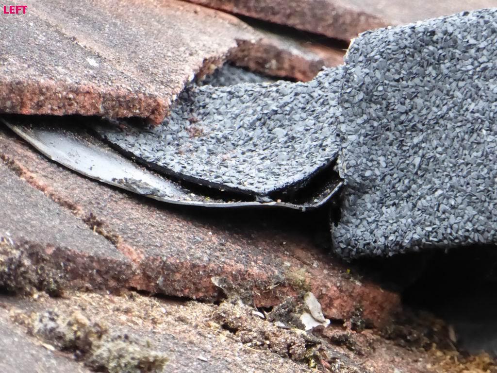

In the left one, the 'felt' seems to be lifting away from the lead that goes up under the tiles, plus the lead seems to be rather up in the air.
In the right one there is what appears to be exposed bitumen surface (selvedge?) - i.e. not covered by mineral granules.
Would appreciate any thoughts / observations.
Thanks,
Bazza

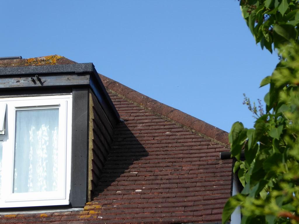

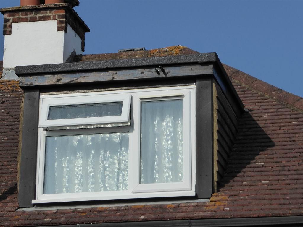

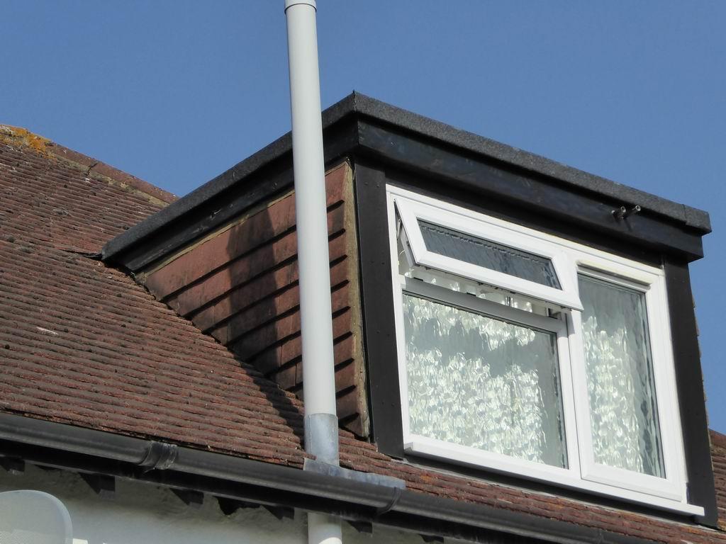

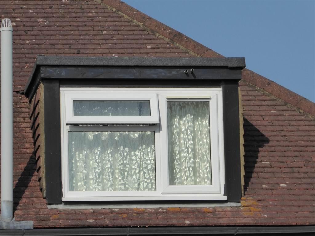

Hi @ Bazza
Any chance of photo a bit further away as well?
It helps to get an understanding of the general layout. personally I would like to see at least two foot al the way round to help understand how its meant to be.
Good luck
Marvin
Couple more photos taken at same time, but zoomed out a bit more. HTH.
Would have to get the ladders up again to do more.
And a few more photos giving the overall context. As is clear, the roof falls towards the rear and water runs off at the sides of the rear onto the meain roof.
