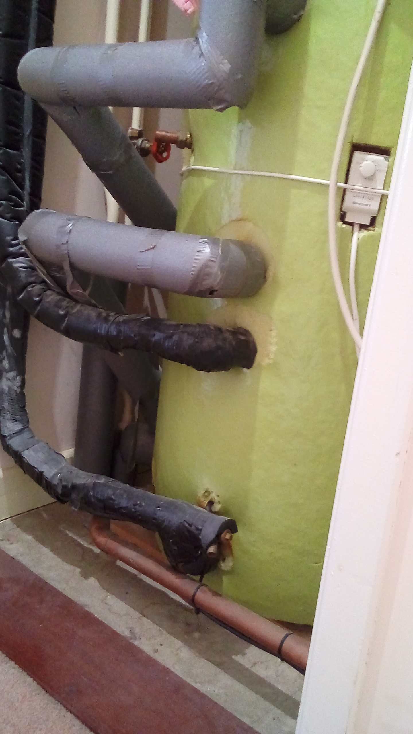

BobRK Posted August 20, 2024 Author Share Posted August 20, 2024 Hi JohnMo, Many thanks for your continued interest. Apologies for the long delay: holiday and family issues have taken up a lot of my time lately. Difficult to get a full view of my hot water tank due to the width of the landing. However, the photo shows (from the top) boiler feed, boiler return (both grey lagged), solar heating feed, solar heating return (both black lagged) and the copper cold water feed from the cold water storage tank. Just above the solar heating return is the black cable from the tank temperature sensor. NB: the white sensor to the right controls boiler. The solar heating pipes run horizontal for approximately 40 cm and then vertically up to the solar heating pump station. As mentioned previously there doesn't appear to be a non-return valve anywhere. The most convenient place to install a NRV would be in the vertical piping inside the airing cupboard but are such fitings available and would this be the best position to install them? Any further help/comments would be much appreciated. Thanks. Link to comment Share on other sites More sharing options...
JohnMo Posted August 20, 2024 Share Posted August 20, 2024 5 minutes ago, BobRK said: solar heating feed, solar heating return (both black lagged) Looks to me they would quite easily setup a thermosiphon. Can you replicate the dog leg as seen on the upper pipe in grey, so pipes drop about 150mm before going horizontal and upwards. A check valve may not fix it if remote. Link to comment Share on other sites More sharing options...
