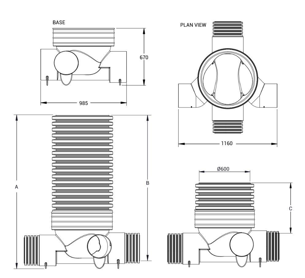

The first one, is an Accesso inspection chamber, the 2nd unknown as yet.

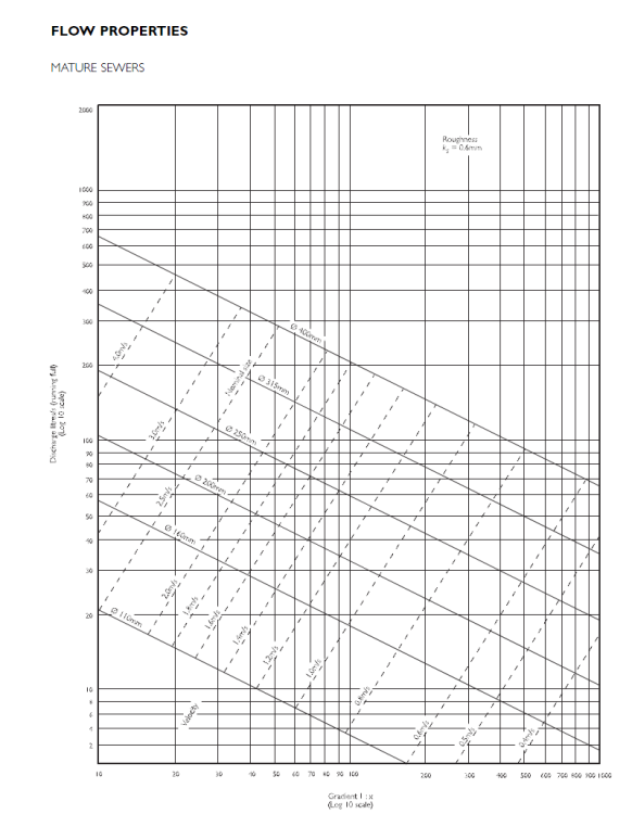

BTW in my twinwall travels I discovered this chart (below). The pipe is reputed to have an 1:80 gradient suggesting 1.8m/s & 150l/s. So, yeah, theoretically enough for 75 SuDS compliant houses if it was laid correctly and if the other houses used attenuation (they don't and one neighbour says it wasn't).

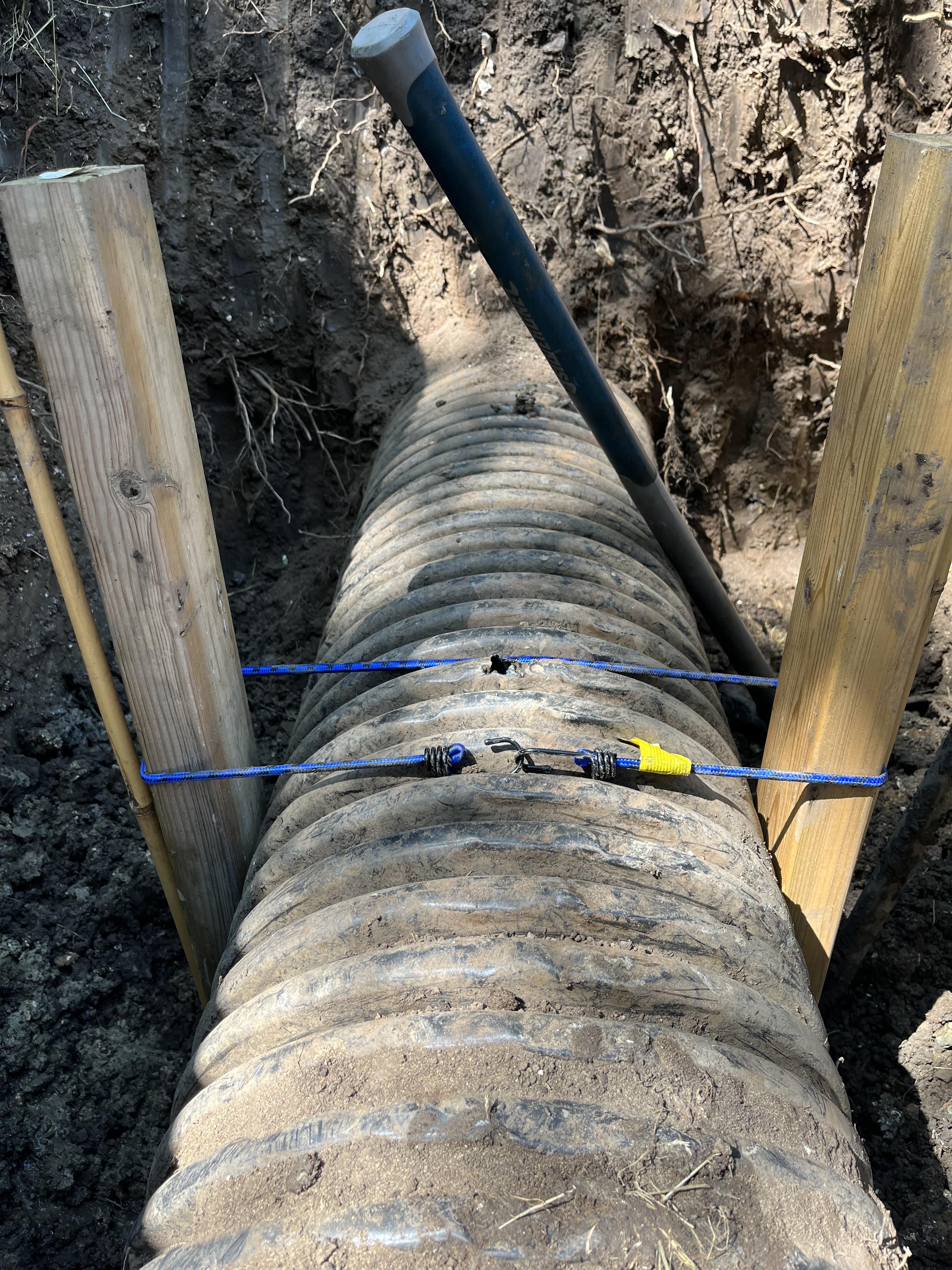

Ah, I've figured it out :). I did this kind of thing (straight bits of wood held on with bungees, measure above and below the pipe and average the numbers). Then same from side-to-side.
So, 373mm od side-to-side  and 336mm od vertically - so, tada, the pipe is a bit squashed and averaged again the overall diameter is ~354mm i.e. standard size OD for 300mm twinwall. It was the obviously bigger diameter seen from above that was putting me off.
Now all I have to do is fit the damn thing. BTW there are at least two suppliers of flexible rubber couplings & adaptors ... flexseal and VIPseal. You can pretty much attach any diameter to any somewhat-in-the-same-ballpark diameter. e.g.:
