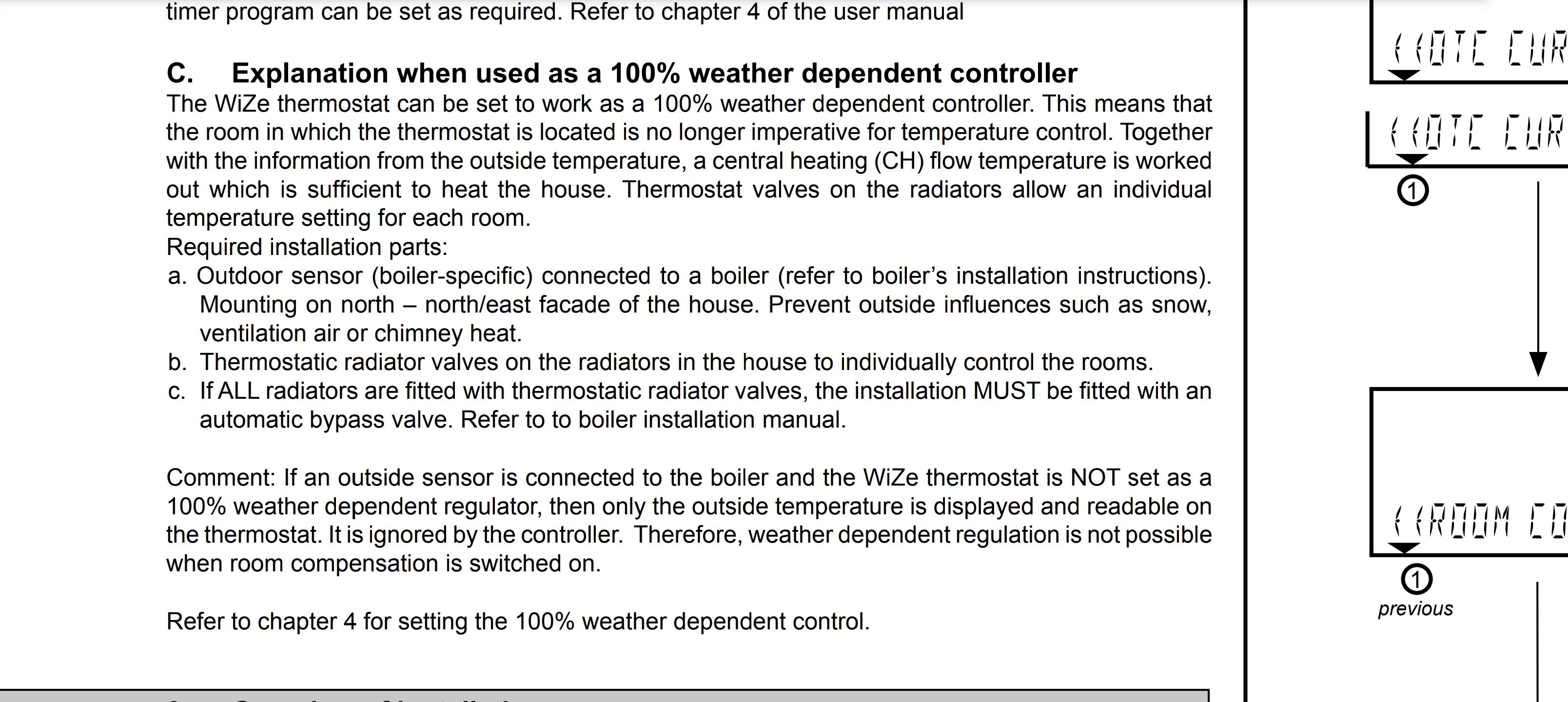

This is what my boiler manual says on the subject.
Screenshot_2024-07-22-09-25-50-89_e2d5b3f32b79de1d45acd1fad96fbb0f.thumb.jpg.3ff975e0d4ed5831057da219e0d91c25.jpg
