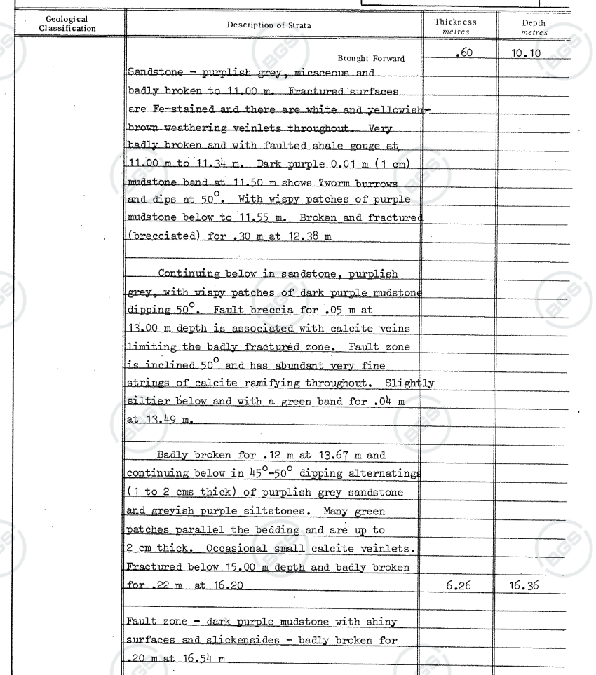

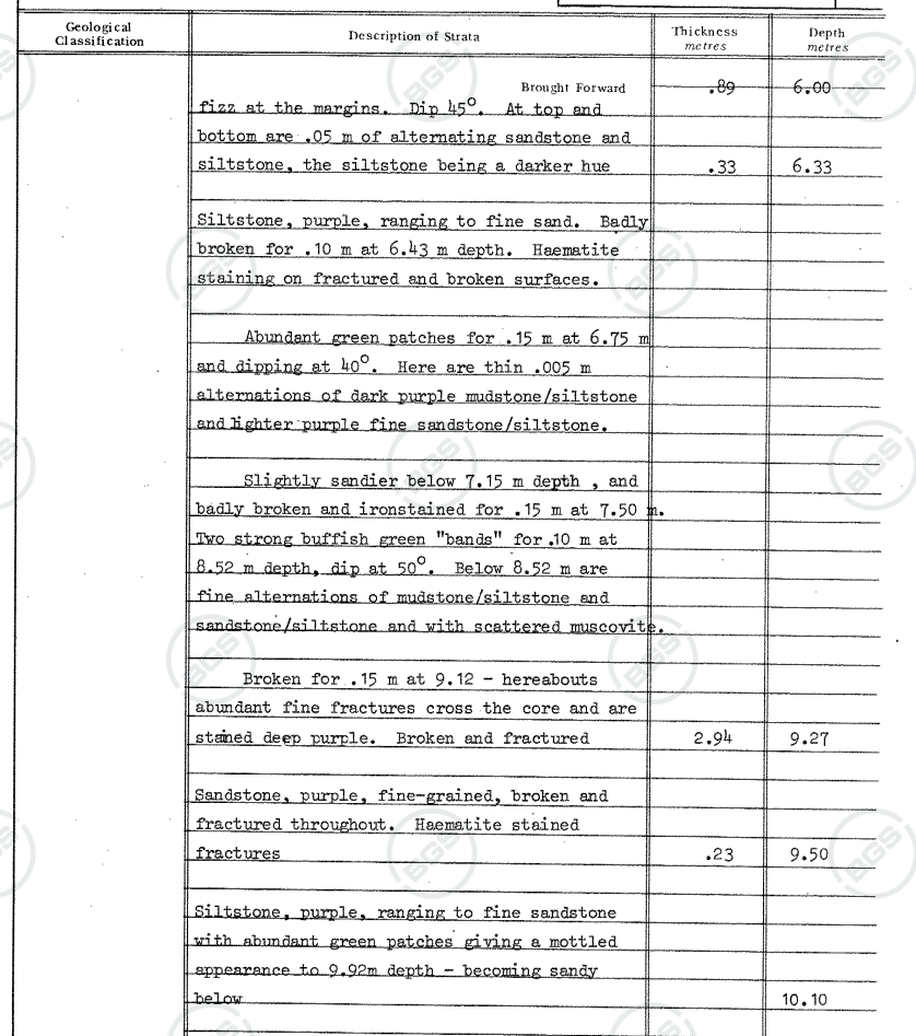

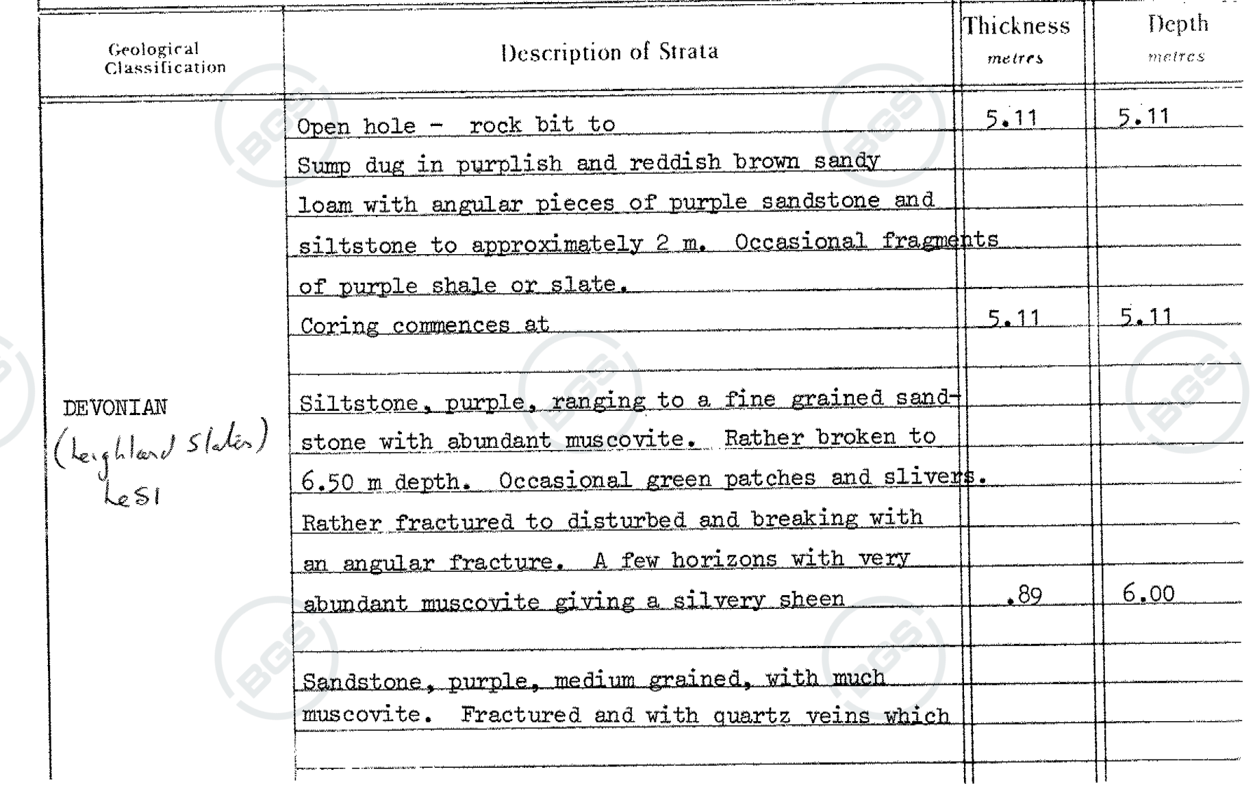

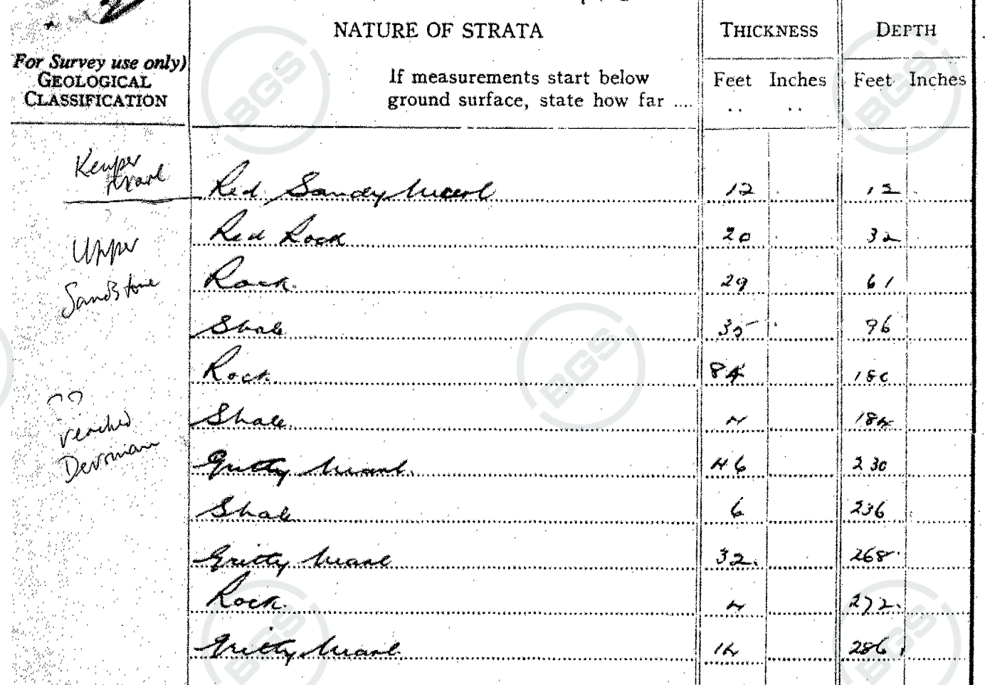

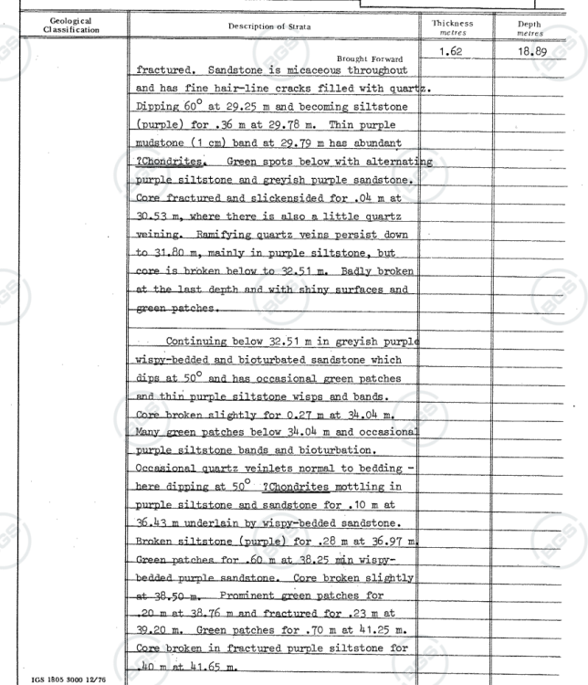

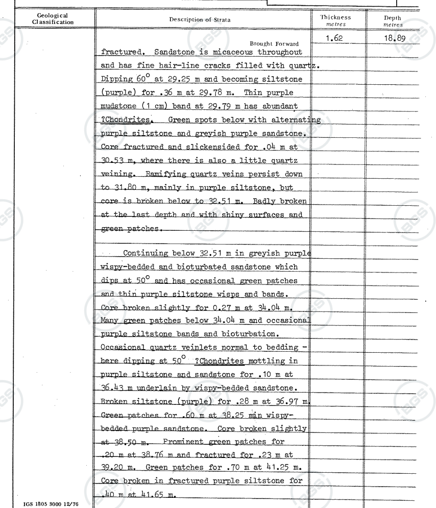

4) XX Drilling say a yes it would work at a depth of around 60m
I attach the area BGS survey borehole records, does anyone have any expertise in this area? Would be great to get some feedback as this looks like my only option for surface water soakaway since our perc tests have failed (clay soil), Highways have said no and won't even take a call from us and the Water company has said no as well to us discharging surface water into the foul soakaway. So I'm now totally up the creek without a paddle

Hi, reading back, did you ever have a soil investigation on your own site? I see the mention of sandstone on some of the records above and wonder whether there's any prospect of finding that? If you have a JCB, I think I might be inclined to dig the deepest hole I can in the extremities of the plot and look carefully at the spoil as it comes out. Anything remotely sandy may well signal success.
