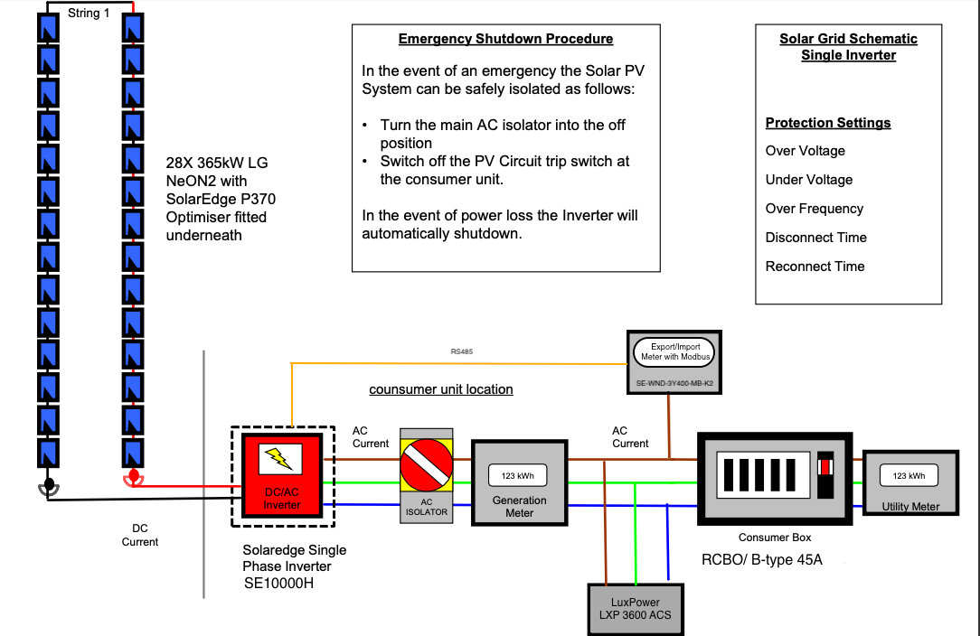

Thorfun Posted July 26 Author Share Posted July 26 update.....UKPN wouldn't accept the original application and so i went ahead and created a new application using their Smart Connect portal. The system consists of 28 x 375kW panels (10.5kWp) with a 10kW Solaredge inverter and a LuxPower LXP3600ACS AC coupled battery inverter. i had a response from them but i'm not sure i understand it and my sparky is currently unavailable! Quote Good Morning I am in receipt of the above mentioned project and wanted to inform you of your options. Having carried out the voltage rise calculations for the connection, a maximum of 10.25kVA is possible without any reinforcement works. You can either install 10.25kVA as per the above, or you can install the 13.6kVA you initially requested and limit the export amount to 10.25kVA via an export limiting scheme, the specification of which, I would need to see before sending you your approval Can you please confirm which option you wish to pursue, and in doing so, please return to me a revised A1 form clearly stating the details of the revised option detailed above? If you have any other queries, please do not hesitate to contact me isn't the export already limited to 10kVA due to the solaredge inverter? i didn't think batteries exported to the grid. if i do need an export limiting scheme is anyone able to give me a link to what i need to get to do it please? Link to comment Share on other sites More sharing options...
sharpener Posted July 26 Share Posted July 26 3 hours ago, Thorfun said: isn't the export already limited to 10kVA due to the solaredge inverter? i didn't think batteries exported to the grid. If either the Lux battery inverter cannot export at all or it can be set and locked to a zero export setting you need to reply with details of this and e.g. screen shots of the relevant settings, maybe this needs to be on a separate G100 Export Limit application, look up G100 on the UKPN web site. Then if you make a new application to export up to 10.25 kW they should grant it. This website is unfortunately not very helpful but the camelot forum has other Lux users I think, try there. If the Lux can't be restricted to no export then you are looking at third party equipment which can get expensive, or downrating your PV to the difference i.e. 6.65 kW. 1 Link to comment Share on other sites More sharing options...

Thorfun Posted July 26 Author Share Posted July 26 oh right! found this https://knowledge-center.solaredge.com/sites/kc/files/feed-in_limitation_application_note.pdf. think I get it now. the Solaredge Energy meter sends the import/export data to the inverter and within the actual inverter itself you set the export limit and so if export exceeds that limit then the inverter reduces the output from the inverter to ensure it remains under the export limit. seems pretty straight forward now I've done some research! Link to comment Share on other sites More sharing options...
Dillsue Posted July 26 Share Posted July 26 4 hours ago, Thorfun said: oh right! found this https://knowledge-center.solaredge.com/sites/kc/files/feed-in_limitation_application_note.pdf. think I get it now. the Solaredge Energy meter sends the import/export data to the inverter and within the actual inverter itself you set the export limit and so if export exceeds that limit then the inverter reduces the output from the inverter to ensure it remains under the export limit. seems pretty straight forward now I've done some research! That's it exactly. Check the inverter carries a G100 approval which I think it should. Hook up the energy meter and CT clamp to your supply cable and configure the inverter to your export limit. Technically, to be G100 compliant, the export limitation settings should be password protected by your installer to stop you as the user tinkering!! Link to comment Share on other sites More sharing options...
sharpener Posted July 26 Share Posted July 26 Depends on the topology. An external meter is definitely required if there are either loads or sources between the incoming grid and the AC connections to the inverter. If not perhaps its internal CT is sufficient (as in my Victron MultiPlus) if it has the necessary settings, the manual should tell you. The SolarEdge application note is definitely US in its flavour. Other meters to look at are the Carlo Gavazzi ET112 and the Eastron widely available in the UK with RS485 and maybe cheaper. Protocols vary, not always compatible with all inverters. Link to comment Share on other sites More sharing options...

Thorfun Posted Saturday at 13:57 Author Share Posted Saturday at 13:57 ok. update on this. my application was approved! now I need to supply commissioning documentation. they've asked for this: I'm ok with the 'As built Single line diagram/circuit diagram' as I already have this diagram which I think is what they're after (please correct me if I'm wrong!) Site layout and site location plans are fine as I can send the architects site plans with the head marked on them. my query is around does the above diagram show all the required protection settings that are needed for a G99 commissioning docs? I'm really hoping that I can simply send the above image and the site layout and location plans and be done with it! but I don't want to send in incorrect plans. can anyone who's been through this please assist with what's required here or if the above is all that's needed? 2 Link to comment Share on other sites More sharing options...
MikeSharp01 Posted Saturday at 17:00 Share Posted Saturday at 17:00 Think the import / export meter should be after the CU so it captures all the loads on the CU not just the inverter / battery combination on the edge of the properties consumption / export. 1 Link to comment Share on other sites More sharing options...
