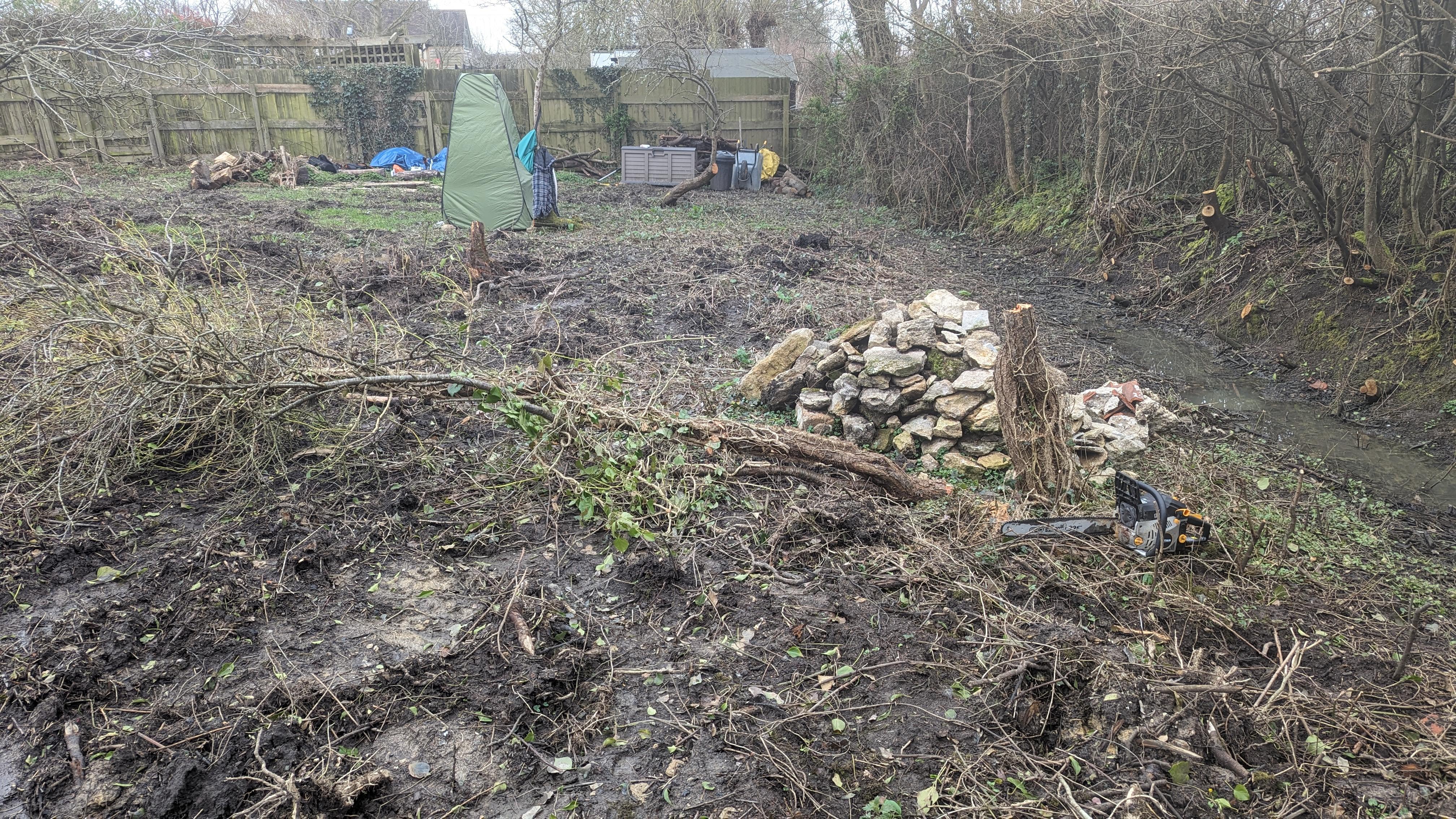

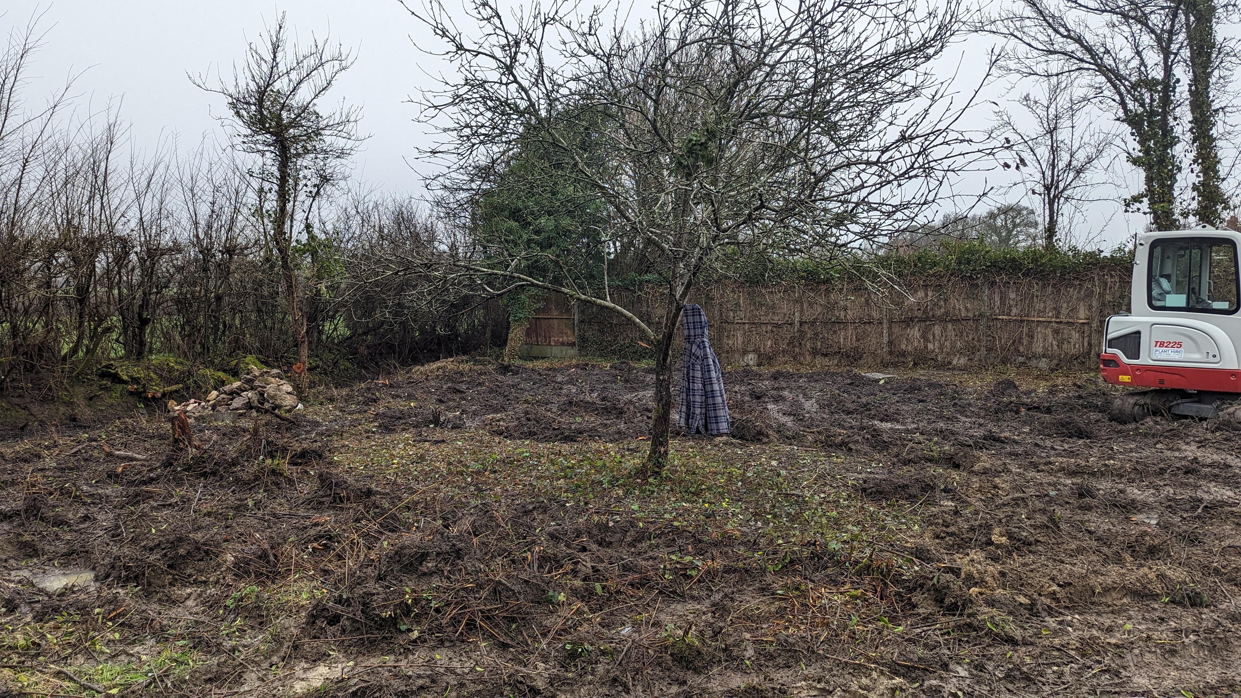

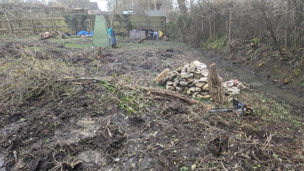

mjc55 Posted July 8 Author Share Posted July 8 This gives an idea of the ditch. The area on the left in front of the field boundary. I am going there today and will get a better picture. I suspect there may well be more water in there today after the rain of the last few days. Link to comment Share on other sites More sharing options...
mjc55 Posted July 8 Author Share Posted July 8 This was in March, you can see standing water in the ditch! Link to comment Share on other sites More sharing options...

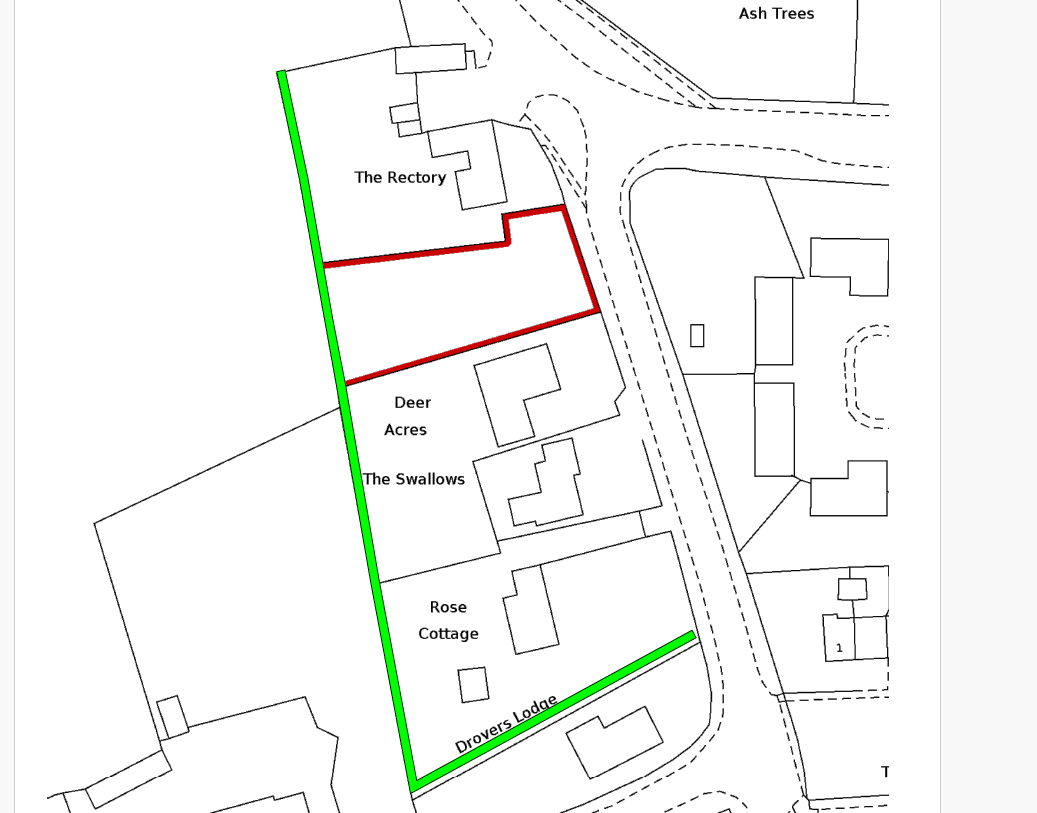

mjc55 Posted July 10 Author Share Posted July 10 Went over and spoke to neighbours a couple of days ago and the ditch runs all along behind the houses/land on the road, see below for sketch, green line is ditch. Link to comment Share on other sites More sharing options...
Alan Ambrose Posted July 10 Share Posted July 10 Well done. I would think there's a good chance the whole things drains downhill somewhere too. Always interesting to find out. I assume you didn't get any complaints / info about flooding since you didn't mention it. If not, then probably BC / EA will be OK with you draining rainwater to it. Maybe via an attenuation set-up of some kind - the latter depending on how much they're on top of SuDS / concerned about flooding. Link to comment Share on other sites More sharing options...
mjc55 Posted July 10 Author Share Posted July 10 4 hours ago, Alan Ambrose said: Well done. I would think there's a good chance the whole things drains downhill somewhere too. Always interesting to find out. I assume you didn't get any complaints / info about flooding since you didn't mention it. If not, then probably BC / EA will be OK with you draining rainwater to it. Maybe via an attenuation set-up of some kind - the latter depending on how much they're on top of SuDS / concerned about flooding. No complaints no. The chap in the house where the ditch runs behind and along to the road said that on occasion there is a bit of water at the back. Sometimes he does get water in the ditch that runs towards the road - at the end closest to road. Link to comment Share on other sites More sharing options...
