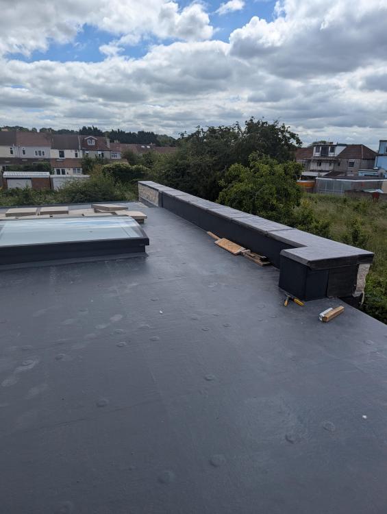

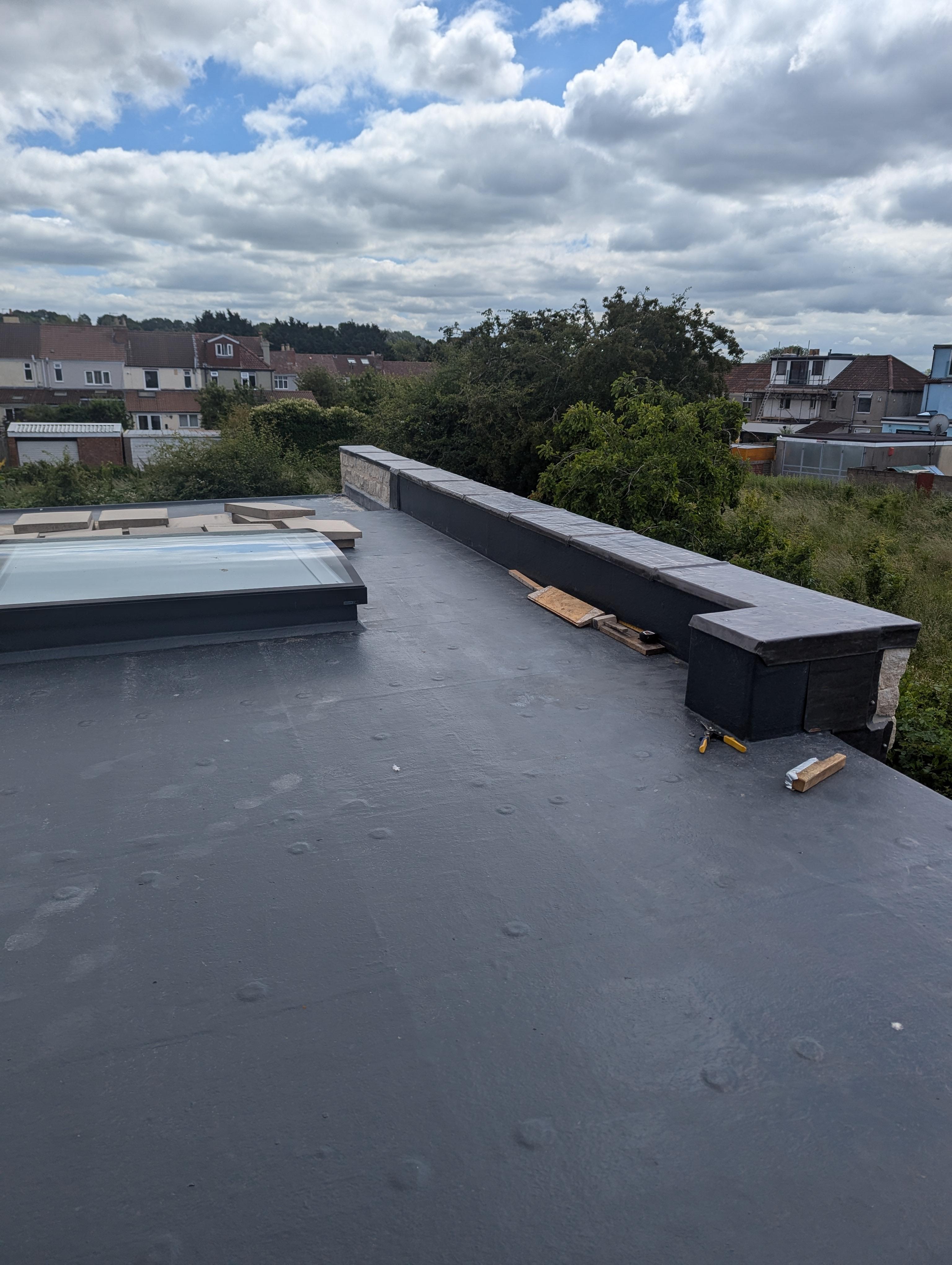

goodbyegti Posted July 5 Share Posted July 5 (edited) I have capped my parapet wall in code 5 lead. Under the lead I have building paper, osb3 and then a cavity tray with weep vents. To finish I have some cast concrete coping stones, which will give a 50mm overhang on both sides, with drip channels. I have GRP on one side, and surecav on the other. I am trying to make it leak proof for many years. Have I missing anything? To fit the coping stones, should I put a layer of bitumen paint, or silicone a DPC on? The main reason would be to prevent the cement reacting with the lead. But I was also thinking about thermal movement of the lead which the DPC could perhaps help with. For the mortar, would you go for a 3:1 mix as per NHBC guidelines? Is it worth putting fibres in, or some mesh? Edited July 5 by goodbyegti typo Link to comment Share on other sites More sharing options...
nod Posted July 5 Share Posted July 5 I simply lapped the fibreglass over the plywood’s that I’d fitted over the cavity Then laid the copings on mortar 1 Link to comment Share on other sites More sharing options...
Dave Jones Posted July 10 Share Posted July 10 dont put anything over that lead it looks great as it is. 1 Link to comment Share on other sites More sharing options...
goodbyegti Posted July 18 Author Share Posted July 18 Link to comment Share on other sites More sharing options...
goodbyegti Posted July 18 Author Share Posted July 18 Both good suggestions. GRP over the top would have given me a problem wrapping over the stone on the other side. I did like the lead on its own, but keen to get a drip channel on the coping to keep the water off the wall. In the end, I had some Resitrix primer left over, and that stuck to the lead nicely. So there's synthetic rubber between the mortar now. Probably overkill! Link to comment Share on other sites More sharing options...

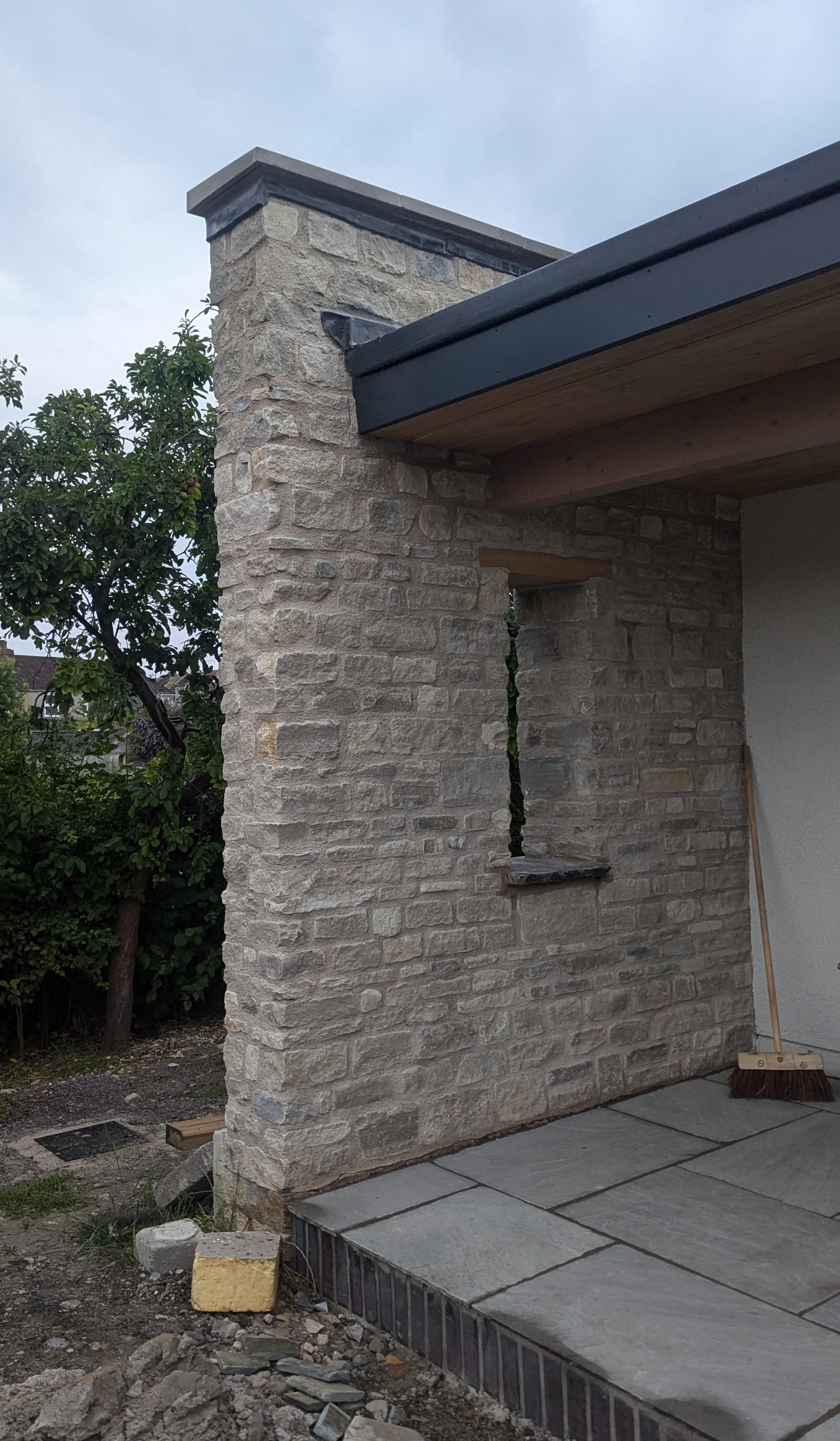

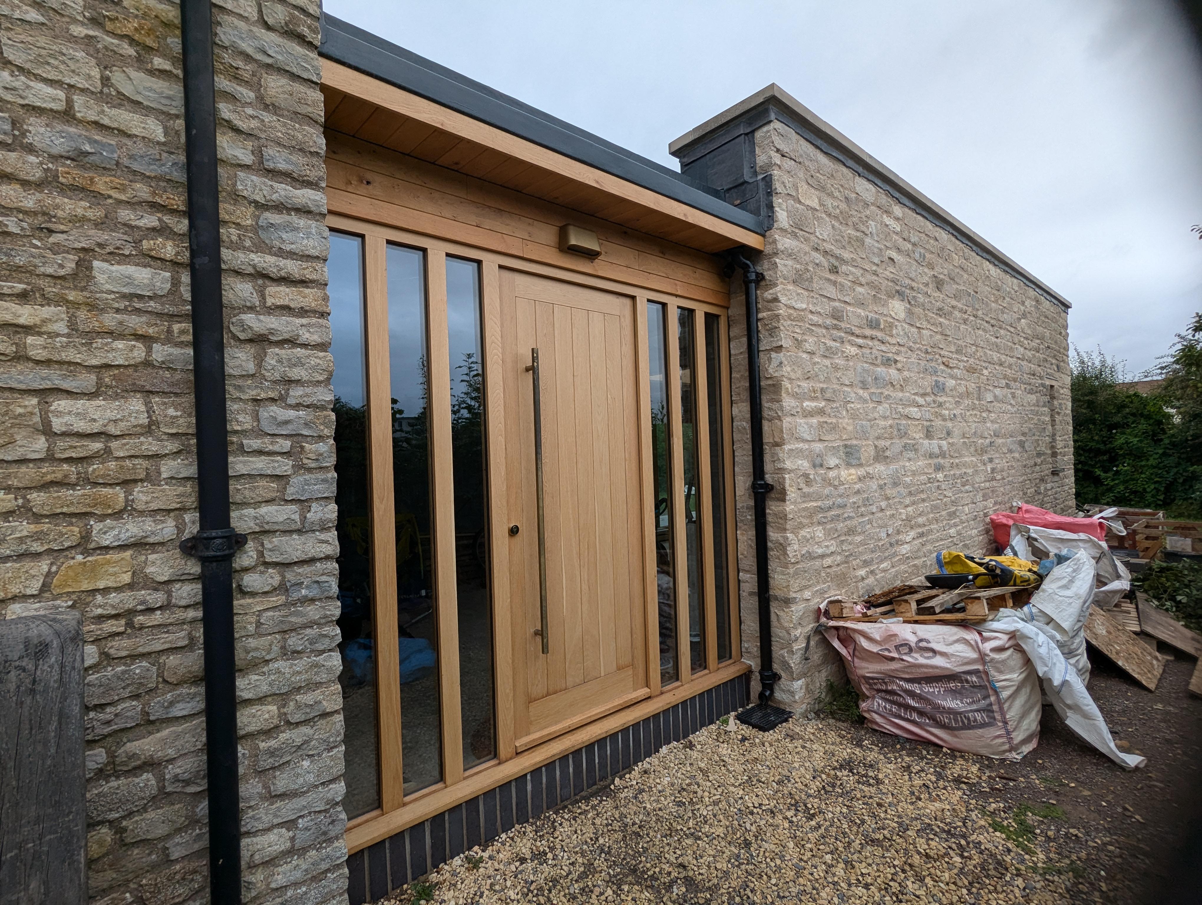

goodbyegti Posted July 18 Author Share Posted July 18 From the other side. Link to comment Share on other sites More sharing options...
