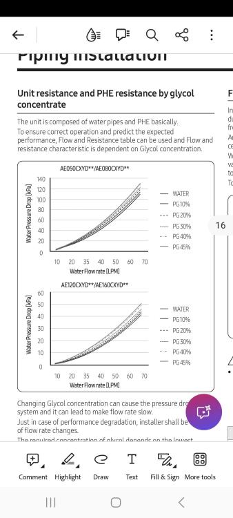

Barnboy Posted July 3, 2024 Author Share Posted July 3, 2024 (edited) I've looked over and over at this, the only ASHP instructions that I can find with a pressure loss graph are for Samsung as attached. Samsung instructions say 14.4ltrs/minute average so over a 24m flow and return, 12m each way run of 26mm internal I calculate a pressure loss of 0.008kpa and for 33mm internal pipe 0.003kpa using an online calculator, but looking at the Alpex graph it seems to showthe 26mm intetnal at 110pa/m = 0.11kpa/m = 2.64kpa/24m and for the 33mm internal, 30pa/m = 0.03kpa/m = = 0.72kpa/24m? Trying to workout the vertical section pressure loss I'm looking at 0.433psi per ft of head = 1.407psi/m = 2.814psi for the 2m you say that my 4m up,2m down each way equates to 19.405kpa. From my reading of the Samsung graph I can only have around 8/10kpa pressure drop, so whichever size pipe I use, the head pressure over kills my pressure drop allowance. Am I still going wrong somewhere or do I need to add in a 2nd pump, would this have an effect on my loss ? Edited July 3, 2024 by Barnboy Additions Link to comment Share on other sites More sharing options...
JohnMo Posted July 3, 2024 Share Posted July 3, 2024 Not sure where you pdi comes from work in imperial or more preferably metric and only metric units. Basically what goes up, must come down, so from head loss perspective they cancel each other out, but you still have the tube they cancel each other out. But don't Samsung use a pump supplied by you - as in it doesn't have a pump in the monobloc. So proper perspective, this is the pump head loss chart from my manual (with pump inside monobloc unit) So my duty point is 75kPa at 1m³/h. So on your case you have about 20kPa going through the ASHP and another 55kPa for your piping and heating system. Link to comment Share on other sites More sharing options...
Barnboy Posted July 3, 2024 Author Share Posted July 3, 2024 10 minutes ago, JohnMo said: So on your case you have about 20kPa going through the ASHP and another 55kPa for your piping and heating Where do you find these numbers ? Yes I believe the Samsumg requires an external pump, which I'll have to work out which pump fits the scheme at some point too. I'm just baffled by this, I've been trying to work it out for weeks so that I can order the required pipe but I can't make sense of it. Link to comment Share on other sites More sharing options...

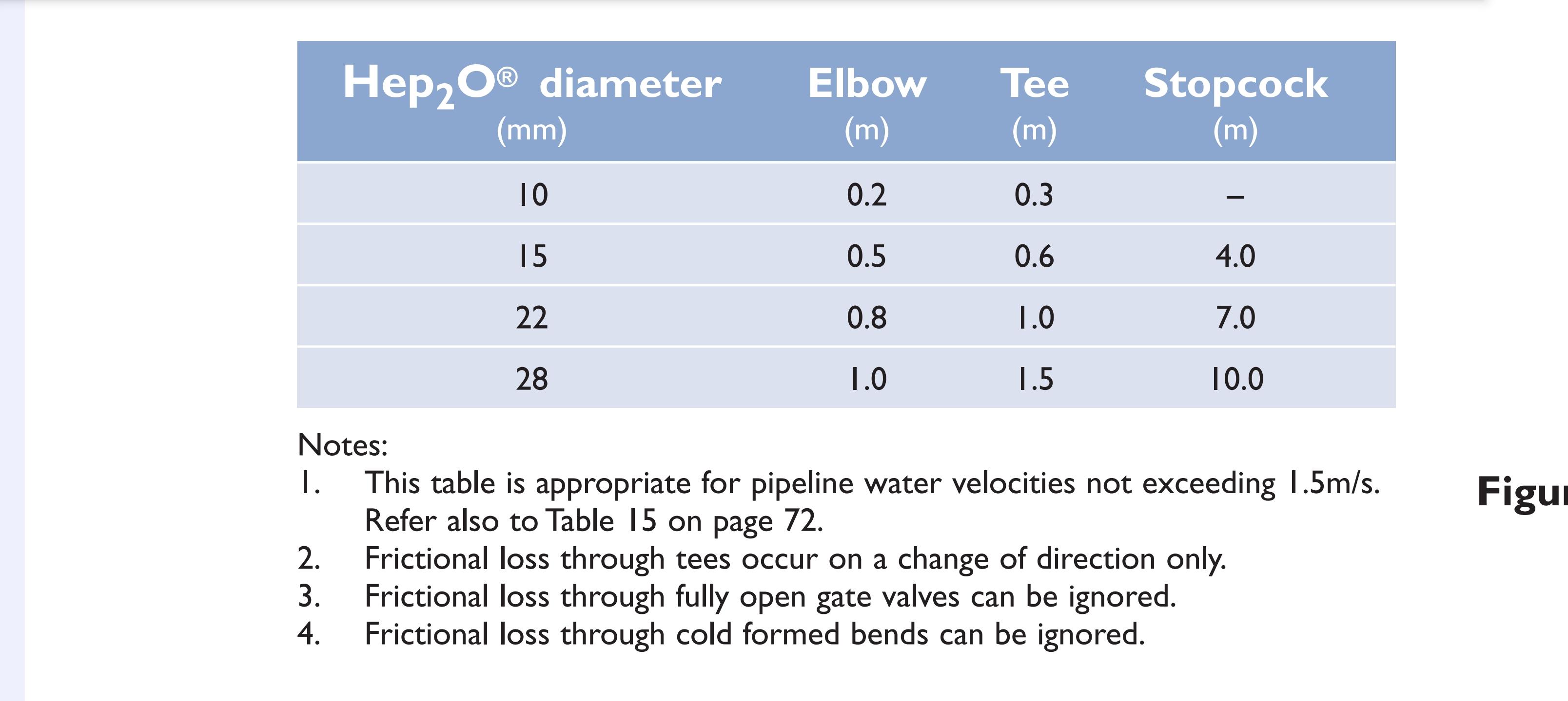

JohnMo Posted July 3, 2024 Share Posted July 3, 2024 28mm Hep2O at your flow rate is 2m head loss for 100m or about 19.5kPa. So 24m would be about 5kPa. Fittings add metres of head loss, a flow through tee adds no additional resistance Link to comment Share on other sites More sharing options...

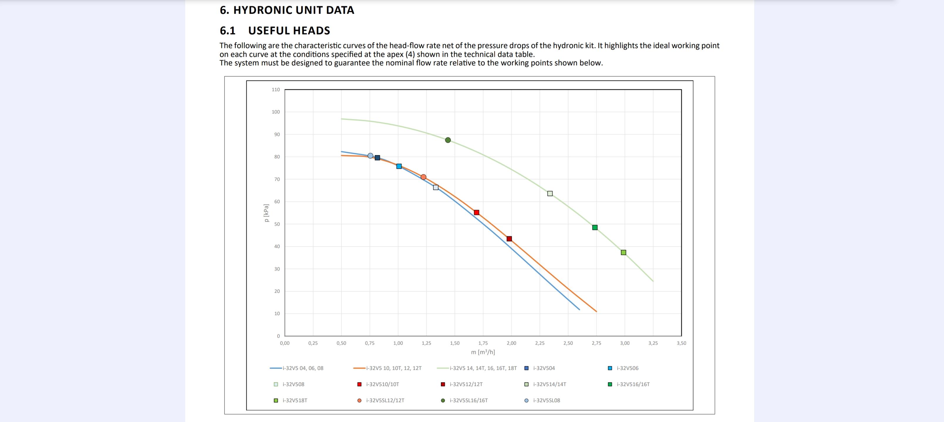

JohnMo Posted July 29, 2024 Share Posted July 29, 2024 8 hours ago, Barnboy said: narrows me to Mitsubishi, the WZ60VAA(BS) unit has the following data, That looks the right unit from mitsubishi. 8 hours ago, Barnboy said: They must all add up to something? A ball valve is just like open pipe when open, so no restrictions. Link to comment Share on other sites More sharing options...
Barnboy Posted July 29, 2024 Author Share Posted July 29, 2024 5 hours ago, JohnMo said: A ball valve is just like open pipe when open, so no restrictions But if a length of pipe has a pressure loss and so do fittings, surely any other unit, motorised valve, ball valve etc must give some pressure loss ? Link to comment Share on other sites More sharing options...
JohnMo Posted July 29, 2024 Share Posted July 29, 2024 1 hour ago, Barnboy said: But if a length of pipe has a pressure loss and so do fittings, surely any other unit, motorised valve, ball valve etc must give some pressure loss ? Ball valve just treat the same as a piece of pipe, if it's 100mm long just add that to the pipe length Diverter valves are different they have a pressure drop and some can be quite restrictive. Same for strainers and strainer ball valves. Think you maybe overthinking all this, you don't need to detail the last Pa drop in pressure. Aim for a reasonably low pressure drop. No gate valves, just ball valves for isolation, at least a 28mm diverter, a strainer, that's about all you have in the system. Keep everything simple. I would just plump the whole lot in either copper or Hep2O or a mix of the two, where it best suits the run. Copper tails on any compression joints, the transfer to Hep2O with a straight coupler. High points will need a bottle air trap to bleed air, just need a 28 by 15mm tee for that. Low points need a drain. If you want a low pressure drop diverter an ESBE is fine, I just use a Honeywell 28mm it's fine. Link to comment Share on other sites More sharing options...
Barnboy Posted July 29, 2024 Author Share Posted July 29, 2024 7 hours ago, JohnMo said: Think you maybe overthinking all this, you don't need to detail the last Pa drop in pressure. Aim for a reasonably low pressure drop. Story of my life, I overthink everything and then get overtaken by those who just wing it and get away with everything. Mitsi show their spec as a test flow rate of 17.2l/min, which os the top of their flow range, and pressure differences of 19kpa. My calculations using h2x software give me 4.95kpa for 32/26mmpipe and 1.59kpa for 40/33mm pipe @17.2l/min so I should be fine with the 32/26mm ? 40 only comes in 3mtr lengths where as 32 comes in a nice 50m roll, so no joints. Link to comment Share on other sites More sharing options...
Barnboy Posted July 30, 2024 Author Share Posted July 30, 2024 31/26mm Roll with 2x tee pieces to allow for air vents cones out complete at 5.15kpa. 40/33mm, 5mtr lengths with 2x tee pieces and 4x couplings comes out at 1.96kpa Both calculations are at the 17.2l/min velocity listed in the Ecodan paperwork which allows 19kpa. These are just the main run, so a little extra to add for motorised valves etc but at 3kpa difference I'm guessing that the 32/26mm should be OK? Link to comment Share on other sites More sharing options...

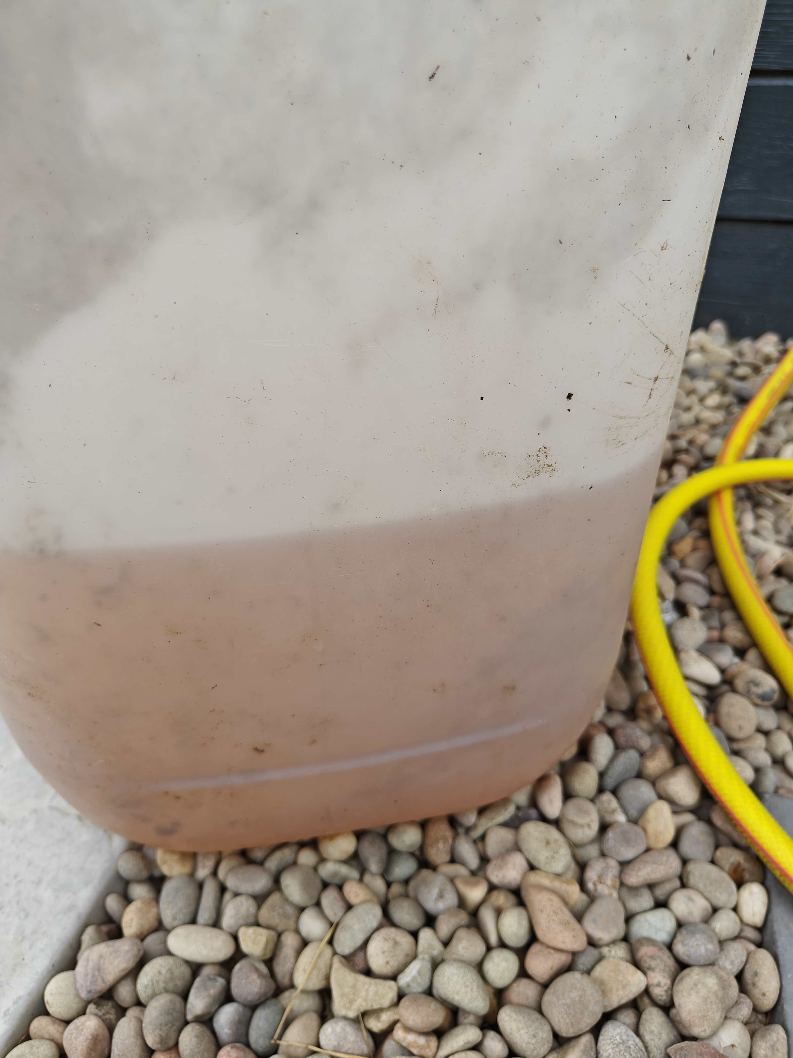

JohnMo Posted August 4, 2024 Share Posted August 4, 2024 8 minutes ago, Barnboy said: use as low resistance I have just taken out the glycol on my system and now using VDI2035 (straight water with testing). Without any other changes the water flow rate jumped from 1m³/h to 1.3m³/h. So glycol slows the system right down. 2 Link to comment Share on other sites More sharing options...

Barnboy Posted August 4, 2024 Author Share Posted August 4, 2024 14 hours ago, JohnMo said: have just taken out the glycol on my system and now using VDI2035 (straight water with testing). Is that water that you've tested until you've found a suitable source or deionized bottled water ? Link to comment Share on other sites More sharing options...
JohnMo Posted August 4, 2024 Share Posted August 4, 2024 38 minutes ago, Barnboy said: Is that water that you've tested until you've found a suitable source or deionized bottled water ? It tap water going through an Ion Exchange resin in a 10" filter housing. The water that came out was brown and although had glycol it has obviously had picked some corrosion from a carbon steel buffer I had in the system. The water circulating is correctly sitting at 168ppm dissolved solids and 341 micro seimens conductivity. pH is about 7.3, but this should move over time to about 8. Have a slip stream through the resin, setup which I am going to run again tomorrow for a few hours, the aim is to get the ppm down below 150. Link to comment Share on other sites More sharing options...
