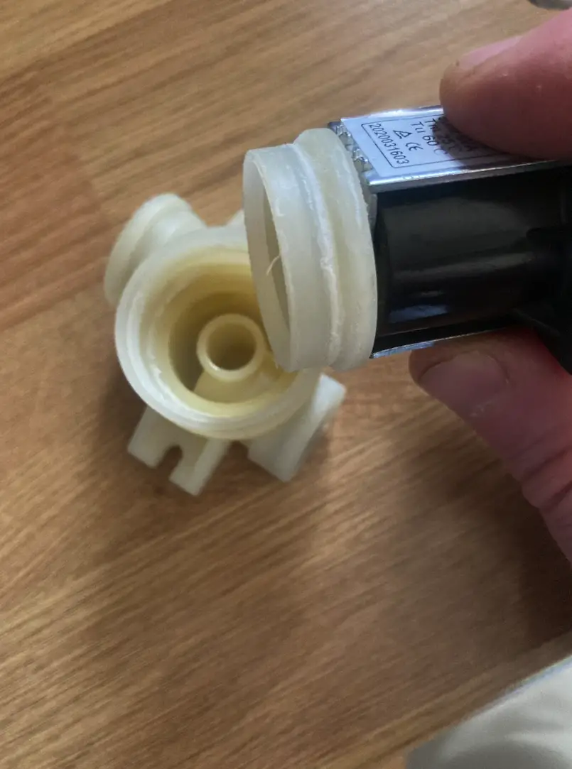

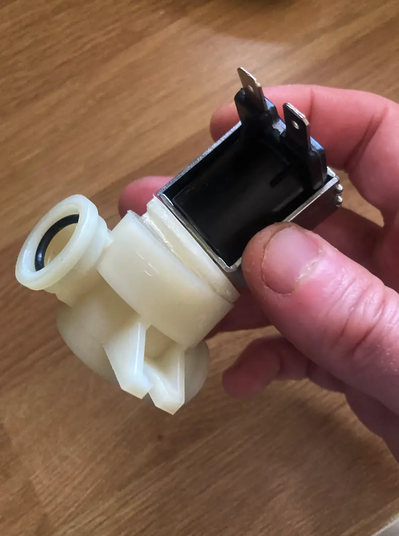

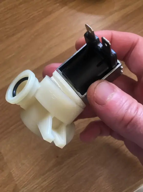

John Carroll Posted June 28, 2024 Posted June 28, 2024 Has anyone had a leakage problem with this type of solenoid assembly? these are probably used in other shower makes, the top body part is glued into the bottom part, below is one from someone on another site where the two pieces actually parted company with the shower off, these showers are designed for a static mains pressure of up to 10.0bar.
dpmiller Posted June 28, 2024 Posted June 28, 2024 some washing machine valves are similar. I've seen it a couple of times over the years. What kind of supply is it on, is there a pressure vessel and is it charged OK?
John Carroll Posted June 28, 2024 Author Posted June 28, 2024 Its just taken directly off the mains supply I believe but is only used very occasionally but wouldn't think that the pressure should be excessive.
dpmiller Posted June 29, 2024 Posted June 29, 2024 it's more about pulsations/ fluctuations. The glue/ weld may have embrittled over time too...
JohnMo Posted June 29, 2024 Posted June 29, 2024 23 hours ago, John Carroll said: below is one from someone on another site Do you have the full background to why it failed, things like after hammer, can easily exert enough energy to break things. Pipe stain can do similar. Age etc - Without the details all a bit meaningless. 1
