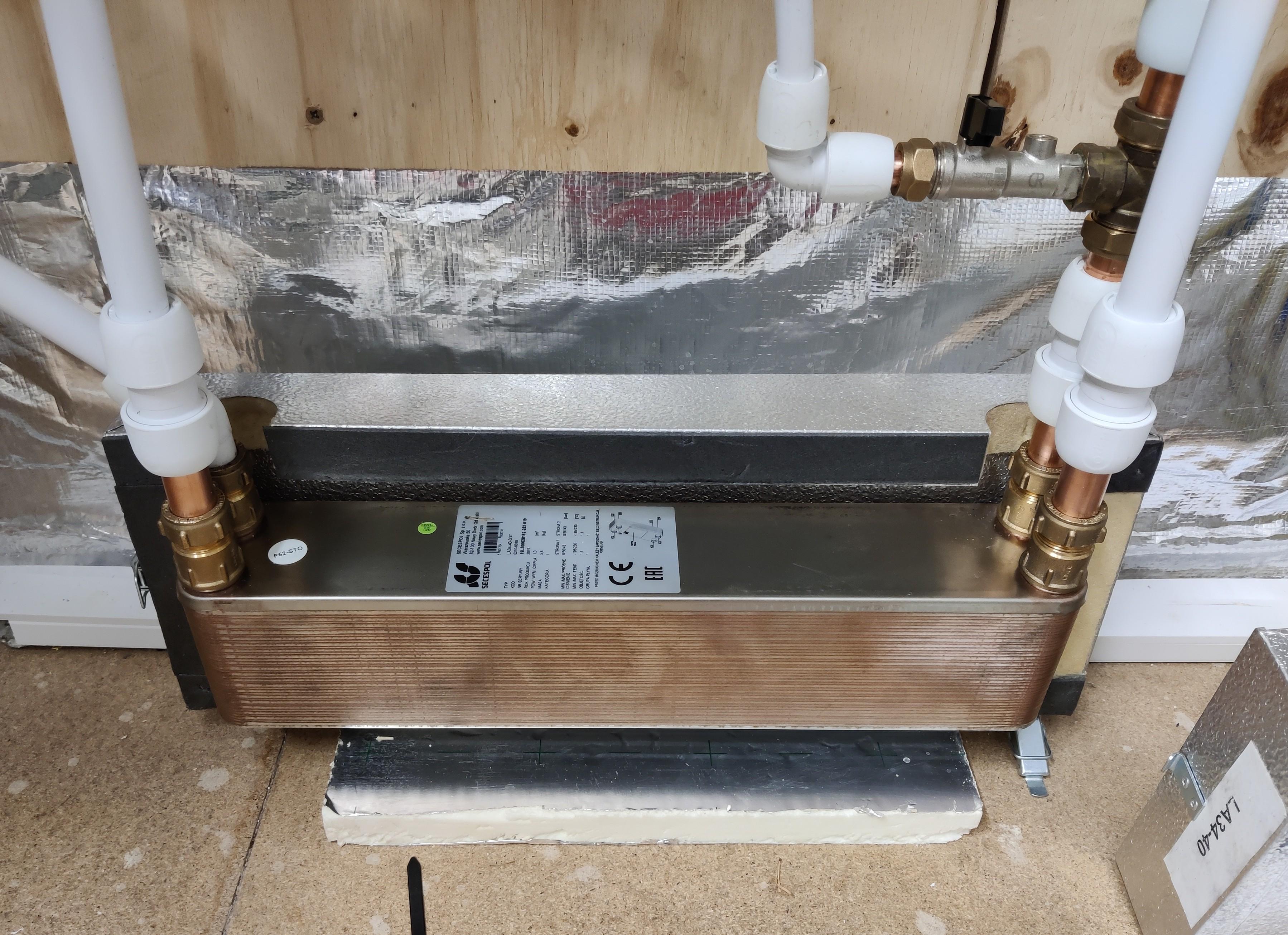

Phase one
Get hybrid hot water heating. Had a 40 plate PHE sitting doing nothing, so inserted in the flow line from the ASHP close to the UVC, the other side to combi boiler heating circuit. Set max flow temp to 60 on the gas boiler. I can change the rate at which the boiler adds heat (gradient), set to a max of 2 degs every minute. Initial run was all manually done to check concept.
With ASHP only the reheat time of the UVC is around 40 to 45 mins, with boiler engaged about 20 to 25 mins. During test, I monitoring the ASHP and gas boiler and both work well together, neither running away temperature wise.

PHE, boiler on left side ASHP on the right.

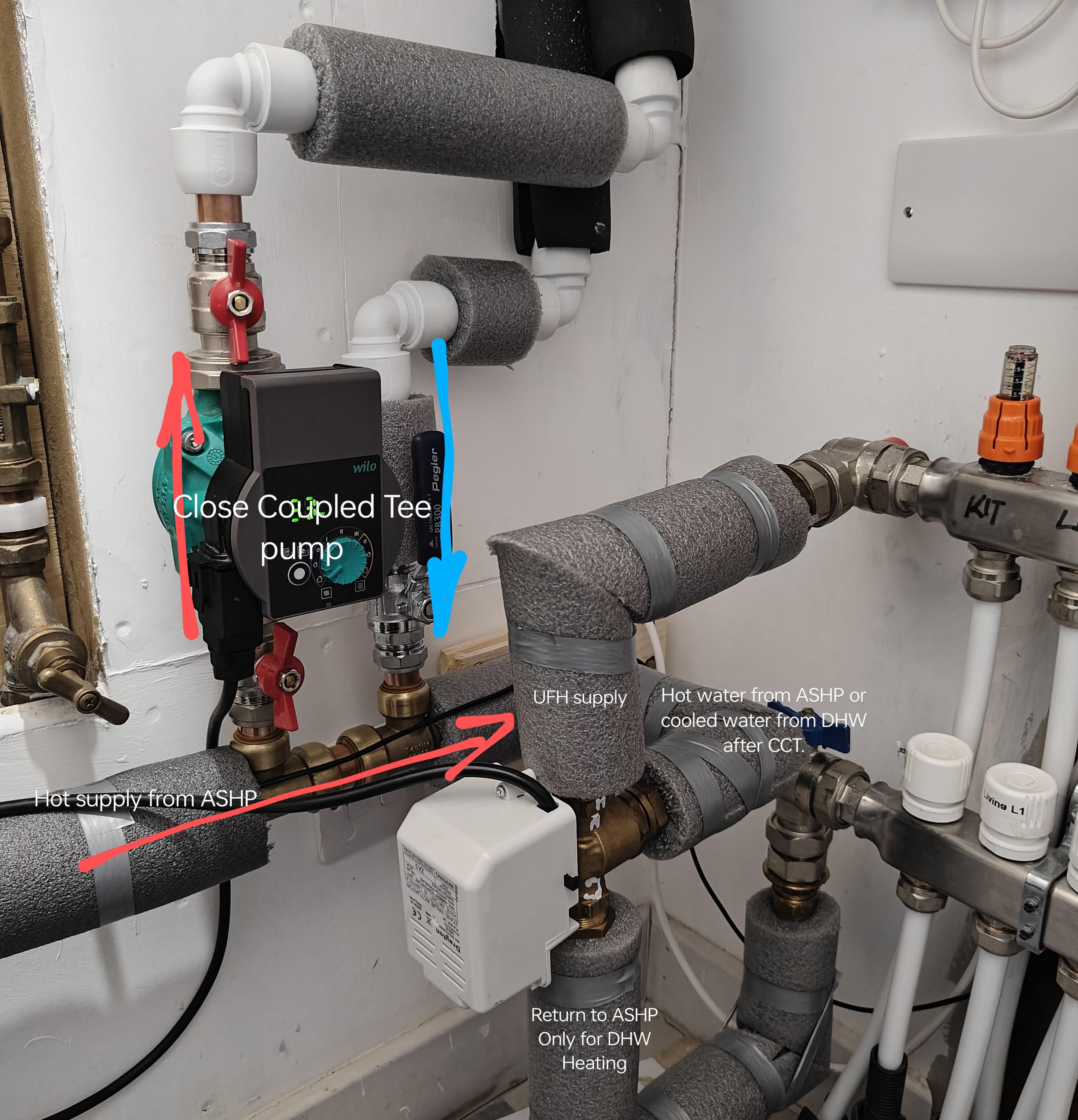

Phase 2, part 1
One issue that had me scratching my head was, how do I get the boiler, using only the central heating connections, to flow at two different temperatures one for DHW heating and the other for UFH. DHW set to 60 and UFH set to a max of 35. So using it priority hot water demand mode (PHWD).
Reading the installer manual for the boiler, it states weather compensation is only active when an outside sensor is attached. Meaning a set flow temp when not attached. So tried a resister (simulating 7 degs outside) on the outside temperature sensor connector. Connected boiler thinks it's 7 degs outside and disconnected nothing shows. So switching a resister in and out of circuit should give two different flow temperatures, by selecting an appropriate WC curve I should be able to flow at 35 degs for UFH and then 60 degs for DHW. So PHWD can be activated by switch in a resister (or outside sensor)
Controlling the resister switching in and out.
Shelly relay and a Shelly relay add on with temperature sensors was used. So the logic is quite simple.
Hybrid relay on and flow temp below 40 - the resistor is in line for low flow temperature. Hybrid relay on and above 40 degs - the resistor is taken out of circuit to enable high temperature flow for DHW heating.
Plumbing coming next
Phase 2, part 2,
Basic requirements are
1. single zone house and summer house,
2. no buffer
3. keep as simple as possible
4. no mixer or pump on UFH.
Original plumbing had a return booster pump from the UVC as piping was too small and long for the heat pump circulation pump alone.
This is the plumbing at the UFH. ASHP supplies hot water from the left to the CCT and pump and to a 3 port diverter.
Normal operation mode ASHP and hybrid mode for cylinder heating is exactly the same. DHW heating, ASHP puts a 230v signal out to move a three port valve. This supply is used to start CCT pump also. 3 port valve when energised opens lower port and closing upper port. This flow goes to the return back to ASHP teeing into the UFH return pipe. The CCT pump running takes hot water at the first tee and pushes it to the cylinder coil, via the PHE and cooled water comes back to the second tee, goes to the 3 port diverter and back to ASHP.

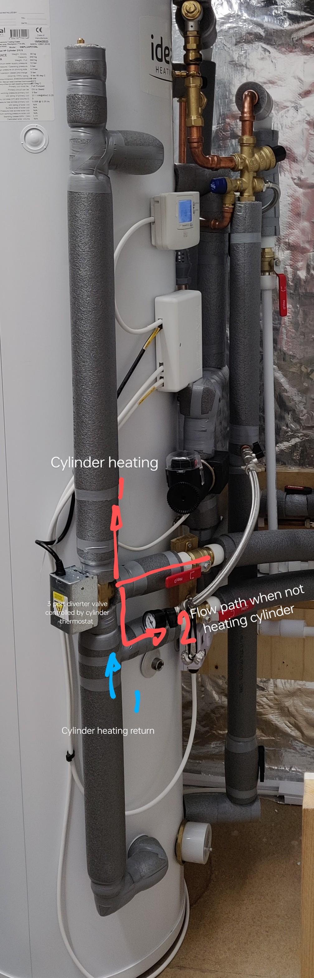

At the cylinder there is a second 3 port diverter. This is controlled by the cylinder thermostat. This diverter will be used in hybrid UFH mode.
UFH on, flow goes to 3 port valve (not energised), up and to top UFH rail, then out of the UFH to bottom rail and back to ASHP. No zone valves, pumps or mixers. The summer house is close to the ASHP and the flow to that is simply teed into the flow and return with 15mm Hep2O pipe.

CCT pump is started, warm water passes through PHE and is heated via boiler. The water then goes to the cylinder diverter (not energised) so by passes the cylinder and goes to the downstream tee at the CCT. This water flows through the UFH loops as normal just a bit warmer.
A few things needed to be added to make the above work
The 3 port diverter at the UFH and CCT pump needed to be electrical separated and controlled together and seperately. So on DHW heating both are energised, for hybrid UFH mode only the CCT is energised.
So power supply from ASHP now goes to a standard 8 pin relay. When energised the 3 port valve is energised and the CCT starts via separate circuits. A Shelly relay is energised when ever the ASHP hybrid Shelly is energised. This voltage by-passes the 8 pin relay powering the CCT pump directly.
