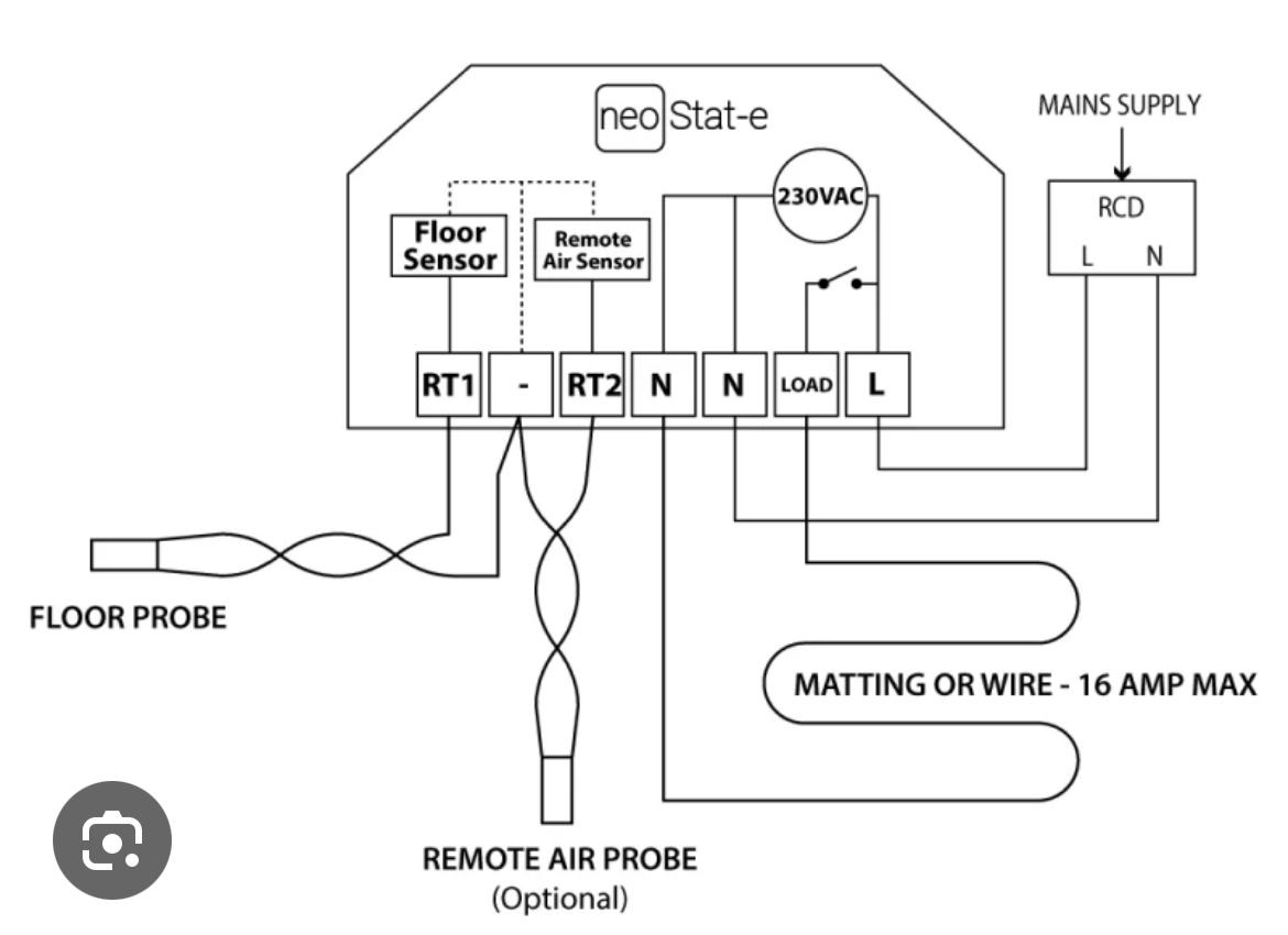

nod Posted June 7 Share Posted June 7 I’ve installed lots of Matt and tiled over them But never had anything to do with the wiring Has anyone a diagram to wire a Neo stat V2 to a warmup Matt Link to comment Share on other sites More sharing options...

nod Posted June 8 Author Share Posted June 8 8 hours ago, Kelvin said: I’ve just fitted one (cable type) I shall post the wiring diagram for it albeit it’s a Pro Warm thermostat but they are all much the same. Won’t be until Sunday though as currently camping. That would be a great help Kelvin Ive two wires and five terminals and don’t want to risk burning the Matt out before I’ve even tiled it Link to comment Share on other sites More sharing options...
Mattg4321 Posted June 8 Share Posted June 8 From the Heatmiser manual. I’ve wired in hundreds of them. Pretty simple. 1 Link to comment Share on other sites More sharing options...
