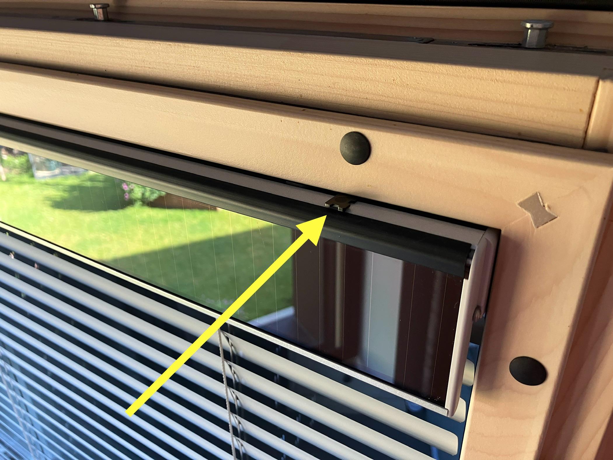

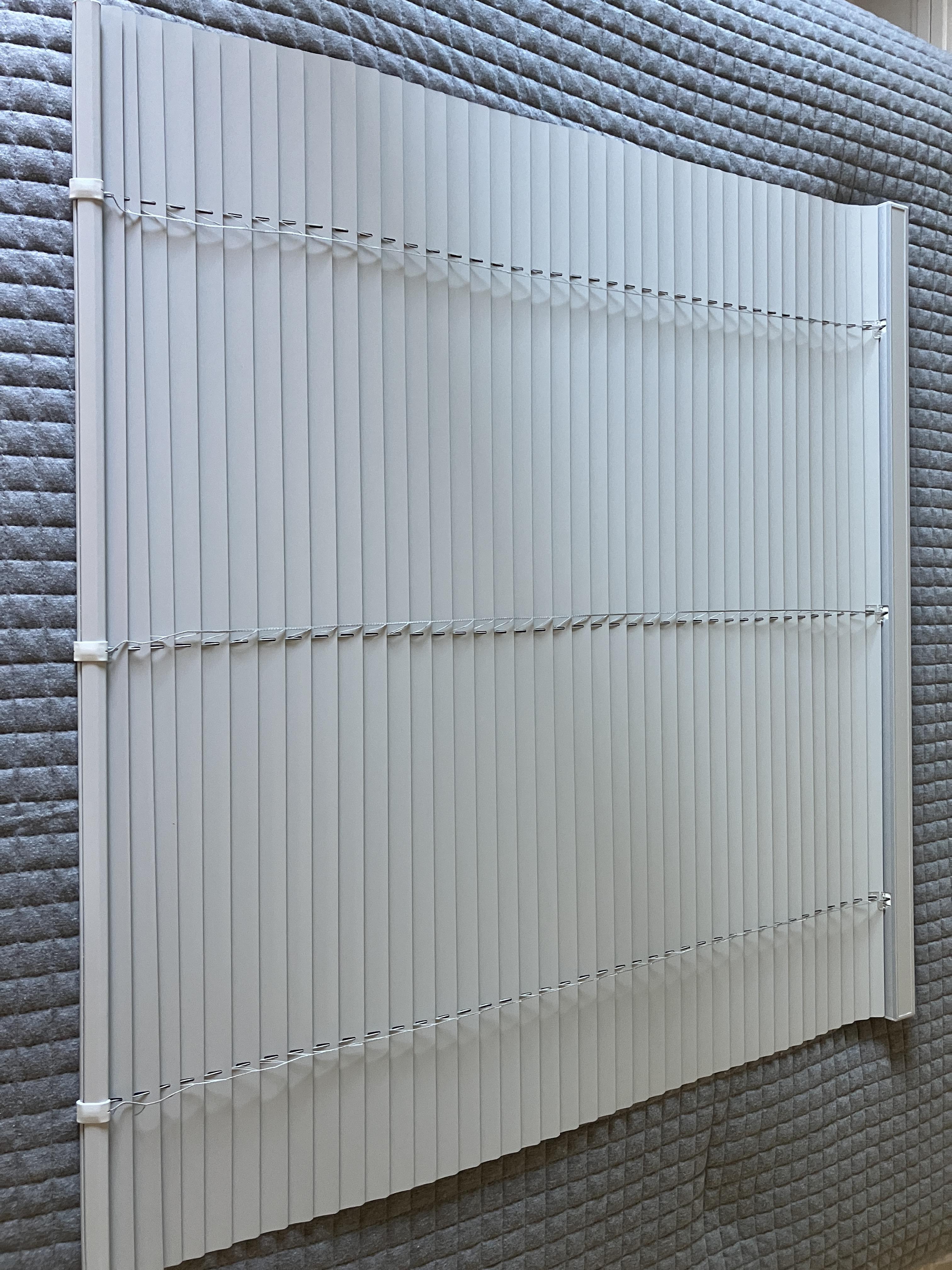

alexo Posted May 31, 2024 Share Posted May 31, 2024 Hi all, I’ve had Internorm windows fitted recently and have a few questions about them: 1) On the KV350 with integrated blinds, there are what look like black plastic corner protectors on all four corners of the outer window pane, glued on. On one of the windows one is missing and another has come loose. What are these and is not having them a problem? 2) One integrated blind is quite wonky. Is it possible to adjust this? If so how? 3) One KF410 window has water inside the bottom outer seal constantly. I notice there are drainage holes below this channel that does let water out. Is it normal for water to collect here? Pics attached. Thanks Link to comment Share on other sites More sharing options...
Russdl Posted May 31, 2024 Share Posted May 31, 2024 We have similar windows, may be the same, with the internal blind. 1. Those plastic bits look like transit protection, at least we certainly don’t have them, so I would have thought they should all have been removed. 2. It must be possible to adjust the blinds but I don’t know how and never had to, the instructions should give a clue. 3. The water, that’s got to be wrong as well, at least we’ve never had that. You need to go back to the supplier/installer and raise all these points for rectification, I’ve no doubt you paid good money for them and the sales of goods act says they should be free from minor defect. It doesn’t look like they are. Best check everything else while you’re at it, I suspect you have already. 1 Link to comment Share on other sites More sharing options...

craig Posted May 31, 2024 Share Posted May 31, 2024 From recollection they’re transport packers. Can’t help with blind adjustment unfortunately, one if the reasons we stay clear and keep to accessible items. I can’t see water issue clearly, need to get inside to see it but that ain’t happening for a few hours yet 😉 Link to comment Share on other sites More sharing options...

Russdl Posted May 31, 2024 Share Posted May 31, 2024 @alexo Regarding the blinds, can you open the outer leaf to access the blinds? Ours are effectively 4G. A triple glazed unit with a separately hinged outer pane of glazing that protects the external blind. Are yours the same? 1 Link to comment Share on other sites More sharing options...
alexo Posted May 31, 2024 Author Share Posted May 31, 2024 4 minutes ago, Russdl said: @alexo Regarding the blinds, can you open the outer leaf to access the blinds? Ours are effectively 4G. A triple glazed unit with a separately hinged outer pane of glazing that protects the external blind. Are yours the same? Yes ours are the same. I can access the blind but don’t see how to adjust it. Link to comment Share on other sites More sharing options...
Russdl Posted May 31, 2024 Share Posted May 31, 2024 I’ll have a look at ours in the morning see if I can figure anything out. 1 Link to comment Share on other sites More sharing options...

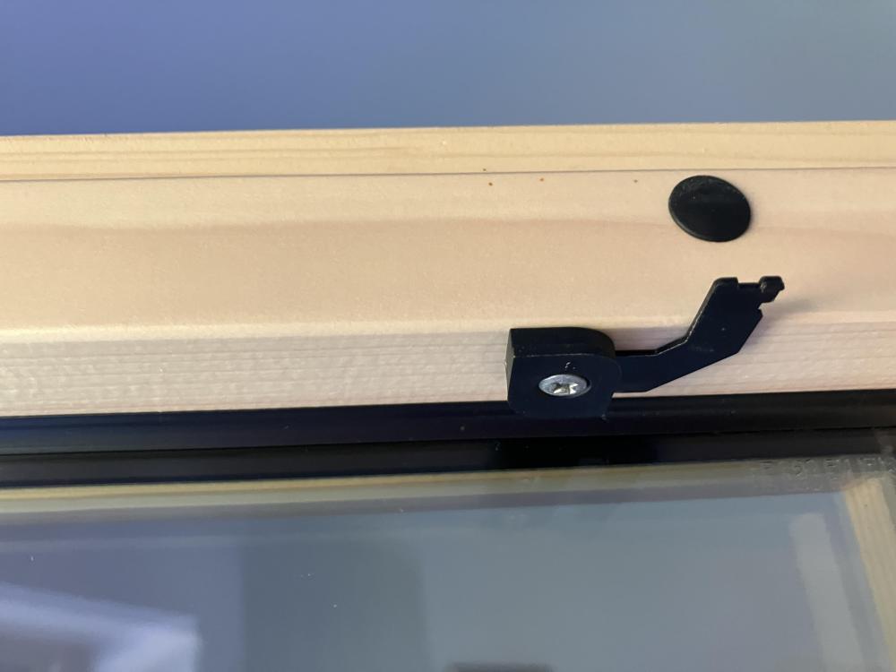

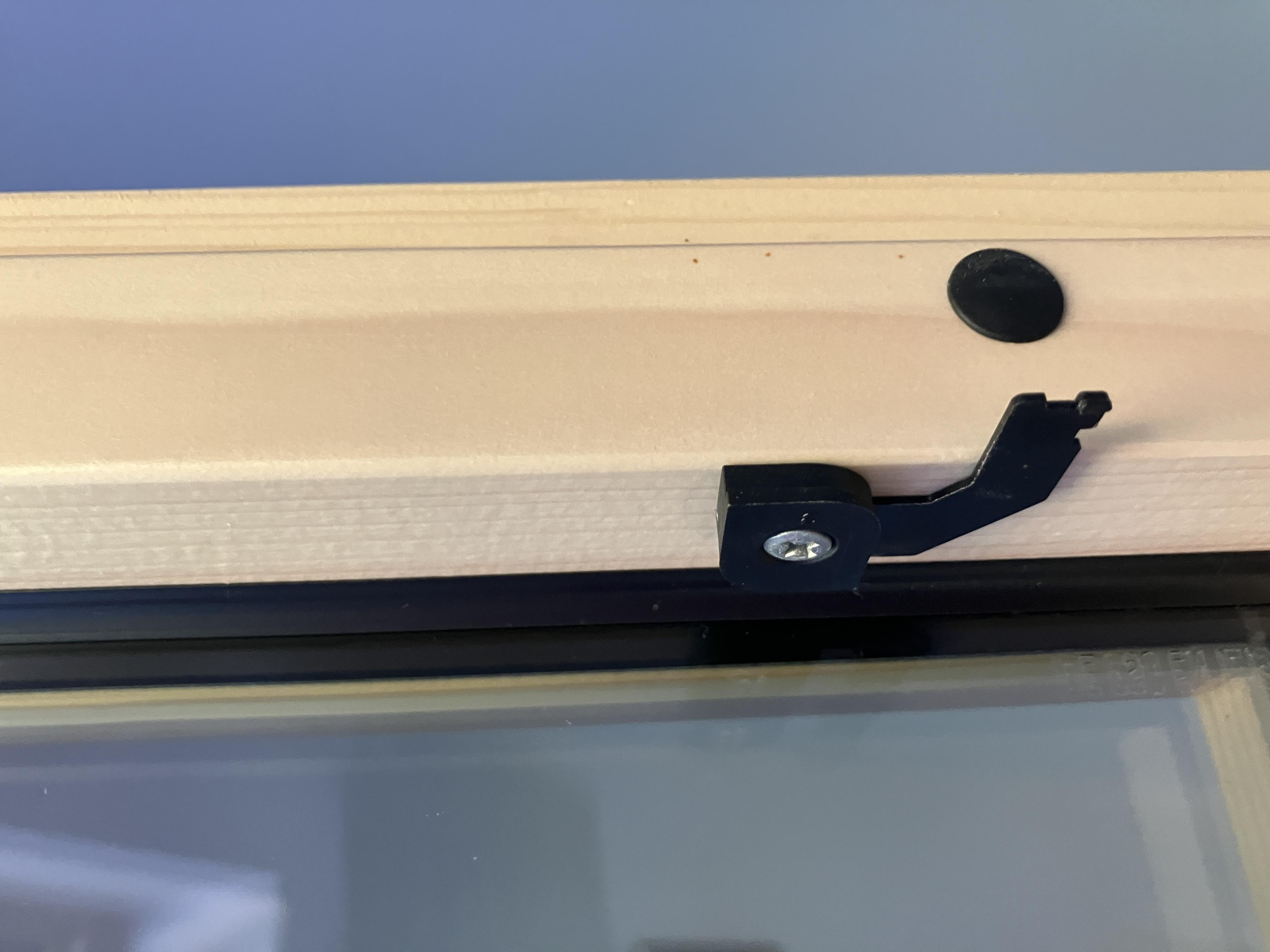

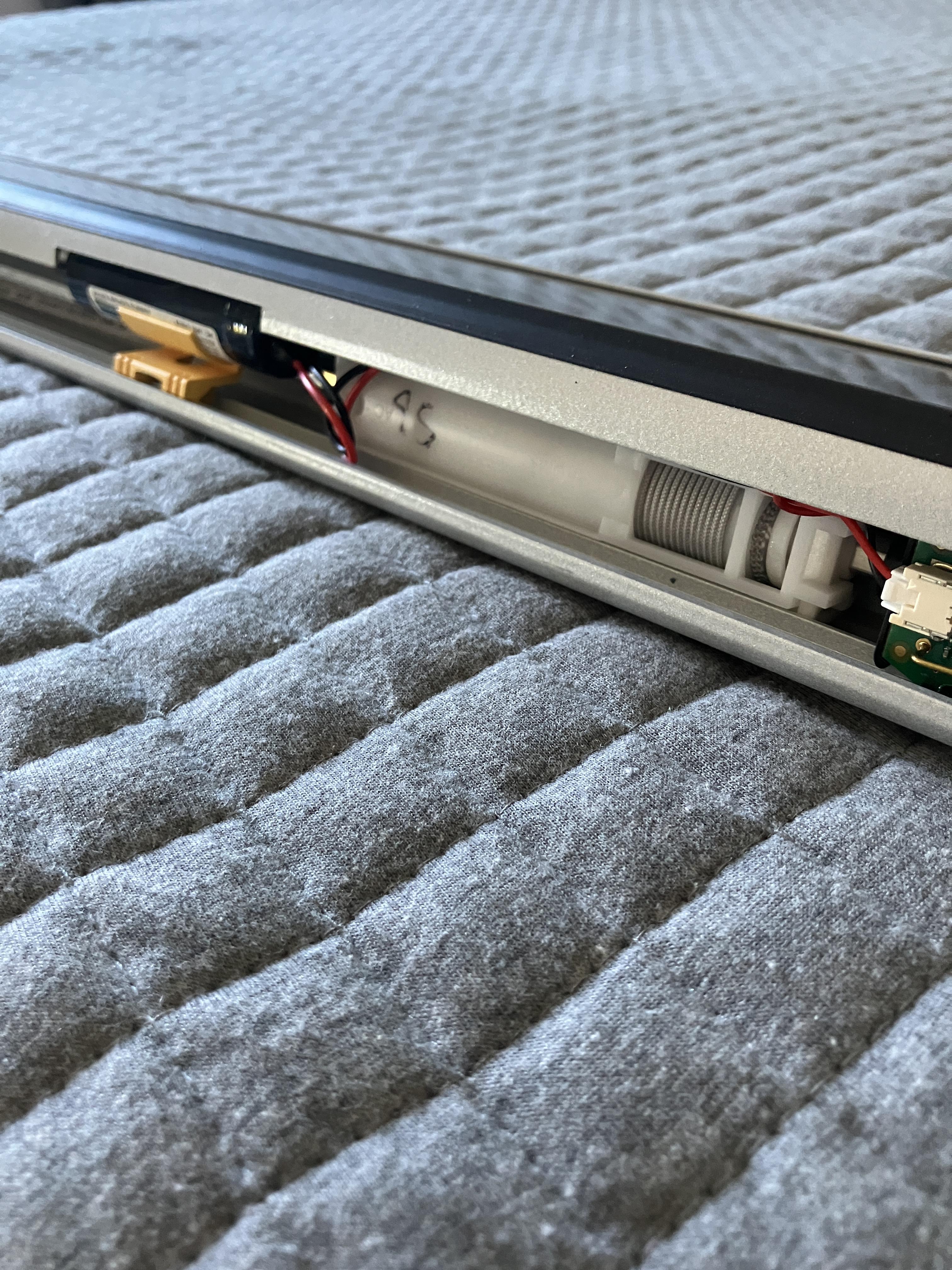

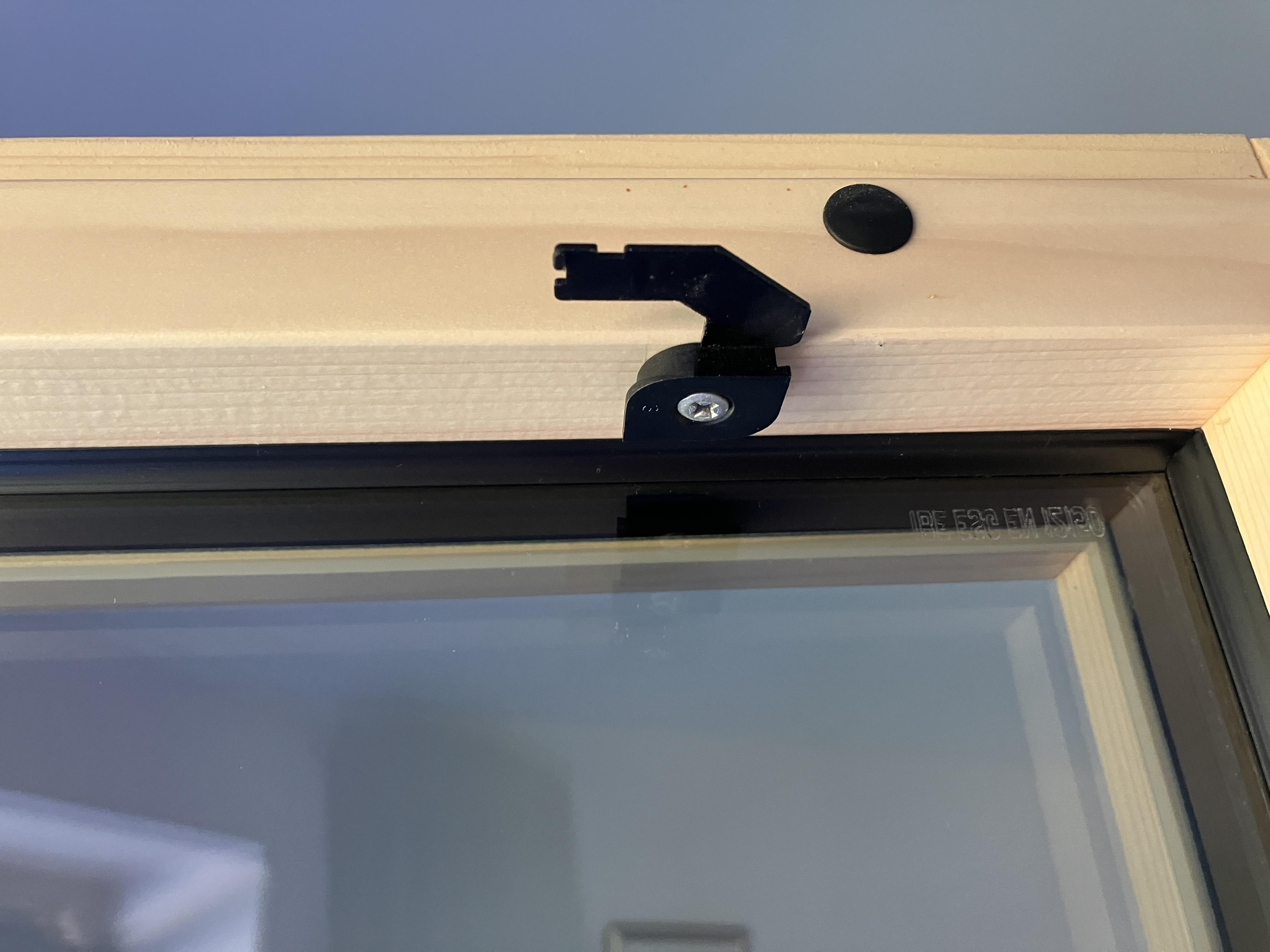

Russdl Posted June 1, 2024 Share Posted June 1, 2024 @alexo Sorry, I can’t figure out how to adjust the blinds (without too much experimentation that might screw ours up!) They do come out really easily though. If you want to take a closer look yourself. There are two black plastic catches that turn through 90 degrees to release the blind. Turn those towards the hinge side of the window and the blind plus motor/solar PV etc will drop out so be prepared to catch it! Here’s pictures of the catches in the locked and unlocked position. I can’t see where the adjustment would be, maybe someone will pipe up with a good idea. Where exactly is that water you’re talking about? Is it between the hinged pane and the 3G unit? 1 Link to comment Share on other sites More sharing options...
alexo Posted June 1, 2024 Author Share Posted June 1, 2024 17 minutes ago, Russdl said: @alexo Sorry, I can’t figure out how to adjust the blinds (without too much experimentation that might screw ours up!) They do come out really easily though. If you want to take a closer look yourself. There are two black plastic catches that turn through 90 degrees to release the blind. Turn those towards the hinge side of the window and the blind plus motor/solar PV etc will drop out so be prepared to catch it! Here’s pictures of the catches in the locked and unlocked position. I can’t see where the adjustment would be, maybe someone will pipe up with a good idea. Where exactly is that water you’re talking about? Is it between the hinged pane and the 3G unit? Thanks that’s really helpful. I should’ve said my blinds are Duette, not sure if the mechanism differs to Venetian. I will have a look and see if I can detach them in the same way. The water is on the standard tilt & turn KF410 not the ones with integrated blinds. Link to comment Share on other sites More sharing options...
Russdl Posted June 1, 2024 Share Posted June 1, 2024 It's a bit difficult to see exactly where that water is. If its inside the sealed glazing unit then that's a definite 'fail'. It looks more like its got behind the silicone that seals the glazing unit in the frame which to my mind is a definite 'fail' as well. That's what the silicone is there for, to stop water ingress. Link to comment Share on other sites More sharing options...

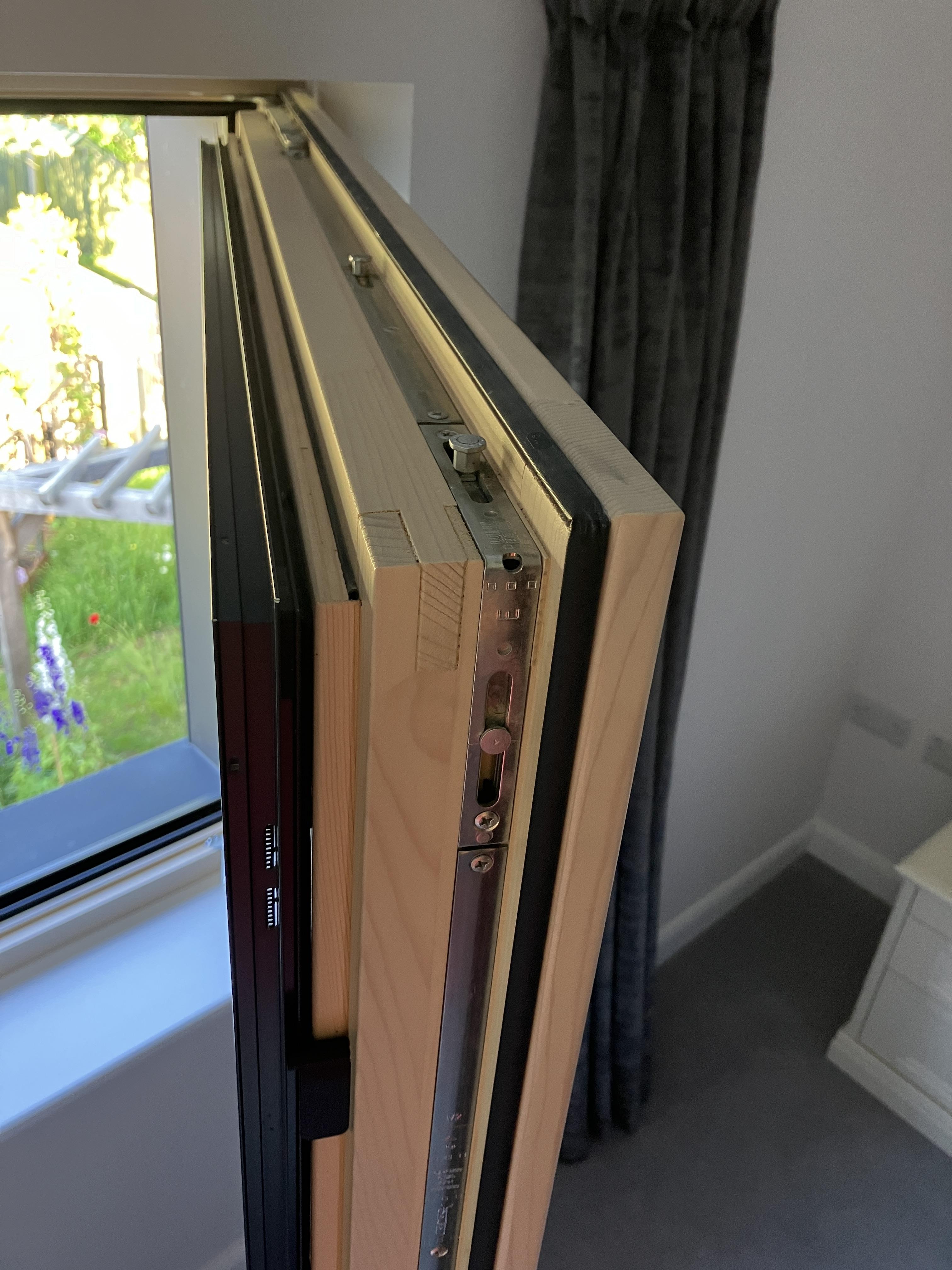

alexo Posted June 1, 2024 Author Share Posted June 1, 2024 31 minutes ago, Russdl said: It's a bit difficult to see exactly where that water is. If its inside the sealed glazing unit then that's a definite 'fail'. It looks more like its got behind the silicone that seals the glazing unit in the frame which to my mind is a definite 'fail' as well. That's what the silicone is there for, to stop water ingress. This picture might be clearer. The water doesn't appear to be within the glazing. It's between the glazing and the outer rubber seal, where there is a drainage hole underneath if you open the window, pictured. Link to comment Share on other sites More sharing options...

Meabh Posted June 1, 2024 Share Posted June 1, 2024 10 hours ago, alexo said: This picture might be clearer. The water doesn't appear to be within the glazing. It's between the glazing and the outer rubber seal, where there is a drainage hole underneath if you open the window, pictured. I've got some water in my Internorm HF410 windows. It's not such big droplets as yours - more like a line of condensation between the outside glass and seal. It's only on 2 big fixed units, not the opening ones. My builder says it doesn't sound normal so is contacting Internorm to see what they say. 1 Link to comment Share on other sites More sharing options...
Meabh Posted August 27, 2024 Share Posted August 27, 2024 On 01/06/2024 at 22:20, Meabh said: I've got some water in my Internorm HF410 windows. It's not such big droplets as yours - more like a line of condensation between the outside glass and seal. It's only on 2 big fixed units, not the opening ones. My builder says it doesn't sound normal so is contacting Internorm to see what they say. Update - Internorm said the water between the outside pane and the seal is normal.... 1 Link to comment Share on other sites More sharing options...
