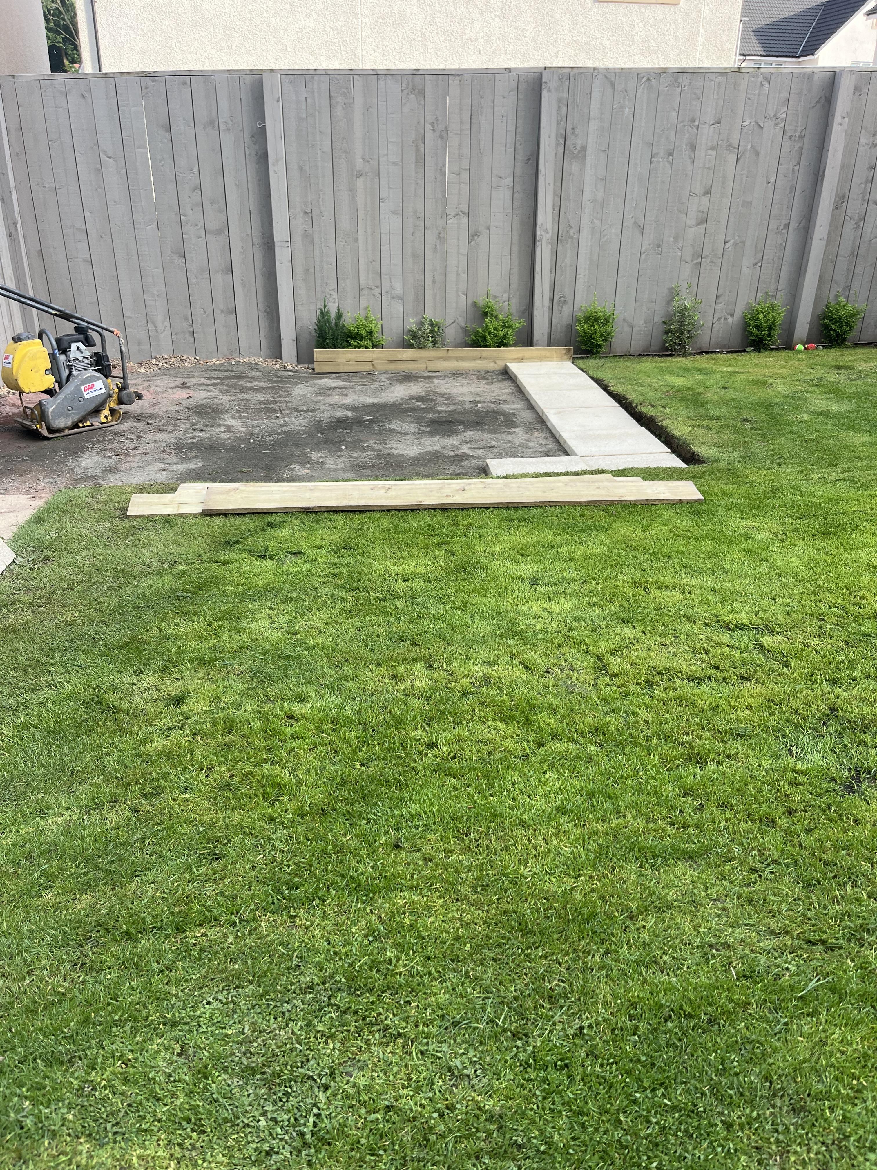

Patio at bottom of elevated garden.
Hi everyone. I’m new here and joined as it looks a great community.
Dug out grass and soil to extend a small patio. Garden is on a decline from the house and I’m not sure if I should raise the base 4 inches or keep lower and build a retaining wall. Any suggestions would be greatly appreciated. Thank you. IMG_1085.thumb.jpeg.6ee0c678d53107fc06cd52cdc479a889.jpeg
Good morning and welcome, I would be raising it slightly above the lawn, stops turf migrating onto the patio area and helps drainage
For that small height change, I would not build a retaining wall, but cut the turf back a bit a re profile it so it slopes down to the slabs without a step.
Thanks very much for those ideas! Do you think sleepers would be an idea to support the turf? I was recommended to do this but I think it’s maybe too much for the size
