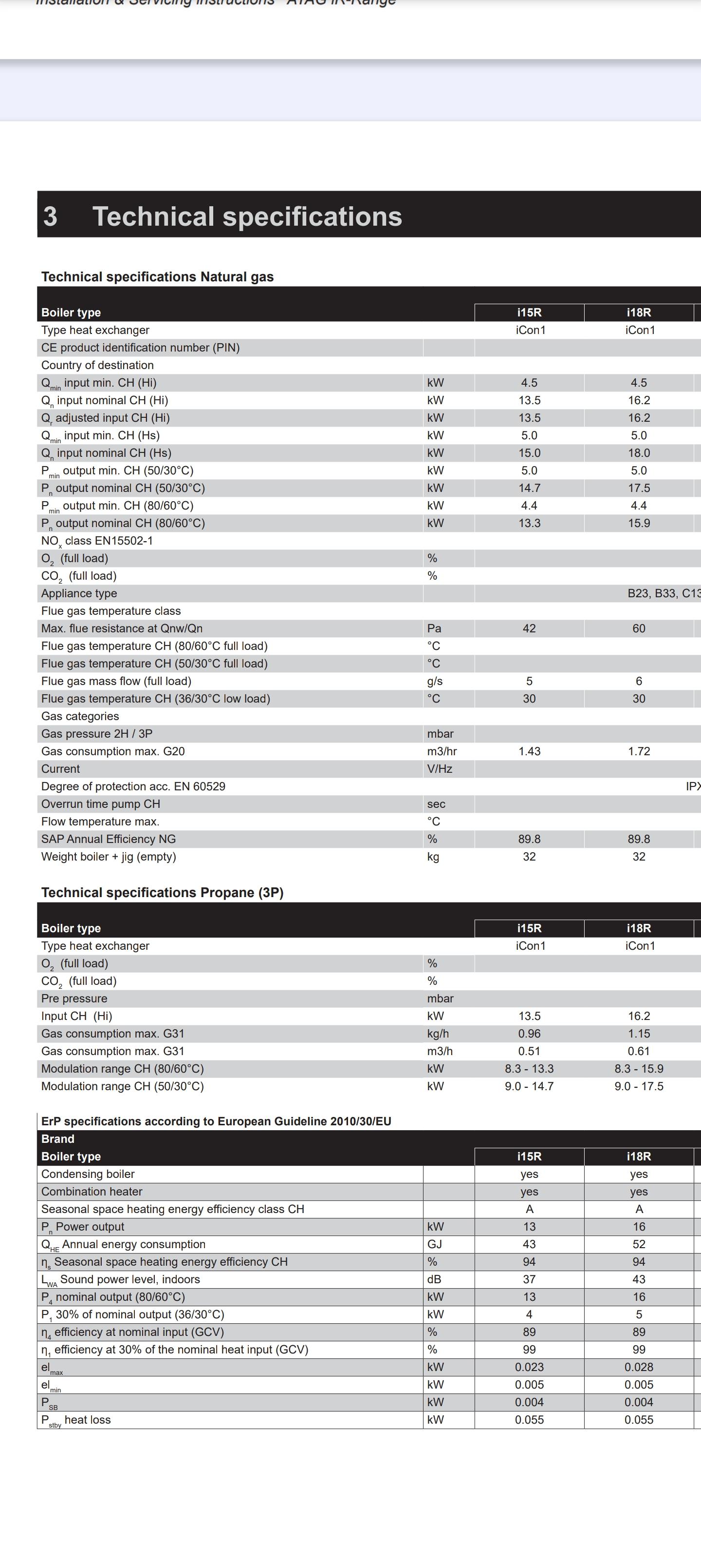

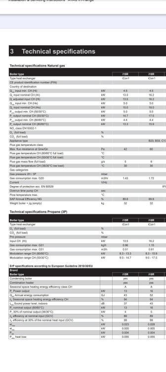

marshian Posted June 8, 2024 Share Posted June 8, 2024 4 hours ago, JohnMo said: Another boiler to chuck into the boiler options is an Atag boiler. Very difficult to find the full specs of those atag boilers especially modulation or turndown ratios Link to comment Share on other sites More sharing options...
JohnMo Posted June 8, 2024 Share Posted June 8, 2024 51 minutes ago, marshian said: Very difficult to find the full specs of those atag boilers especially modulation or turndown ratios Page 8 of the install instructions Turn down is not quite as good as the Viessmann. But having used an Atag, they are super quiet and work well. The way to keep any heat source happy is enough engaged water capacity, you need about 50L to support 6kW so it doesn't short cycle. Link to comment Share on other sites More sharing options...
