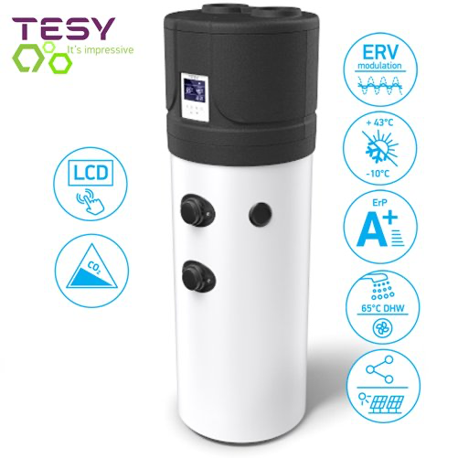

AlexMc Posted May 19, 2024 Share Posted May 19, 2024 I was thinking about installing anASHP water heater like https://www.modernheat.co.uk/product/2484/ for all my hot water needs, and a mono block ASHP strictly for heating. I know it’s more expensive, but I suspect I will get better performance since my new build will be a highly insulated envelope and hopefully won’t need much, if any, heating for most of the year. Has anyone ever done this? Is it a good idea? I’d appreciate your comments and don’t mind being told it’s a bad idea (as long as you keep it respectful and tell me why). Thanks. Link to comment Share on other sites More sharing options...

JohnMo Posted May 19, 2024 Share Posted May 19, 2024 I did toy with the idea also, but the maths makes little sense. They are a £1000 more than a direct immersion one - that's a lot of electricity. Plus you have a decent ASHP sitting ideal that can do the DHW easy enough on just as good CoP. Some are coated steel with anodes to change so be careful, the Edel units are stainless. Link to comment Share on other sites More sharing options...
