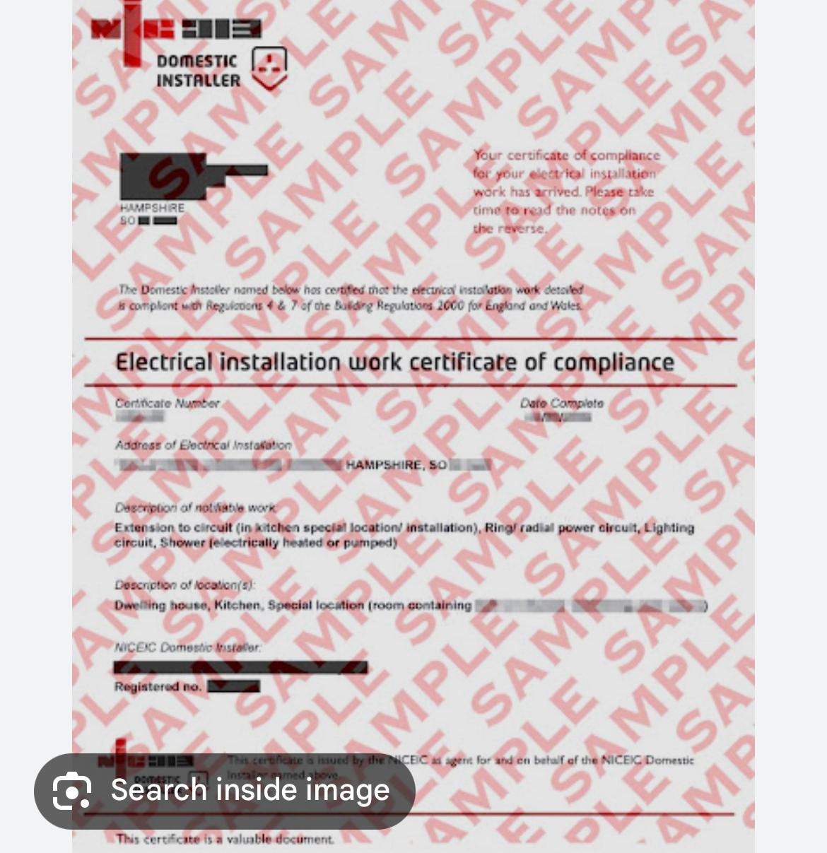

Are you sure about the building control approval? Using a part P spark dispenses with the need for the householder(Octopus customer) to get involved with BC, so why would Octopus ask for BC approval in respect of electrical works? The part P spark issues the installation cert so no BC involvement for the customer.
As you're adding load to the roof you'd need BC approval for that, or an exemption process similar to using a part P spark. I beleive the MCS process involves structural assessment of the roof and negates the need for BC approval. If you go the non MCS route, who verifies the adequacy of the roof if its not BC approval??
It's what I've read in 2 or 3 places from people claiming to have signed up via this route. The electrical installation cert is a seperate piece of paper to the part p building control notification, Octopus want both.

Anyone can complete and sign an Electrical Installation Certificate as per the sample ones in BS7671. You may get building control accept this.
However, you can only get a electrical certificate of compliance (part p) if you are registered with the likes of napit or niceic for self certification, or if you get someone who is to 3rd party sign you off, or if you pay LABC something like £600 to send someone out to inspect. Sample of this is below, which is what octopus apparently need, along with the BS7671 Electrical Installation Certificate and DNO approval.
Edited by Mattg4321
Nothing like that in Devon
I have used the same application to install a battery storage system, they were then willing to amend it to include an EV charging point and a second time to add a heat pump. So good value for my £215!
