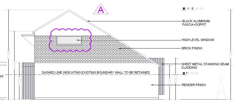

mike2016 Posted May 7, 2024 Posted May 7, 2024 I've some brick in the middle of a rendered section of the gable wall - I need advice on the correct bead to use above and below the brick. Thanks!
DannyT Posted May 7, 2024 Posted May 7, 2024 Does the brick project from the block work by the thickness of the render? Depending on render thickness, I normally step the brick work over 10mm so the render will finish against brickwork edge without need for beading.
mike2016 Posted May 7, 2024 Author Posted May 7, 2024 Am aiming for 15mm render, would that approach still work? Thanks
DannyT Posted May 8, 2024 Posted May 8, 2024 If you have not built anything yet then yes. Get your bricklayers to overhang the brick panel 15mm from the block work. if you don’t then the brickwork will look like it’s stepping back from render when it’s finished and I’m sure that’s not the look your going for. 1
