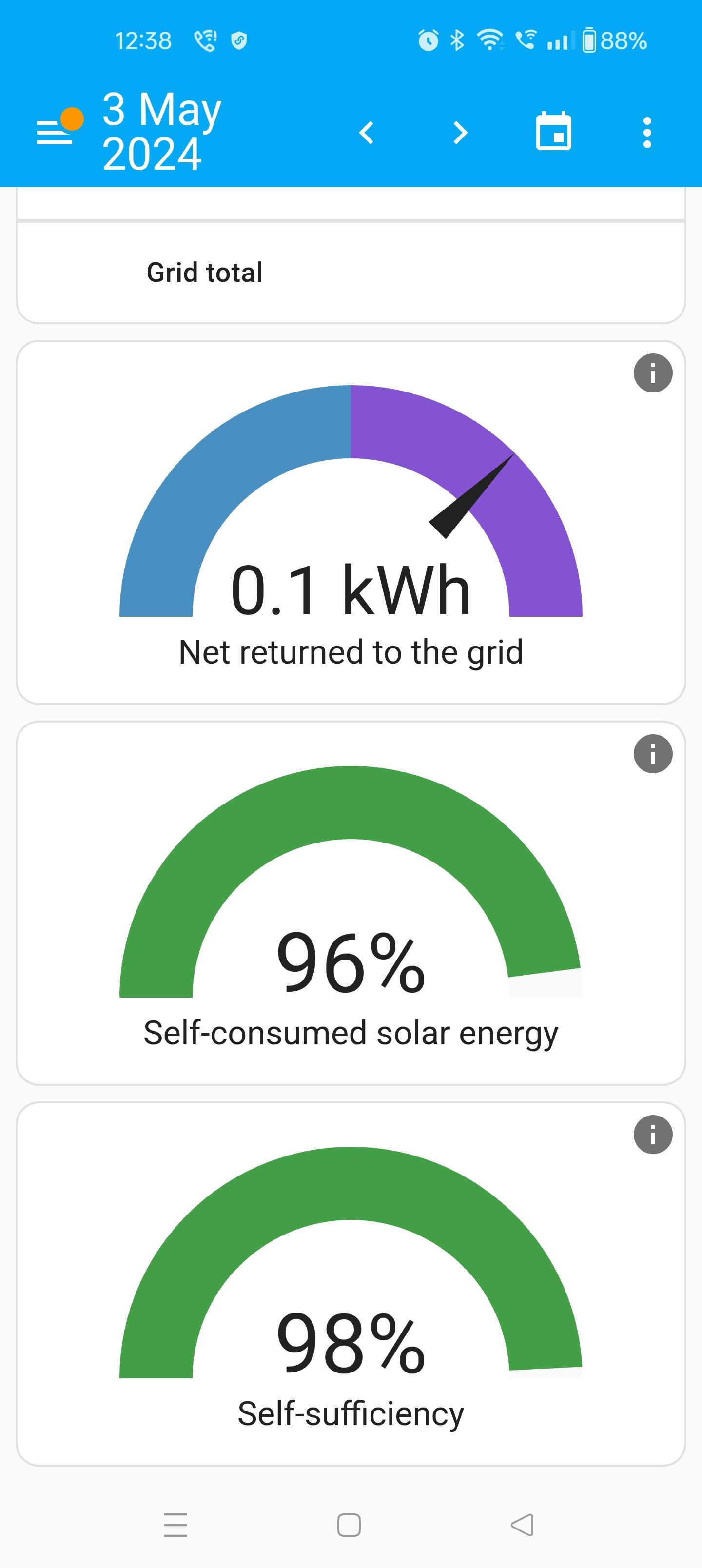

First day with no imported energy. Good solar day yesterday and battery starting to earn it space in the home.
So no battery charging required overnight, the battery ran down to 54% before PV started to charge this morning.
Snap shot from home assistant Energy page, showing current status

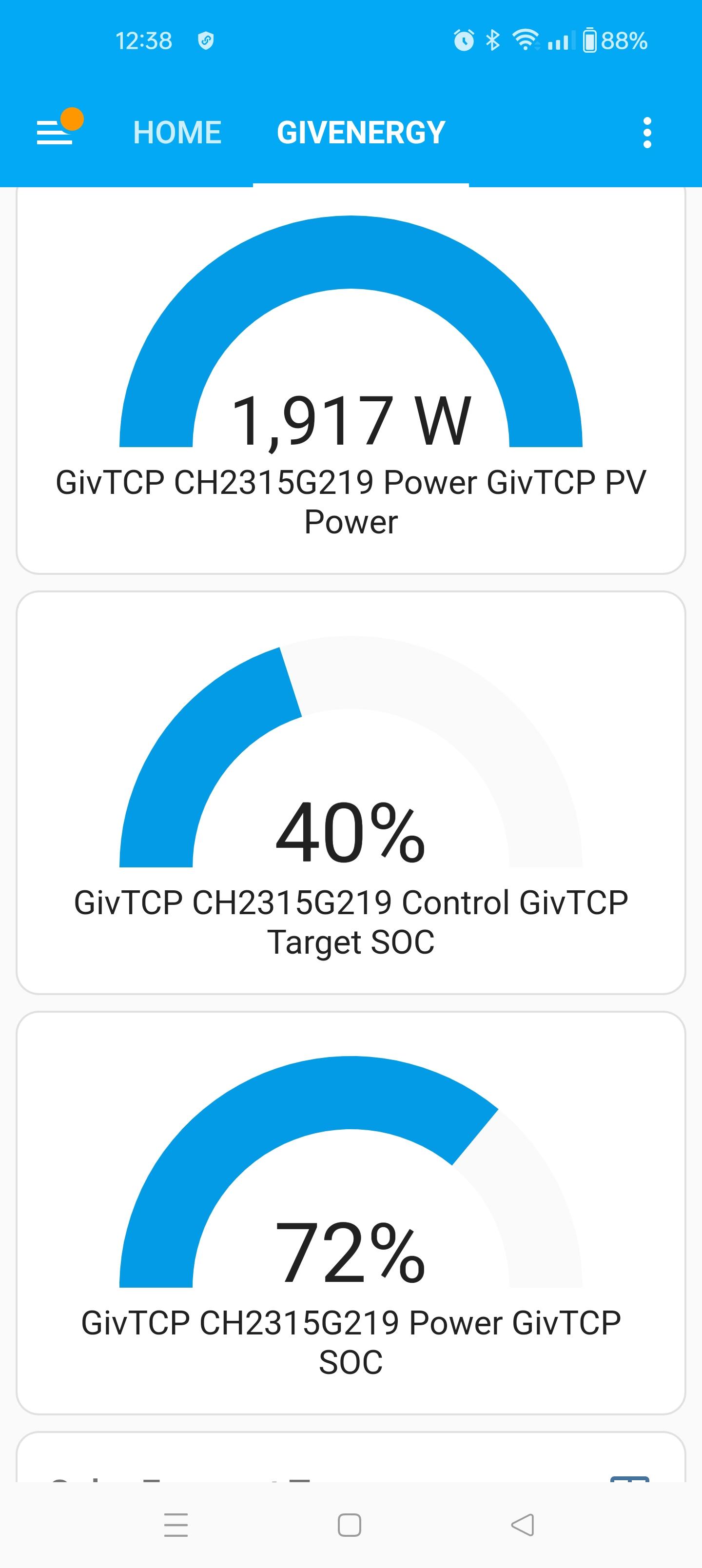

A further shot from the GivEnergy page in home assistant, shows current generation (cloudy), target charge point (overnight on E7) and current battery charge status.

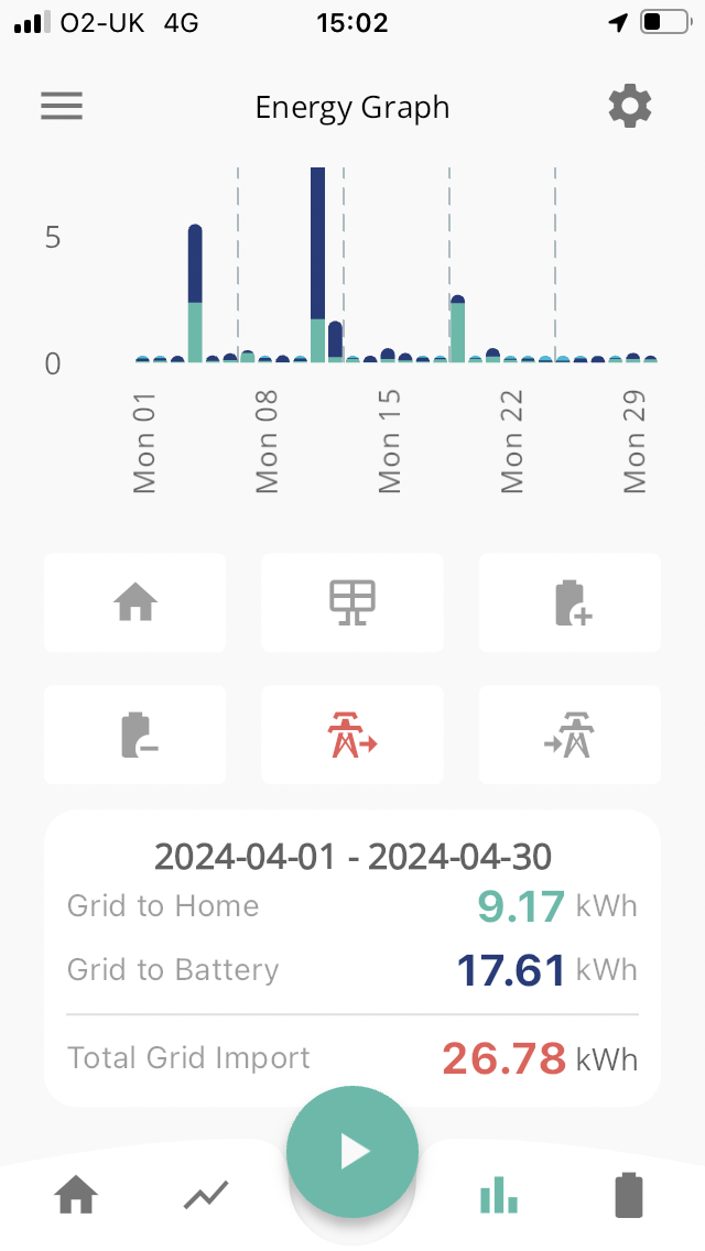

We imported just under 27kWh in April the solar and battery combo sorted the rest.
It seems like a good chunk of that import was the constant too-fro of energy between the grid and the battery.
That's good, we have had so much rain in April the solar has been pretty rubbish. Plus the heating stayed on a lot longer this year.
I was a looking forward to importing nothing in May but we’re off to a bad start just under 25kWh already, the sun has bid farewell for a few days.
