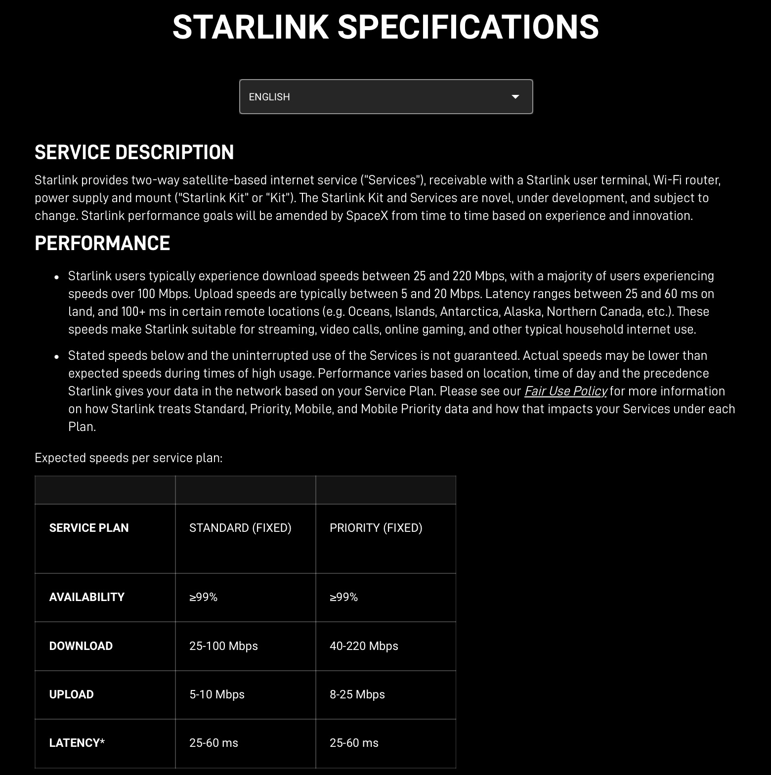

NailBiter Posted May 2, 2024 Posted May 2, 2024 (edited) Hello all, Quote 2.18 As the requirements are technologically neutral, alternative technologies (such as fixed wireless or satellite technologies) should be considered where performance requirements can be met, before consideration is given to installing a slower form of connection. My understanding is that if a BT FTTC connection (which is the only fixed connection available) is slower than Starlink then it would be acceptable to install Starlink instead. We also intend on running ducts and pull cords to BT's specifications anyway for eventual fibre rollout. Does that seem correct or have I missed something major? I've forwarded this opinion to our Building Control team so I will update this. Cheers Edited May 2, 2024 by NailBiter
AppleDown Posted May 2, 2024 Posted May 2, 2024 11 minutes ago, NailBiter said: Hello all, My understanding is that if a BT FTTC connection (which is the only fixed connection available) is slower than Starlink then it would be acceptable to install Starlink instead. We also intend on running ducts and pull cords to BT's specifications anyway for eventual fibre rollout. Does that seem correct or have I missed something major? I've forwarded this opinion to our Building Control team so I will update this. Cheers Someone more knowledgeable will be along soon, but I believe it's based on a cost cap of £2,000 for fibre connection? So if it'll cost more than £2,000 to install, you can go for the next speed/connection down from that. 1
NailBiter Posted May 2, 2024 Author Posted May 2, 2024 (edited) Thanks much appreciated. I guess my question is whether Starlink is considered the next speed down from fibre or whether copper FTTC would be. Our downstream handback rate would be 40mbps on BT and would require 100 metres of trenching however Starlink is: To be fair of course we will have to trench for fibre anyway so that's not really a cost unique to FTTC. Edited May 2, 2024 by NailBiter

NailBiter Posted May 2, 2024 Author Posted May 2, 2024 (edited) Ok so I filled out the "Appendix B: Model form connectivity plan" from https://assets.publishing.service.gov.uk/government/uploads/system/uploads/attachment_data/file/1119957/ADR1.pdf On it we put: 1. Location of proposed ducts to carry future fibre and entry point into dwelling. 2. Likely location of street pot on property boundary for future fibre provider. 3. Evidence that BT do not currently supply FTTP. 4. Communication with two fibre providers that cover the area but not our property stating they can't serve us. 5. Screenshot from BT Wholesale checker showing our neighbours BT line and the downstream handback threshold being less than 40mbps. 6. Screenshot from Starlink stating capabilities of the system exceed capabilities of the BT FTTC offering. 7. Screenshot of the active Starlink account. 8. Screenshots from other major suppliers (Virgin Media, City Fibre) postcode checker pages. 9. Noted that the property is also served by 5G. I think that covers everything off so will wait to see what they say. Edited May 2, 2024 by NailBiter
NailBiter Posted May 3, 2024 Author Posted May 3, 2024 The above worked out fine and has been accepted by our building control company. If anyone needs help with it in future tag me. 2
