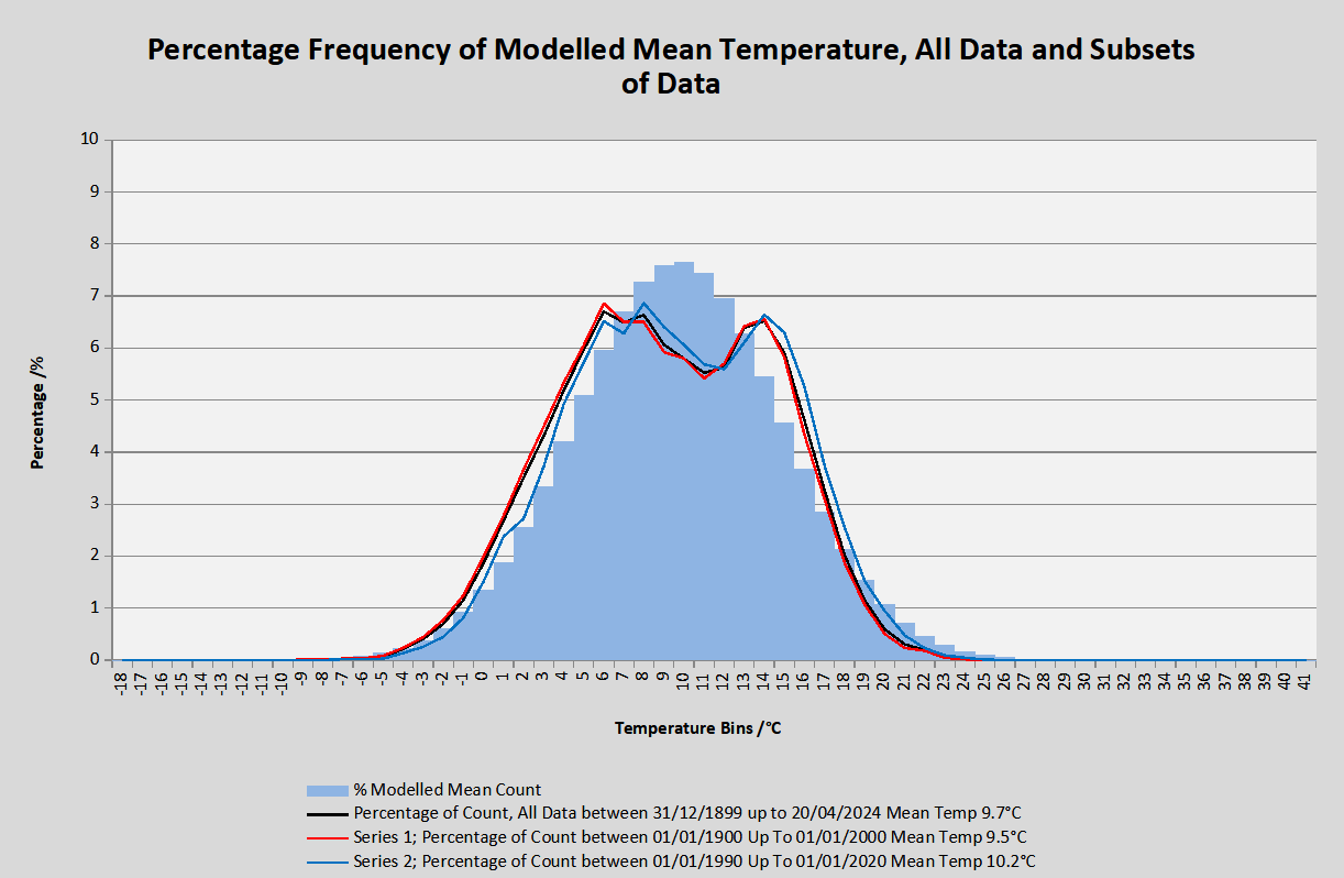

SteamyTea Posted April 26, 2024 Posted April 26, 2024 5 hours ago, JohnMo said: Our house doesn't need any heat above 10 degrees, Same with my house, maybe a bit lower. HDDs are based on a normal distribution around the the mean temperature, with the standard deviation changing for different climate zones (the kurtosis) rather than actual location specific data. As the UK has a more leptokurtic temperature distribution (flatter in the middle bit), this can skew the number of 'official' HDDs and CDDs. They are still useful for a first order approximation and when you have a system up and running are probably the best method to fine tune your weather compensation curve.

SteamyTea Posted April 26, 2024 Posted April 26, 2024 I may be used the wrong word and meant platykurtic anyway. Flat in the middle bit. If you plot the CET PDF you find that around the mean temperature the probabilities actually reduced a bit. A 'bit' is a statistical term to mean 'i can't tell you exactly'. Why the mean is really called the 'central tendency' as that gives some wiggle room on the numbers. 1
