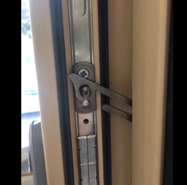

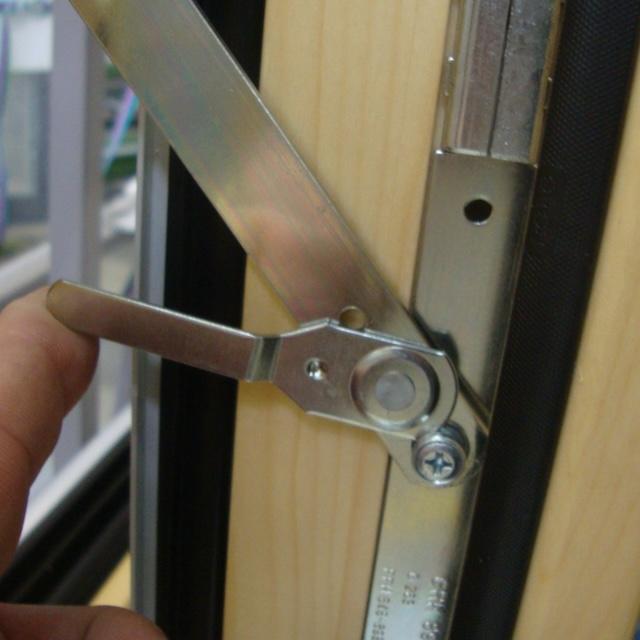

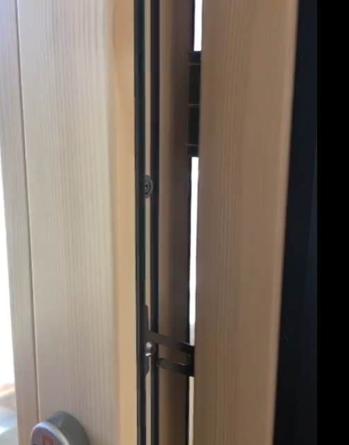

alexo Posted April 20, 2024 Author Posted April 20, 2024 13 hours ago, craig said: Yes Standard restrictors work but I can’t guarantee that the supplier will know how to fix them. They may say they don’t work but they do, they just need to understand what screw to remove on the mechanism and location. Which determines the finger restrictor position. I prefer side fixing but they can be fixed on the bottom. Thanks Craig, that looks like a good solution. I'm not sure I'm going to be able to work that out but I will see if the fitters know where it is. My fitters have offered to retrofit the Internorm child restrictor which I think is called a 'turn lock restrictor', and when the Allen key is turned it only opens on the tilt (see pics). Is it wise to retrofit these, including to windows with integrated blinds? They say they have retrofitted them before. 1
craig Posted April 20, 2024 Posted April 20, 2024 Yes they can be retrofitted, you’ll lose the key. The fixing point is using the screw that holds the mechanism to the sash, you have a couple but generally only one supplies to space for it to work due to mushroom pin/keep locations. You can only use one screw (see above pic). I tend to cut the head of a screw put it in the other screw hole and fix with gorilla glue. The actual restrictor will fix into place easy enough. This option would be the easier and most cost effective option, as you can this yourself. A couple of quid per restrictor, then your time. Check warranty scenario though. We wouldn’t have any issue with you doing this but others might. 1

craig Posted April 25, 2024 Posted April 25, 2024 They are referring to the turn lock, not a restrictor. You can have a concealed or visible turn lock supplied by Internorm, an opening restrictor as mentioned above, would be an after-market solution and unlikely to be something the supplier or Internorm supported. You can get left and right options on Amazon, they're about £5 per restrictor and something you could do yourself.

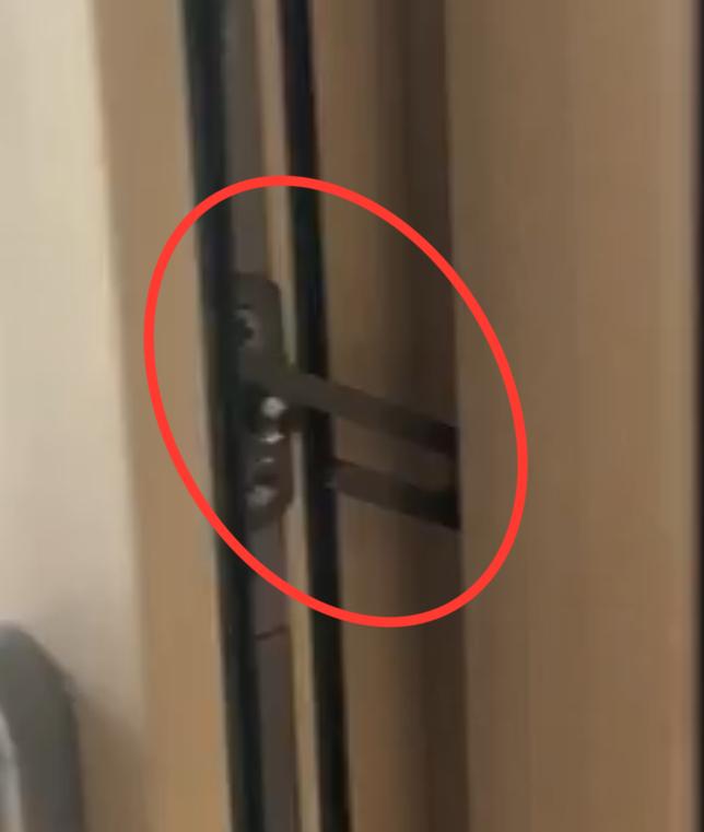

craig Posted April 25, 2024 Posted April 25, 2024 (edited) Concealed turn lock (it's not concealed but flush mounted) this is from a different supplier of course. Child finger restrictor The picture below shows the space available from the restrictor to the locking keep, you'd be able to judge easily if it fitted in place or not. Restrictor arm in the closed position. Edited April 25, 2024 by craig 1

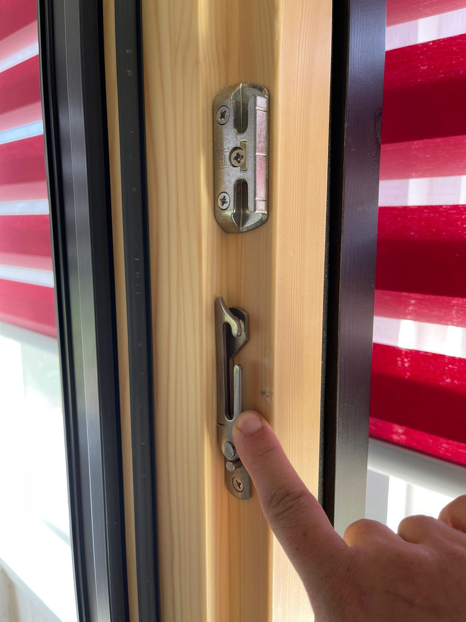

alexo Posted April 25, 2024 Author Posted April 25, 2024 17 minutes ago, craig said: They are referring to the turn lock, not a restrictor. You can have a concealed or visible turn lock supplied by Internorm, an opening restrictor as mentioned above, would be an after-market solution and unlikely to be something the supplier or Internorm supported. You can get left and right options on Amazon, they're about £5 per restrictor and something you could do yourself. This is the concealed restrictor I'm being offered. Isn't this a third party one? I'm not opposed to them fitting third party, I did request this so it could be resolved quickly. But they are telling me they are getting these ones directly from Internorm and say there will be long lead time.
craig Posted April 25, 2024 Posted April 25, 2024 (edited) Interesting, I need to look into that - not aware of that (you learn something every day), not sure how it works tbh. Edited April 25, 2024 by craig
alexo Posted April 25, 2024 Author Posted April 25, 2024 10 minutes ago, craig said: Interesting, I need to look into that - not aware of that (you learn something every day), not sure how it works tbh. Supplier has just got back to me. It is Internorm. Called a 'rebate stag guiding rail'. See image.
