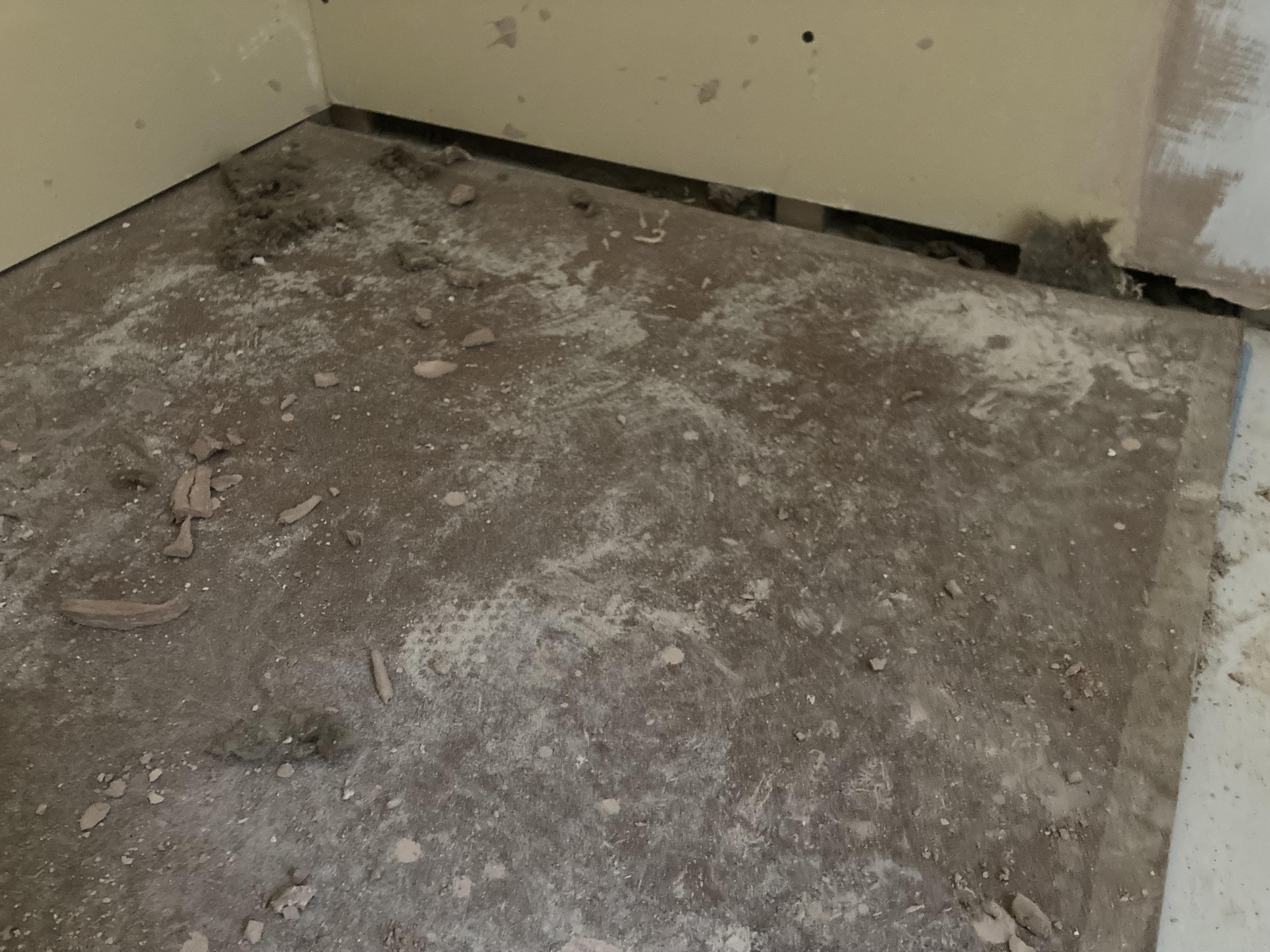

Canski Posted April 4, 2024 Posted April 4, 2024 For some unknown reason I have been left with about a 20 - 30 mm gap at the bottom between my tile backer board and shower trays. What is the best way to fill these prior to tiling ? Some are onto stud and others are on to blockwork.
Mr Punter Posted April 4, 2024 Posted April 4, 2024 I think it will need packing out. You could use the Marmox type boards which are lightweight and easy to cut. 1
