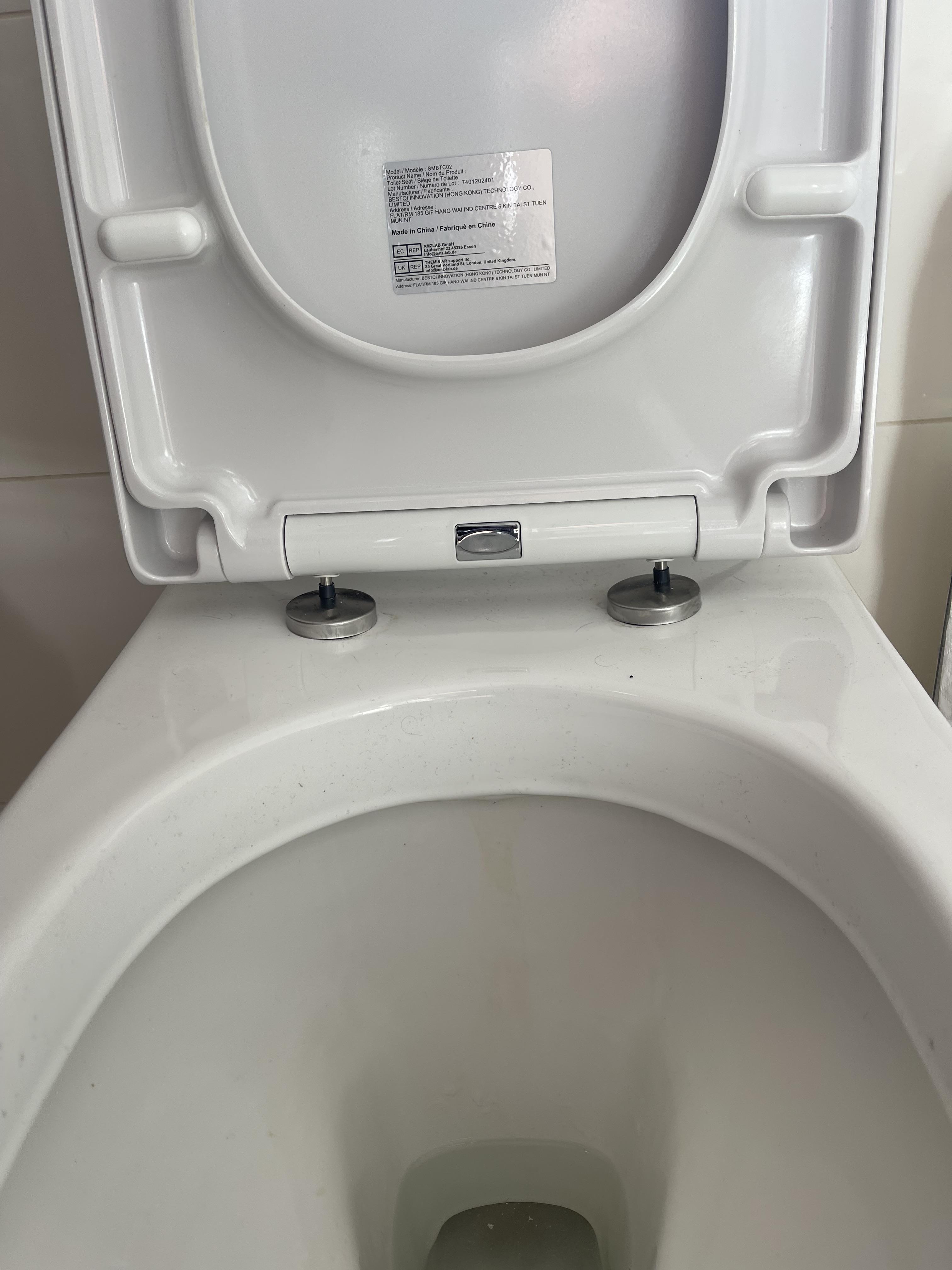

AdamD Posted April 1, 2024 Posted April 1, 2024 All lines up properly etc but when fully open it doesn’t feel like it’s locked in and comes loose easily. Any ideas?
AdamD Posted April 18, 2024 Author Posted April 18, 2024 On 01/04/2024 at 09:24, dpmiller said: push down harder until it clicks locked? Not possible, done that when I installed it. Won’t go any further. All lines up with the seat holes. I’m perplexed!
dpmiller Posted April 18, 2024 Posted April 18, 2024 yes, but do you need to use the button to release it or will it pull straight off?
AdamD Posted April 18, 2024 Author Posted April 18, 2024 8 minutes ago, dpmiller said: yes, but do you need to use the button to release it or will it pull straight off? Pulls straight off without touching the button, which obviously makes it unable when using etc as somehow it isn’t fixed in. But I’ve taken it out and properly pushed it down and clicked it a few times, but still just lifts off without the button. Maybe faulty, just seems odd and something that should be so simple
dpmiller Posted April 18, 2024 Posted April 18, 2024 it really seems like it's not going down far enough. Sometimes the little "rings" on the posts are hard to compress the first time round and can take a wipe of lubricant and quite a bit of force to get them started. Try also pressing the button in whilst pushing down. /stupid Q- you haven't fitted multiple different seats and managed to swap the fittings over?
