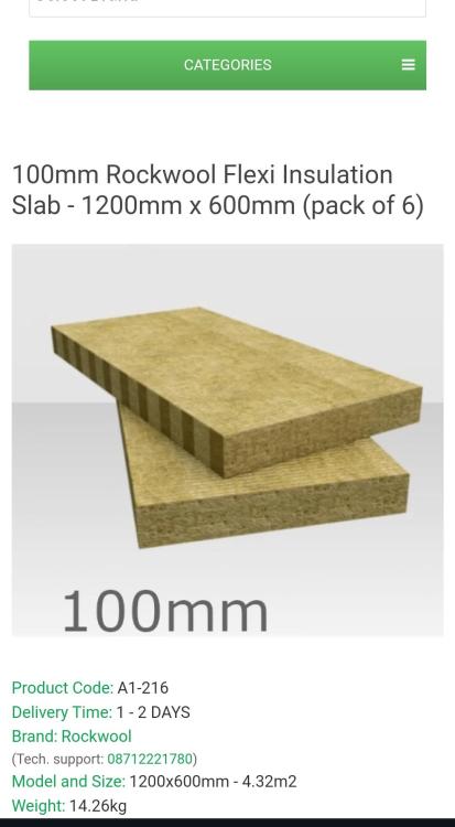

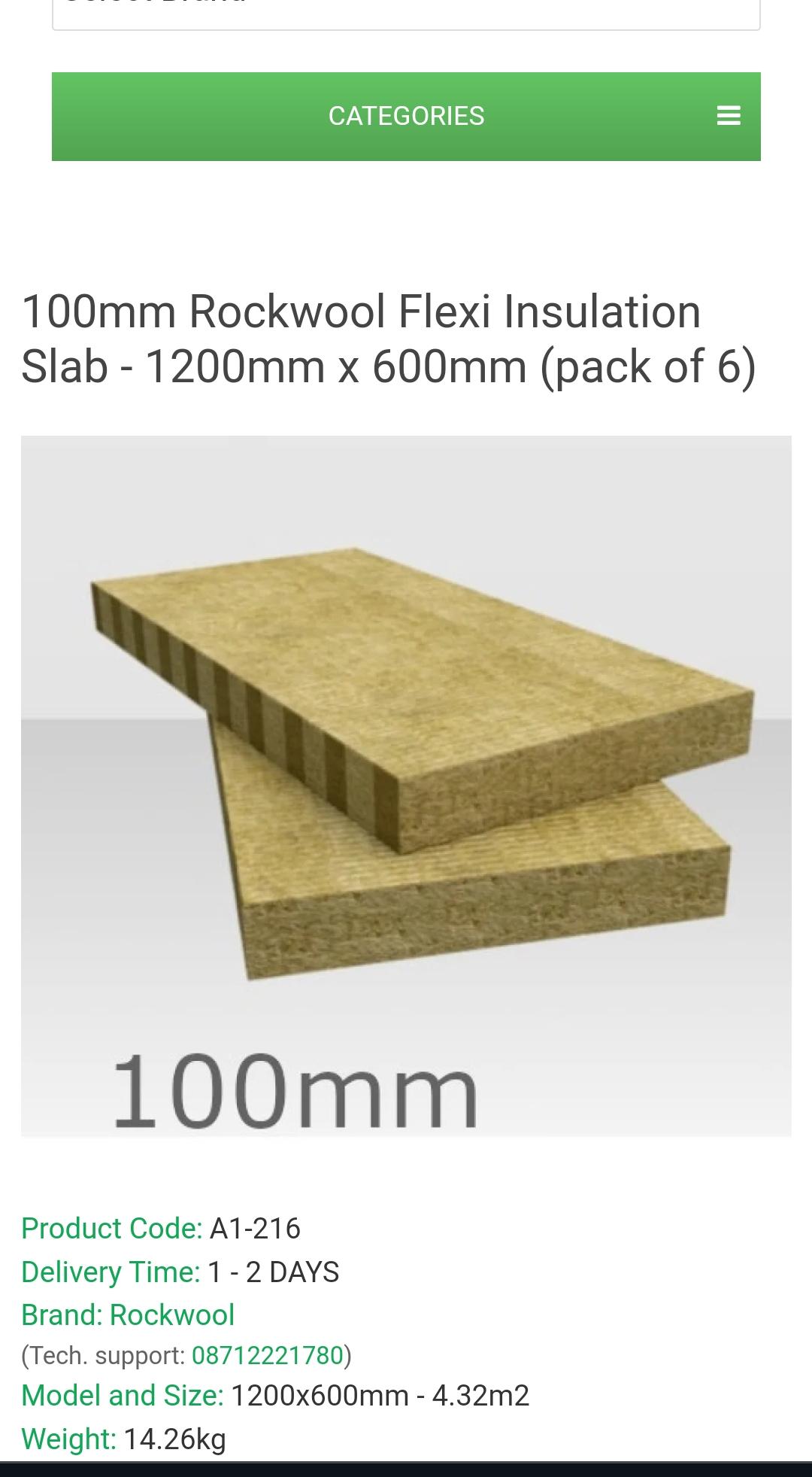

Not got the money to do the slabs that’s why I’m looking at fibreglass.
Screenshot_2024-03-20-22-57-11-744_com.android.chrome-edit.thumb.jpg.570573194fcbb9ad2ee3c8e843452508.jpg
That what I ment by slabs. That's Rockwool but you can get glasswool (fiberglass) slabs too.
