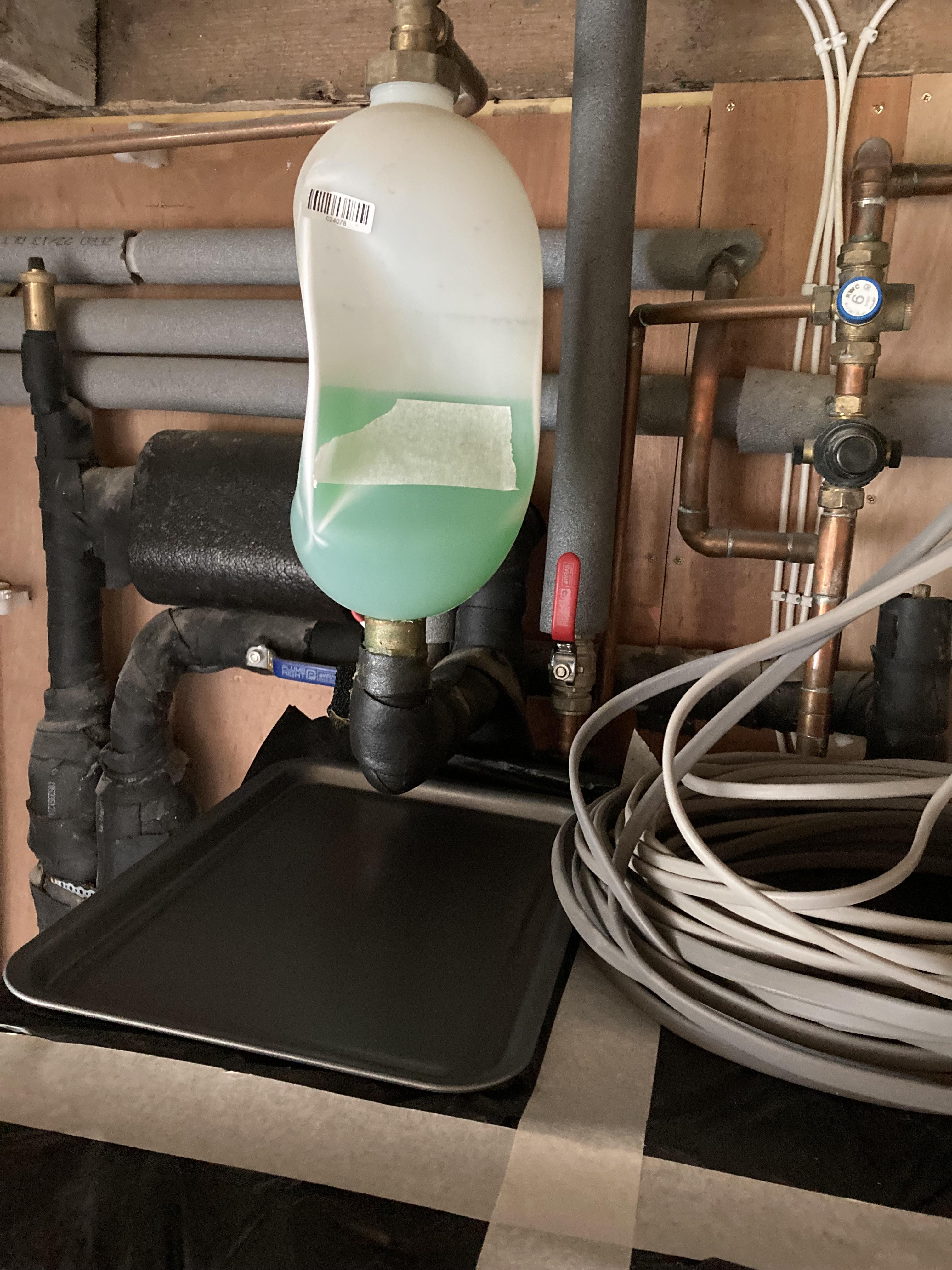

AlSmith Posted March 7, 2024 Posted March 7, 2024 Hi, it looks like I have a negative pressure on my collector system causing the brine reservoir to suck in and empty when the compressor runs. I am being advised to change to a pressurised system by NIBE specialist, has anyone else done this? And if so did it fix the problem and what size of pressure vessel did you use? Many thanks
dpmiller Posted March 7, 2024 Posted March 7, 2024 should the reservoir have a vent/ hole in the filler cap?
AlSmith Posted March 8, 2024 Author Posted March 8, 2024 This is the reservoir, it has no fill point and will contract further with no brine left in it on occasion before refillling when system is not circulating
dpmiller Posted March 8, 2024 Posted March 8, 2024 ^ what's the fitting on top of the bottle and where does the copper pipe go?
AlSmith Posted March 10, 2024 Author Posted March 10, 2024 I’m back up next week so will confirm the connections and their routes.
AlSmith Posted March 28, 2024 Author Posted March 28, 2024 Copper pipe goes to overflow bottle. Have now subsequently been advised against a pressurised system, as the deflation was initially caused by impact on the bottle (one of my tradesmen knocked it ) causing a brine leakage. Following resealing and cleaning up it doesn’t look good but is actually working as it should. Was advised the system would operate the same if converted to pressurised, adding extra maintenance and cost for no benefit. Happy to close off thread unless anyone has strong views on pressurised v not ?
dpmiller Posted March 28, 2024 Posted March 28, 2024 This is like an unsealed expansion bottle in a car then, the only other way for it to deflate is a blockage in that pipe to the "overflow" bottle.
