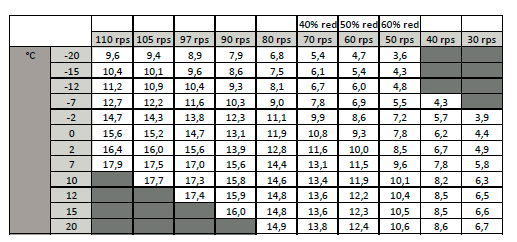

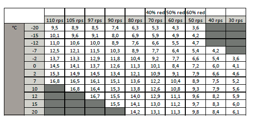

sharpener Posted March 5, 2024 Posted March 5, 2024 (edited) You don't say what emitters you have got on your wood-fired boiler system which would be useful info. My initial thought is not to try and size an HP for the full duty for the reasons you state. As @JamesPa says, if Floor 3 is indeed above Floor 2 you may find depending on the construction of the floor that is is heated from below anyway. Maybe plan to heat the core from the HP and in extreme low OAT either run the fireplace, or if necessary add an A2A HP for Floor 3 later. The problem may be in convincing an MCS installer to size it like that, bc to get the BUS grant it must be designed to heat the whole house from the HP and installed by an MCS installer. I eventually got mine to adjust their assumptions a bit, their initial quote for my 200 sq m barn conversion was for a Stiebel Eltron 15kW unit. Here is some data for the Vaillant Arotherm Plus 12kW which is what I am now planning to fit. Water temp 40 - 45C. Other tables available here. You will see the modulation ratio varies with air temp from 25 to 50%, that is pretty typical. Mitsubishi publish similar tables, but they are hard to find for low end products. Avoid Samsung, they quote a wide turn-down ratio but use hot gas bypass to achieve it which wrecks the efficiency. The Vaillant spec is quite generous and it actually puts out 12.5 kW at your -7C. As you can see from the table below it will even do 14.7kW at OAT = -2 if your emitters are sized for W = 30 - 35C. There is also a 10kW version of this HP but it is the same mechanically with the output restricted by limiting the compressor speed to 85 rps so not much cheaper and the ratio is worse. Edited March 5, 2024 by sharpener 1

sharpener Posted March 5, 2024 Posted March 5, 2024 On 05/03/2024 at 17:02, jamesdiyer said: plus hadn't accounted for DHW if needing to Expand On 05/03/2024 at 16:30, jamesdiyer said: can go up to 5 adults and 4 kids if floor 3 annex is inhabited Expand A full 200l tank of water takes about 9 kWh. For 9 people you should allow 9 x 45l so at least twice that. With a 12kW HP it would spend 1 1/2 hours in 24 heating the water which is a big dent in the heat avail for space heating. On 05/03/2024 at 16:30, jamesdiyer said: Currently got 250w immersion which would likely be kept as a backup Expand Gonna take a v long time.
