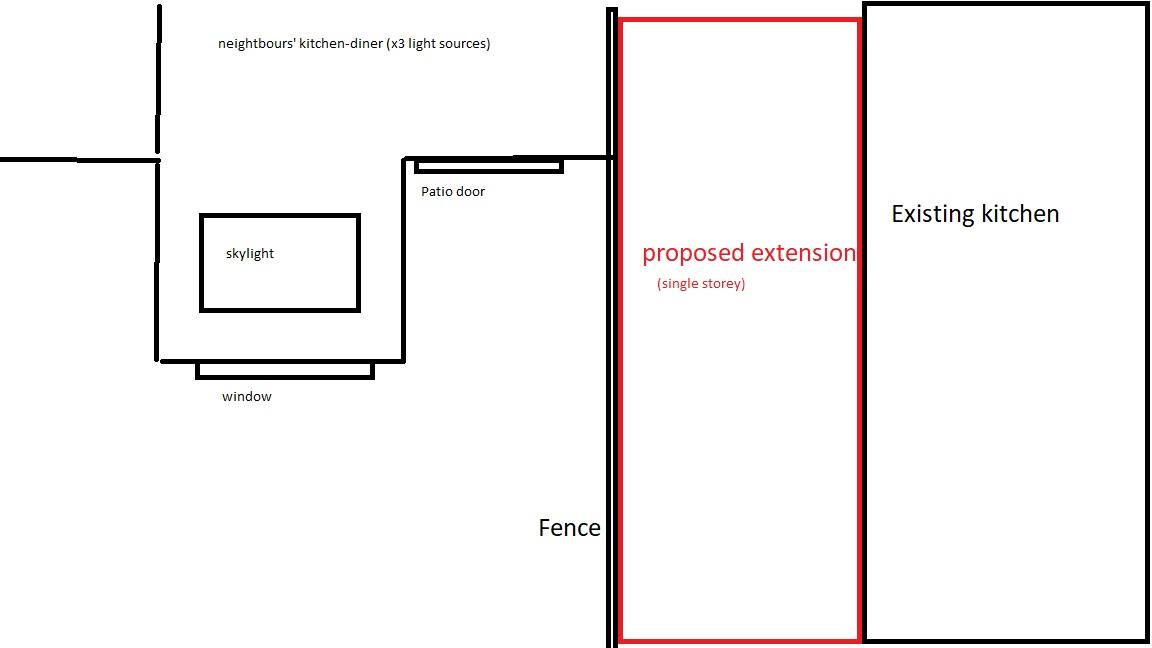

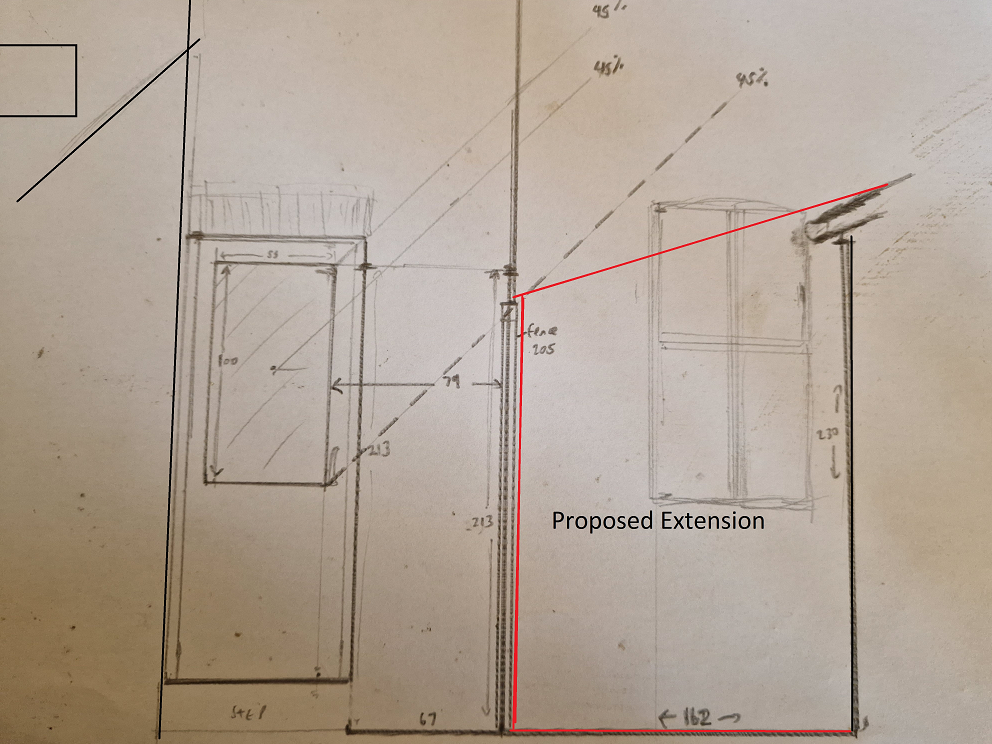

Sam odell Posted March 4, 2024 Share Posted March 4, 2024 Hi, We are planning a single storey side return in oxford, on a terraced house. We have a single storey extended kitchen already, this only widens it to include the side alley also. The issue is the neighbours have a kitchen diner beside the boundary. It has 3 windows, all north facing: a skylight on a partially extended kitchen, a regular window in the kitchen part and a side patio door onto the diner. The patio door is closest to the proposed extension, and it is perpendicular to the boundary. I am wondering if the 45 degree or 25 degree rule applies here. My architect says the 25 degree rule applies to the patio door - measured from the sill, which would render the project a no-go due to ceiling height restrictions. I can;t see any regs that agree. Surely as their kitchen has 3 light sources, and the patio door is perpendicular, it is 45 degree at most? And measured from centre of patio door? I attach diagrams. Please help! thanks Link to comment Share on other sites More sharing options...

DevilDamo Posted March 6, 2024 Share Posted March 6, 2024 Each LPA have different rules on angle lines. What does it say in relation to single storey extensions? Link to comment Share on other sites More sharing options...
